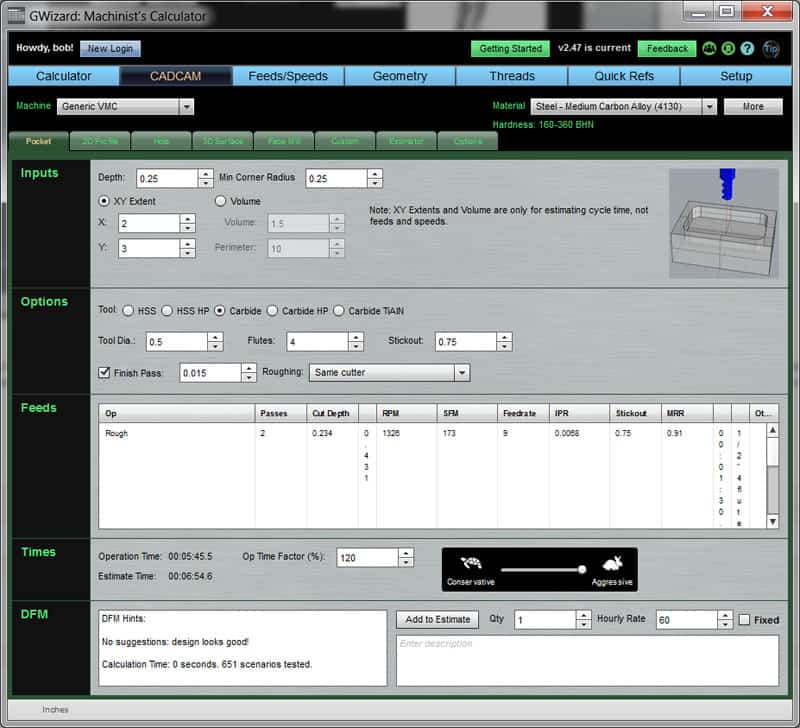

Here is the CADCAM Pocketing Wizard:
GWCCCWPocketing
CADCAM Pocketing Wizard…

For CADCAM Wizard, only 4 questions must be answered to figure out how to do the pocket:
1.  Machine
2.  Material
3.  Depth:  How deep is the pocket?
4.  Minimum Corner Radius:  What is the tightest corner in the pocket?
In exchange for answering fewer questions, you actually get quite a bit more information from CADCAM Wizard than you do from Feeds/Speeds:
1.  It will recommend what tool to use based on the type of toolpath, the toolpath’s parameters (e.g. Min Corner Radius), and so on.
2.  It will determine Cut Depth and Cut Width.
3.  It will give you a step-by-step recipe for roughing and finishing passes that includes Cut Depth, Cut Width, number of passes, feeds and speeds, and timings for each step.

At this point, it is important to note that Feeds/Speeds and CADCAM Wizards use exactly the same code to calculate the feeds and speeds, so given all the same inputs, they will return the same answer.  Think of CADCAM Wizard as being an extra employee, who is a pretty good machinist, who you delegate the operation of Feeds/Speeds to.  You tell the CADCAM Wizard some basic high level stuff.  In effect you say, “Hey Joe, I need a machining recipe for a pocket.  The pocket is 2″ by 3″ in 4130 Steel.  Figure out the best parameters for Cut Depth and Cut Width for a roughing pass, and also give me parameters for a finish pass that’s 0.015″.  I need Feeds and Speeds for all that.”
It’s not hard to imagine Joe going off with G-Wizard and figuring all that out, saving you the trouble of doing it for yourself.  Joe knows a bunch of things, what the computer people call “Expert System Rules.”  He knows you don’t cut aluminum with 4 flutes.  He knows that if G-Wizard’s Feeds/Speeds says there is a deflection problem that he doesn’t want to use those parameters.  The thing about computers, is that you can program that sort of knowledge into them, but what they really do well is work tirelessly.  This is where Joe may not be quite as good as CADCAM Wizard.  If you look at the text box on the lower left, you’ll see that CADCAM Wizard tested 651 scenarios.  That means it tried 651 different combinations of values to find the best answers.  I’d be surprised if Joe had the patience to do something like that.
Now if these were just 651 random combinations and Joe was indeed a good machinist, I think I’d still put my money on Joe to get the best answer.  But the CADCAM Wizard is a bit smarter than that.  Yes, it starts out with a random combination, but then it uses some very sophisticated algorithms to take the best combinations discovered by the initial random tests and optimize them to be much much better in as few tests as possible.  The best initial tests are in a competition to see which one can be optimized to be the overall winner.

The “winning ticket” has to respond to multiple metrics that matter in the machining world, here are a few:
–  Solution will work for the feature described.  I can’t do a 2″ x 2″ pocket with a 3″ Face mill!  In addition to choosing a tool that works, it will avoid any combinations that produce alarms from Feeds/Speeds for things like deflection or requiring too much horsepower.
–  Solution will give the best possible MRR (Material Removal Rate).  We want it to cut as quickly as possible through the material to save time.
–  Solution can trade a little bit of MRR in exchange for cuts that use more of the cutter’s flute length.  This spreads wear over more of the cutter and is good for tool life.  It won’t sacrifice too much, though.
In other words, it is trying to keep an eye out for exactly the kinds of tradeoffs any good machinist looks for.
While it’s doing all this, the CADCAM Wizard does some other things too.  For example, it packages up all the information in a format that’s compatible with CADCAM Estimator, which makes it easy for you to use it as inputs to your job quoting process.  This information is also packaged so you can hand tweak it.  Just double click any line in the Feeds grid and it’ll bring up the full Feeds/Speeds calculator so you can fine tune it to your heart’s content starting with the initial results CADCAM Estimator determines.
Those of you who worry you give up too much control versus Feeds/Speeds should see that you’ve given up very little control when you can bring the result into Feeds/Speeds and tweak it any way you like.  In fact, you have the ability to tweak all sorts of things that are labeled “Options.”  This is the part that answers the question, “How can I optimize the trade offs between the myriad strategies available to machine a feature and pick the best one?”  Are  you wondering how much of a different a High Speed Machining toolpath makes?  You can specify that under Roughing Strategy.  Do you need to tell CADCAM Wizards what Facemill or Indexable Endmill is available for the job?  That’s available under options.  You can tell it the Best Practices of your shop in terms of tooling, strategies, and capabilities.
At this point, we’ve looked at a lot of trees in both Feeds/Speeds and CADCAM Wizards.  Let’s step back and look once more at the forest:
The goal of CADCAM Wizards is to make it easier for you to get better feeds and speeds without having to work too hard.  It uses very sophisticated algorithms to test 500-600 different variable combinations.  I’m not going to say you can’t find a combination on your own that beats it, but it won’t be easy and it won’t beat it by a lot.
