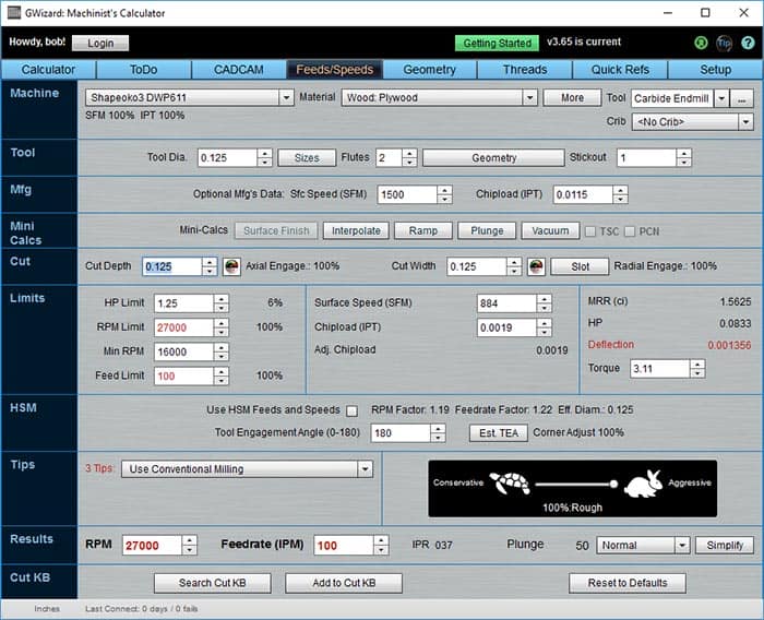

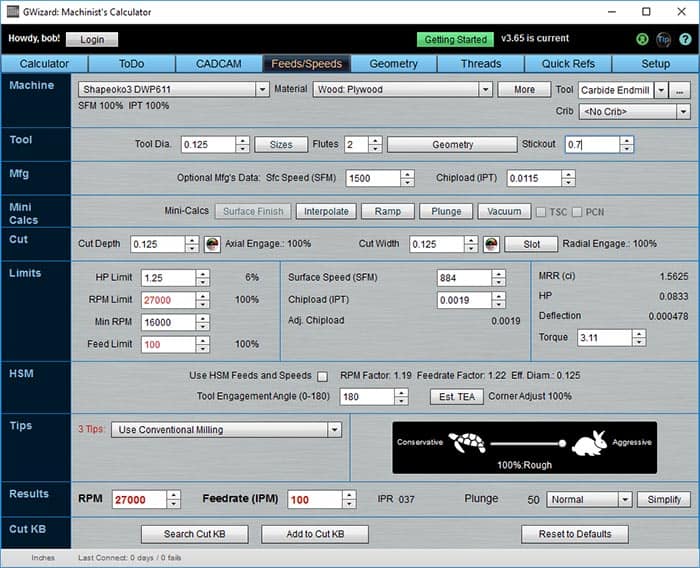

Let’s go back again to where we left off in the first example:
First example ended here…
And, let’s dial the stickout back up to 1″, instead of the 0.7″ we ended with. Deflection is once again red, and that’s bad.
But what if we have to cut through 3/4″ of material and we need that extra stickout? Are we just out of luck?
No, not at all. G-Wizard has a great tool called the Cut Optimizer that will fix you right up.
After you re-enter that 1″ of stickout, your G-Wizard should look like this:
Red means too much Deflection, which is very bad for tool life!
We can try the Tortoise Hare slider, but going to full Tortoise reduces deflection from 0.001356 to 0.000232. It’s a big help, but it isn’t enough-Deflection is still in the red. Go ahead and go back to “Full Hare” for this next part.

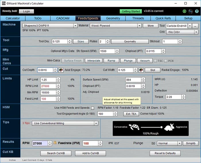

We need to reduce the Cut Depth in order to reduce cutting forces enough to make the Deflection safe. We could do it by trial and error, but G-Wizard will figure it out for you almost instantly. Just click the “Cut Depth” label and here’s what you get:
Cut Optimizer figures the maximum Cut Depth you can make and stay within Deflection limits…
Just that one click and Cut Optimizer figures the maximum Cut Depth you can make and stay within Deflection limits.
That’s pretty sweet, and you’ll find it amazingly handy as you’re working through your Feeds and Speeds problems.
By the way, if you can make a partial width cut, you can use Cut Optimizer to figure your Cut Width instead of changing Cut Depth. Just click the Cut Width label instead.
