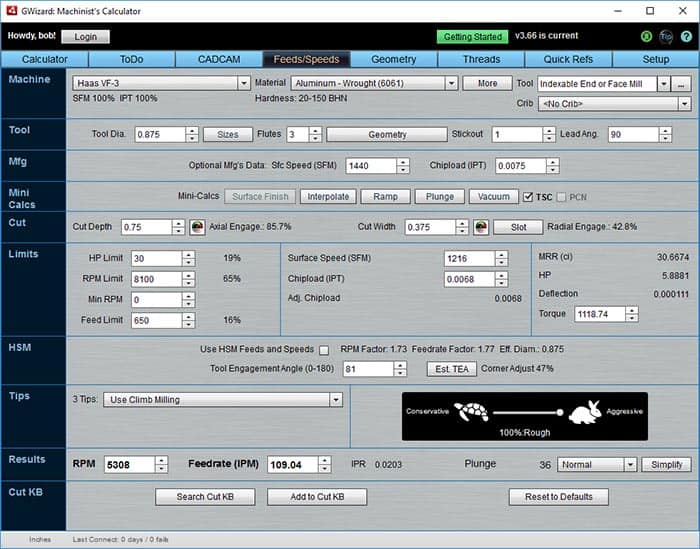

Let's say you've got a lttle 7/8" diameter Iscar Helimill with 3 APKT inserts. You want to do a little 6061 Aluminum job. Here's our starting point:
Software interface for machining and metal fabrication.
Helimill MRR is 30.7...
The Helimill's MRR is 30.7 with these basic parameters. Not too shabby!

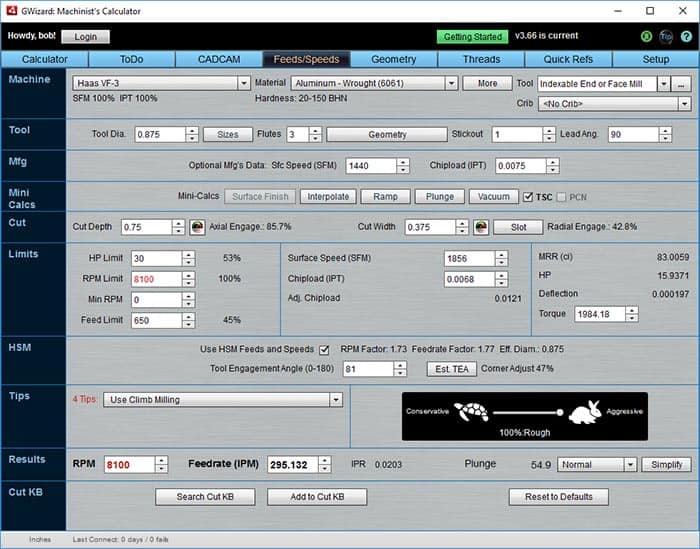

Now we want to take advantage of an HSM Toolpath. Just click the "Use HSM Feeds and Speeds" checkbox and G-Wizard will adjust the rest:
HeliMill HSM software interface
With HSM, MRR's jump to 83...
With HSM, MRR's jump to 83. Dang, now we're talking. Better keep the enclosure doors shut for this job!
But, there are some red indicators, so let's delve into them. The RPMs are red and so are the Tips.

Basically, I have taken all those lovely hints in the technical section of tooling catalogs and plugged them into G-Wizard so it can remind you of them when it sees an opportunity. In this case, it tells us we need some lubricant with aluminum (as an Experiened CNC'er, you knew that, right?), some alternate coatings to consider for your cutters, that you should use climb milling (huh?), and that the RPM's are maxed out, which is good for tool life but not for productivity.
First, about the Climb Milling. Most CNC'ers just run Climb all the time. But it isn't the best for every situation. In fact, companies like Dapra discovered a long time ago that if the Cut Width is a large enough percentage of the cutter's diameter, Climb Milling pushes the cutting edge to behave like it has more negative geometry. There's a lot more about all this on our Feeds and Speeds Course if you're curious, but why bother, let G-Wizard keep track of when to use Conventional Milling instead.

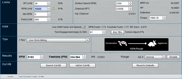

On that whole RPM's thing, personally I wonder how many more RPM's this cut could use. So, just enter a bigger value in the RPM Limit box, say 10,000 rpm. What you see is this:
Computer program screenshot showing spindle speed configuration interface with input fields and dropdown menus.
If we had a 10,000 rpm spindle, we could have an MRR of 94 instead of 93. No wonder those spindles pay for themselves so quickly on aluminum and softer material jobs!
To go back to the normal limit, just click the little padlock.
