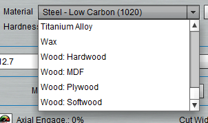

When calculating feeds and speeds for wood, we generally look at 4 different families. You can see them in our G-Wizard Feeds and Speeds Calculator Wood’s Material menu:
Feeds and Speeds Calculator Wood cutting feeds and speeds for wood
Just 4 wood types? Why not more?

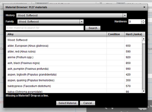

To access the full variety of woods under each family, use the “More…” button on G-Wizard.
People wonder why we don’t have a lot more categories.
The short answer answer is that there are hundreds of sub-categories corresponding to individual wood species accessible via the “More” button.  Use them if you need to fine tune for maximum performance.
But, for basic roughing work, also be aware that you can do a lot with just the main sub-categories.  This is due to the size of the “sweet spot” that relates feeds and speeds to good results in a material, together with the relative hardness of the woods (or other materials) versus the cutters (HSS or Carbide).

Tips and Techniques for CNC Wood Cutting
For Wood CNC Machine cutting applications, a good Feeds and Speeds Calculator needs the following features:
– A detailed wood database to fine tune Feeds and Speeds by wood species.
– Support for the special cnc router bits used by CNC Routers such as downcut, compression, and straight flute end mill.
– If you have a hobby-class cnc router, it isn’t as sturdy or rigid as a commercial cnc machine. Feeds and Speeds will need to be adjusted.
– Support to help you limit feeds and speeds to levels that won’t pop the parts off your vacuum table.
Our G-Wizard Calculator is the world’s first feeds and speeds calculator specifically designed for CNC Router use, and it does all that and more.
feeds and speeds for wood, Feeds and Speeds Calculator Wood
G-Wizard’s Material Database has hundreds of wood species built-in…

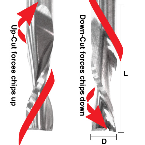

Specialize milling cutters for wood are available to help reduce the likelihood of splintering the surface of your wood (or laminated materials too):
– Upcut End Mill: This is the normal end mill style. The spiral flute carries chips up and out of the hole as it cuts. These are probably the worst about splintering, though with serious fine tuning and slower feeds and speeds you may be able to tame it a bit.
– Downcut End Mill: With downcut geometry, the spiral is reversed so it pushes down instead of pulling up. This is great for reducing splintering of the top surface, but you do want to be careful the chips can go somewhere. Cutting deep tight slots can be problematic for this type of cutter sometimes.
– Compression: A compression cutter is a combination of upcut and downcut. It has the spiral set to pull up at the bottom of the material, then it reverses direction at the top. It’s name comes because it is pushing the chips to the center of the cutter, or “comrpessing” them, in other words. Compression cutters can avoid splintering both top and bottom, so are ideal for many applications where you’re making one pass to cut all the way through the workpiece material.
– Straight Flute: Straight flutes have no twist. This reduces their likelihood of splintering, and it also makes the cutters cheaper. However, their performance is not so hot in terms of ultimate feeds and speeds.
For much more on Cutters for CNC Routers, see our specific article.

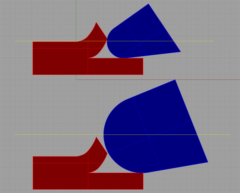

If the cutter is getting hot to the touch (careful!), and especially if there is any discoloration or the wood is being burnt, your feedrate relative to the proper feedrate is too slow, and the cutter is rubbing. For a full explanation of rubbing, see this article from our Feeds and Speeds Tutorials.
cnc wood cutting, Feeds and Speeds Calculator Wood
Geometry causes rubbing when we feed cutters too slowly. It heats everything up and will burn wood…

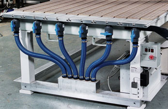

Vacuum Table Tips
Vacuum Tables are often the preferred method of workholding for cnc wood cutting, and we have a huge page chock full of great information on how to use Vacuum Tables.
Check out our Total Guide to Vacuum Tables
