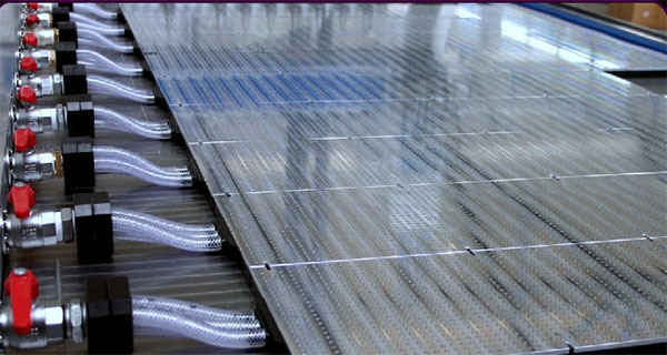

Vacuum Table with zoned sub-plenum plumbing. Image via Techno-CNC...

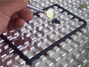

Another way force can be limited is you may not be able to apply the vacuum to the entire bottom surface of the part. Consider a vacuum system built out of aluminum with small vacuum chambers underneath. It looks something like this:
Vacuum table with small chambers...

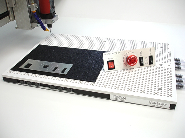

CNCStep vacuum table...

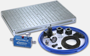

Pierson vacuum chuck system...

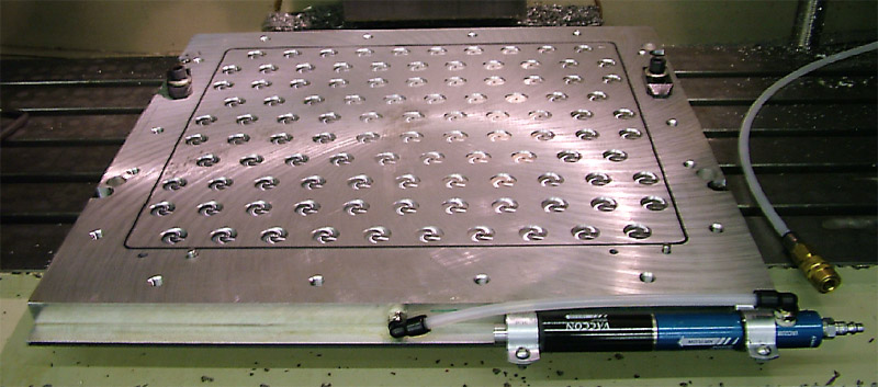

Tormach Vacuum Chuck. Tormach has a variety of vacuum workholding solutions...

Another important consideration is whether you're going to create some sort of plenum design or whether you plan to actually machine your vacuum table. Machined tables can be more accurate-flatter and more square. They're certainly more durable too. But a plenum-style table may be cheaper to build and less restrictive on vacuum passages.
There is a key trade-off to consider and that is the ability of the table to support your part versus the surface area that's available for vacuum to do its job holding down parts. If the part is resting on a surface that is not permeable to air, then only the passages that pull vacuum are exerting force. On a machined aluminum vacuum table, you only get much vacuum from the surface area of the grid and not the whole surface area the part rests on. If you try to create a cavity under the part to spread more vacuum, you run the risk of stressing the part so it is bowed in the unsupported areas if you let them get too large.
The beauty of having your top surface be something like MDF is that it is permeable, and the vacuum can access the whole surface area of the bottom of the part. However, MDF is likely a less accurate support than aluminum and it will require a vacuum source that can pull more CFM of air out because there is a much larger area that leaks vacuum.
Assuming you don't have a giant vacuum pump with unlimited CFM capacity, one facility that really helps is the ability to zone the vacuum areas so that areas that leak (perhaps because the part doesn't sit on those areas) can be shut off from vacuum. Here is a vacuum table that has a zoning system that is very convenient to change just by opening or closing some valves:

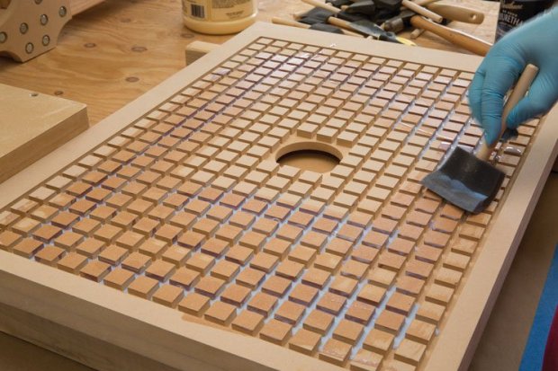

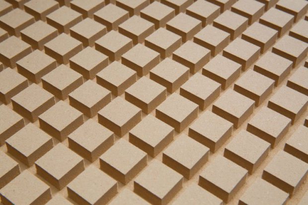

A typical MDF vacuum table has a plenum board with grooved passages and a bleeder board that allows vacuum to seep through its porous structure...
Closeup of the plenum board...
Although both the plenum board and the bleeder board are made of MDF, we don't want the plenum board to leak vacuum, so we apply wood sealer to close up the pores:
The plenum has to be sealed so it won't leak vacuum. Easy to do by applying sealer...

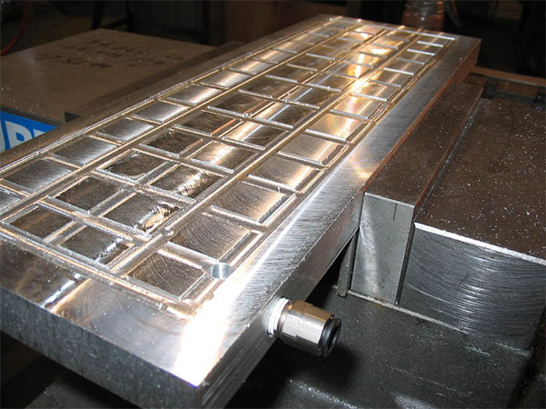

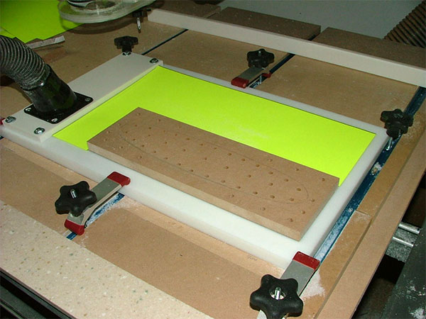

Here's a little vacuum table intended to go into a milling chuck. There's a complete build up described over on the Romax CNC forums.
Neat little vacuum table fits in your milling vise...

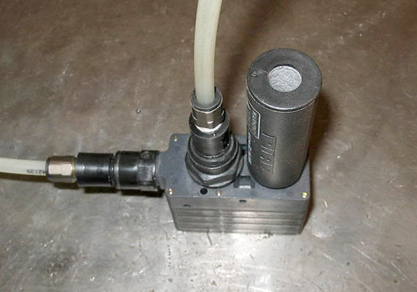

This builder likes these "PIAB" vacuum generators that are available on eBay cheaply used...
Another view of the PIAB. The long can is a silencer. These are basically just nice venturi vacuum pumps. Hard to beat the price of a used one from eBay.

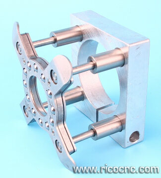

- Consider a spindle pressure foot to help add more hold-down force on the part. A pressure foot rolls along the part using ball bearings but adds spring-loaded hold-down force around the immediate cutting area. Here is one example:
Pressure foot clamps to spindle. Image via RicoCNC.com...
