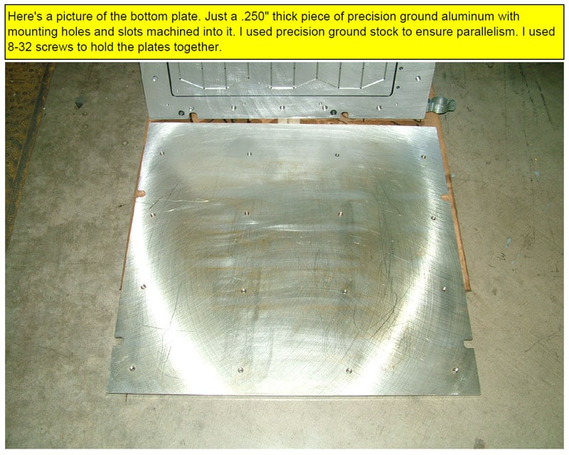

The vacuum table mounts on the VMC table with the usual T-Slot hardware.  That outside groove was done with a 1/8" ball nose end mill and is used to hold rubber cord that seals the edge.  The round vacuum ports are milled 1/16" deep and each one has a hole in the center leading to the passages behind...
Venturi vacuum pump components on metal surface.

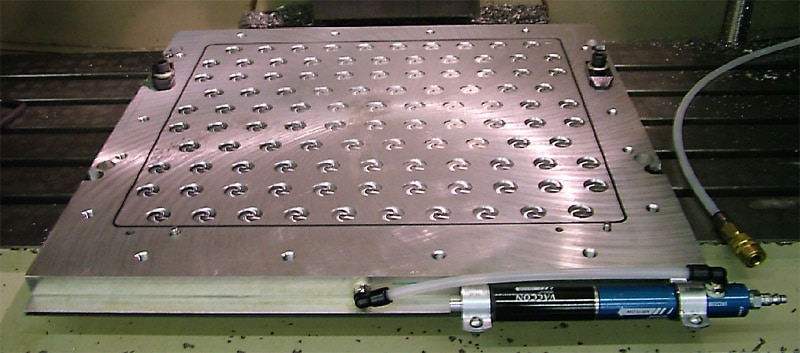

Any vacuum system needs a vacuum pump, and this one uses a venturi vaccum pump.   It takes compressed air (20 CFM) and uses a venturi to generate the vacuum.  In addition, it tries to silence the noise a bit.   Not cheap, but some of these are available on eBay.
Vacuum table fixture plate with partially completed grooves.

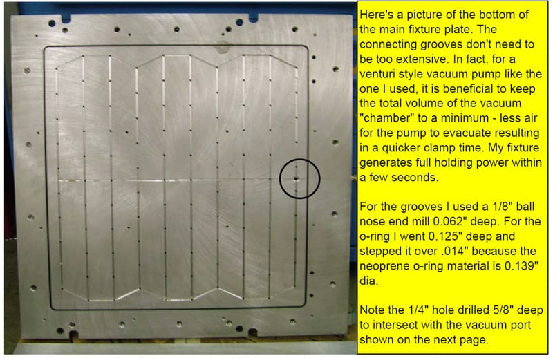

Here are the air passages on the back side of the vacuum table...
Large metal plate with brushed finish and drilled holes on a concrete floor.
The air passages are sealed with a simple plate...
Vacuum table with varied-sized circular holes.

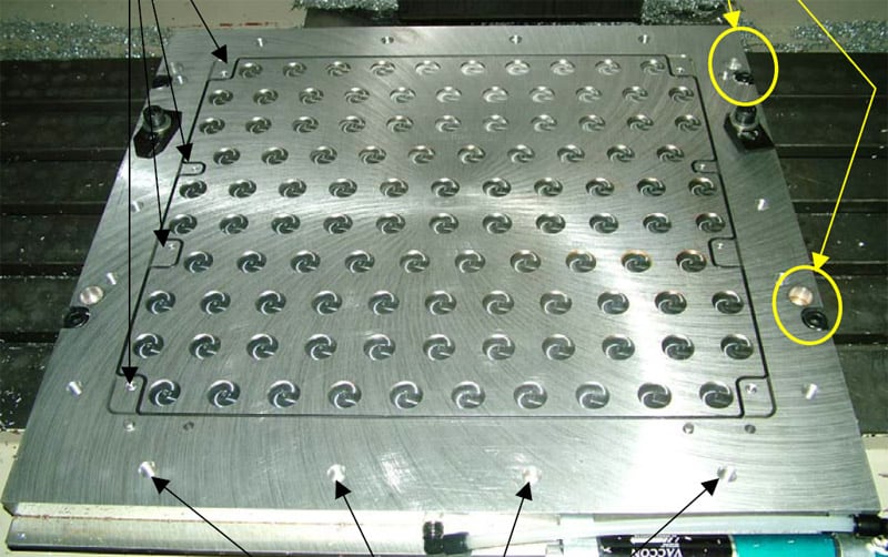

These are the changes Chris made to get to his 2nd generation vacuum table:
Fewer holes.  Originally there were holes around every edge to use additional clamps.  The clamps are needed to prevent the work from sliding sideways from milling forces.   But, he discovered the two clamps shown on the table were sufficient to prevent the sliding.  Filling the holes means one less place for liquid coolant to collect and splash back if you use an air hose to clean the chips.
He re-routed the groove for the outer gasket so there are no open bolt holes, hence it is inset around the holes.  If you don't do this, you have to tape the holes on the workpiece or you have a vacuum leak.
Two metal dowel pins in parallel holes on a metal surface, with a small backing plate.
Chris has provided some dowel pins to repeatably locate the workpiece on the vacuum table.  You'd think these would help minimize the sliding tendency as well.  Or, you could put the dowel pins along two edges and butt the workpiece up against them to locate it.

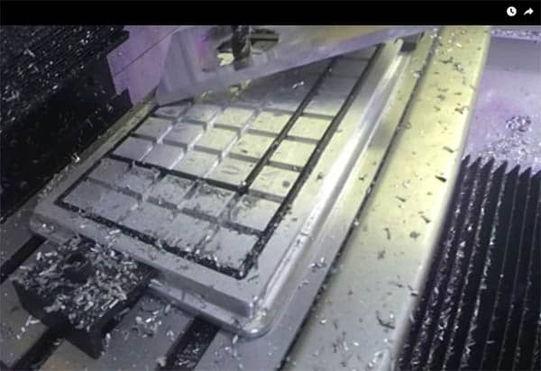

Scary Vacuum Fixture Mishap
Any workholding solution has major problems when a part breaks loose.  But vacuum chucks and fixtures can be more prone to it unless special precautions are taken.
I jumped about two feet when this plate broke loose from the vacuum fixture while the pocket floor was being machined.
Here's a still frame of the plate in mid-air:
Metal workpiece on flat surface with scattered shavings.
He had actually dialed things back quite a bit to try to keep it happy, and I would have thought the majority of the worst cutting forces were done, but the part still broke loose.  Nobody harmed, fortunately, but the part was scrapped.
That cutter grabbed the part, lifted it off the table, and had it spinning fast not long after.  In this case, the part was light enough and the cutter large enough diameter, it all held together long enough to hit the E-Stop.
A heavier part might have broken the cutter right away and gone sailing off into the enclosure.  A super heavy part might've sat there without spinning at all and just shifted a bit.
It's always scary when a part gets loose from the workholding (especially big parts on CNC Lathes-oy vey!).  Enclosures and definitely eye protection are important.
