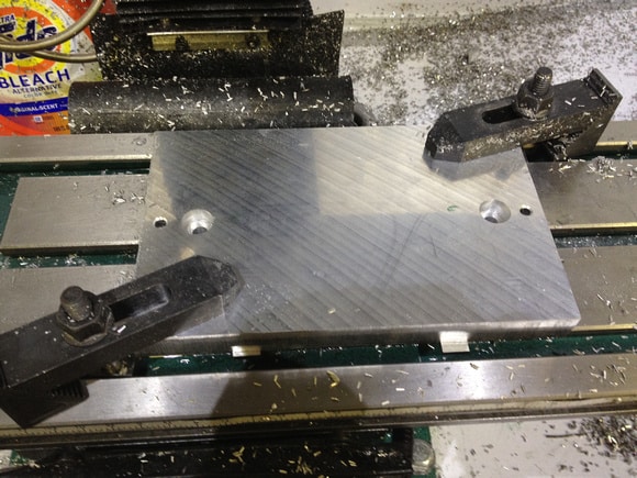

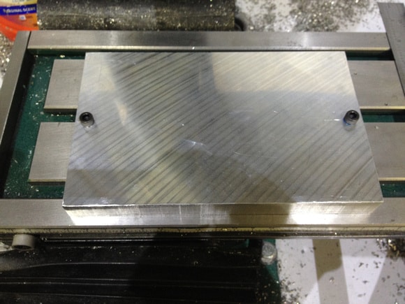

I ran across a great suggestion for making keyed fixtures by Ray Livingston over on the CNCZone. Many of you will be familiar with the idea of keying a vise, where a key is installed on the vise base so you can place it on the table in the same way each time and it’ll be trammed and ready to go. This is a suggestion for doing super simple keying of arbitrary plate fixtures for milling.
Ray makes his fixtures on aluminum plate and just installs a couple of socket head cap screws on the underside to act as keys that locate the fixture against the table’s T-slot. Nothing about the bolts needs to be accurate because the emphasis is on repeatability. Even there, the fixture makes use of a probe or edgefinder to locate its precise position.
Let’s walk through an example where Michael Hackney uses this approach to create a fixture for manufacturing his custom fly fishing reels:
First step is to drill and tap for the SHCS locator “keys”…

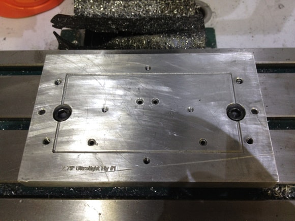

Flip the plate, align the keys to the T-slot, and it is time to drill and countersink so we can use 2 more SHCS bolts and T-nuts to hold the fixture down…

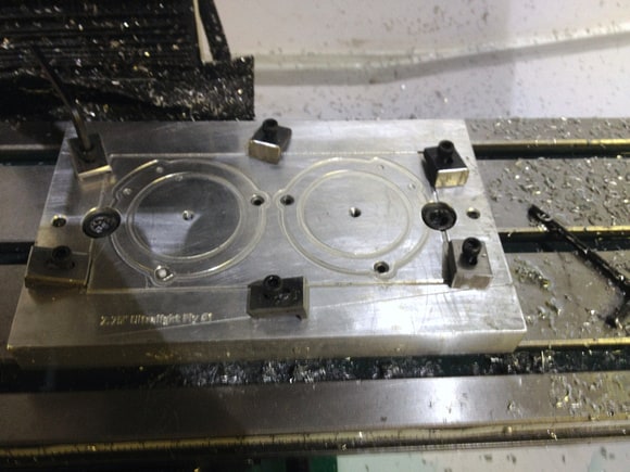

Here’s the finished fixture in position and ready for use…

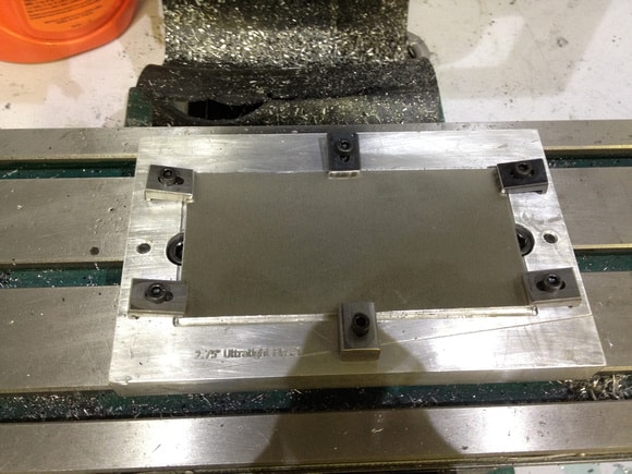

Got a plate of the raw material clamped down…

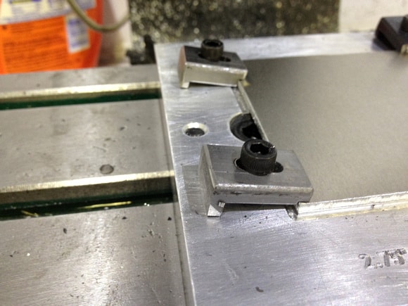

Michael uses these little fabricated clamps to hold the material, but there are many different ways you could go about holding it…
Work in progress…

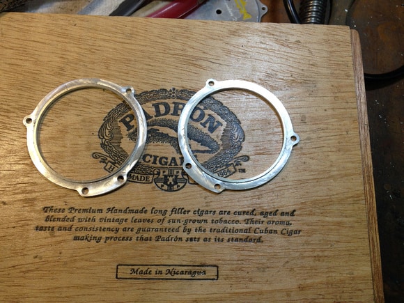

Finished parts…
One more important detail: as soon as the keys are in place and the fixture plate is flipped, a finish pass is made along the left and bottom edges. Those edges can now be probed or located with an edgefinder to identify part zero–the lower left corner of the fixture. With a probe and the right programming, this can be done very quickly and automatically. You could even choose to use the two edges to remove any twist because the T-slots aren’t exactly aligned with the axes. Just measure how far out they are from horizontal and vertical and do a coordinate rotation on the program before running.
What’s neat about the idea is it is super simple to do and results in fixtures that can be put into action on the machine very quickly. Michael reports he’s made a couple hundred parts with his and will shortly deployed a much larger fixtures that handles parts 12-up instead of 2-up.
Bob, this was a pleasant surprise! I have to say I am very pleased with the reproducibility and accuracy of this technique. Since the fixture is indicated in before each session, I am confident my parts will be good. For most of my parts, a high level of precision/accuracy is not required since the parts are machined in a single series of operations. But, I have one part that needs to be machined on both sides. This is where this sort of locatable fixture shines. I can confidently flip and locate the part (using .125 dowel pins on this fixture) to machine the frontside. Fly fishing reels require a reasonable amount of precision and being able to make these parts on my G0704 saves me a lot of time.
My next version will have a dedicated fixture for the front-side (flipped) operation. I’ll eliminate the dowel pins (they are a bit time consuming) by milling islands to locate the pockets milled on the back side. This will save a lot of time and allow me to mill pockets into a batch of stock first (no tool changes needed so I can fly through that) and then use the 2nd fixture with the islands to finish the frontside operations.
I thought seriously about pinning my table and using traditional round and diamond pins to locate. Then Ray mentioned this idea so I tried it since it was very quick to do. I have complete flexibility on where to position the fixtures on my table and for small fixtures like this I can even place 2 or 3 on the table at once.

When it comes to those step clamps, the back leg is far too long, the ideal is just a tad higher than the workpiece. I have used longer flat straps for years, ythe rear end being a hex capscrew with a locknut on the top side, just set for length and nip the lock nut .
