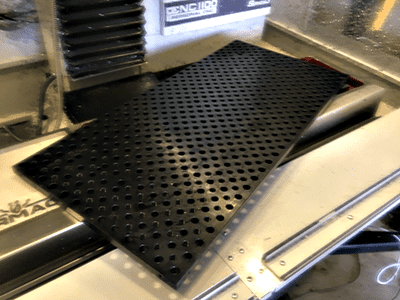

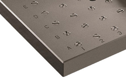

Pictured above is a typical Fixture Plate. Some things to note about it:
  • There’s a grid of threaded holes there.  They’re protected from chips by set screws that you remove when you’re ready to use a particular hole.
  • Engraved letters and numbers create a coordinate system to uniquely identify each hole.

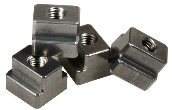

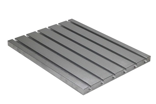

Install a Fixture plate on your CNC Mill’s table.  Most CNC mills have T-Slot tables like this one:
Secure Workholding devices such as fixtures and vises to the machine’s table using bolts and T-Slot nuts:
The nuts slide along the T-Slot until positioned where you want them.

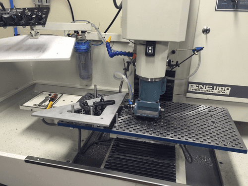

Let’s go a little more in-depth with a particular feature plate.  I received a plate from Dan Bye of Tosa Tool for review purposes and installed it on my Tormach PCNC 1100 CNC Mill.  Yes, journalists get free product a lot of time, but I’ll tell you the straight 411 about a product anyway.  My CNCCookbook business is far more important to me than any review, so I’m not afraid to be critical if need be.
Tosa Tool specializes in modular fixturing solutions. Fixture plates are literally the foundation for modular fixturing.  The plate I received was their model TT1634C but with some minor blemishes not affecting its function.  I got mine free, but the normal cost for the exact same plate is $1100.  It measures 34″ x 16″ x 3/4″ thick, and is larger than the Tormach’s table.
It still fits fine in the PCNC 1100 enclosure.  Plus, the larger size means there is room for fixture related stuff to sit outside the work envelope.  That can be important when trying to use the full envelope:
fixture plate tooling plate module fixture
Note that some of the stand-offs for this right angle drilling rig are off the table.  Handy to have a larger fixture plate!

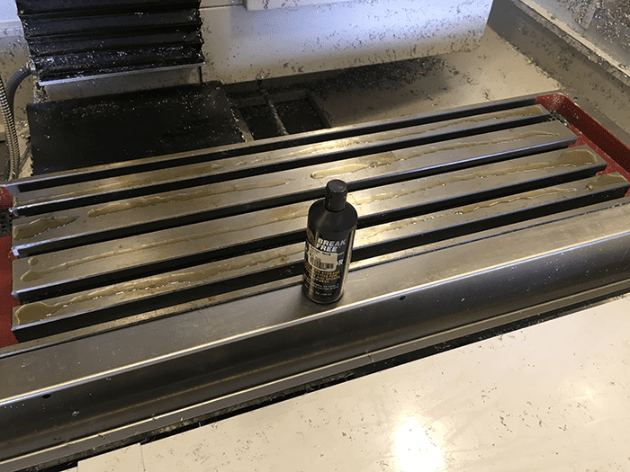

  2. Clean your machine’s table so there’s no chips or debris.  Stone away any nicks and imperfections.  You want a good surface for the Fixture Plate to lay on.
  3. Lay down some rust preventative on your machine table.  I like to use a product intended for firearms called “Break-Free.” It’s available inexpensively from Amazon–about $22 for a nice spray bottle as I write this. I use it constantly around the shop to rust proof my tools.  Put down a lot more than you think you need.  I made a virtual oil slick that made it easy to slide the Fixture Plate around until it was position perfectly.

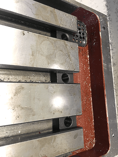

    Pivot the plate to expose the T-Slots on the right side of the table.  Pivoting is easy with the oil slick of rust preventative!
  7. Install 3 T-Slot Nuts, one in each slot.  Position the top and bottom at the right end of the T-Slot.  Slide the middle one as close to center as you can reach.
  8. Pivot the other way to expose the T-Slots on the left side.
  9. Install 2 T-Slot Nuts in the top and bottom T-Slots on the left.  Position them at the end of the T-Slot.
  10. Flip the Fixture Plate so the keys are down near or on the middle T-Slot
  11. Pivot the Fixture Plate so it lines up flush with the back and right edges of the table.  If it wasn’t already seated with the keys, they’ll drop into place.
  12. Now, having made sure the Fixture Plate is in the right place, you can see where the T-Slot Nuts are.  Use a tool such as a drift to reach through the Fixture Plate holes and align the T-Slot Nuts with the proper holes.

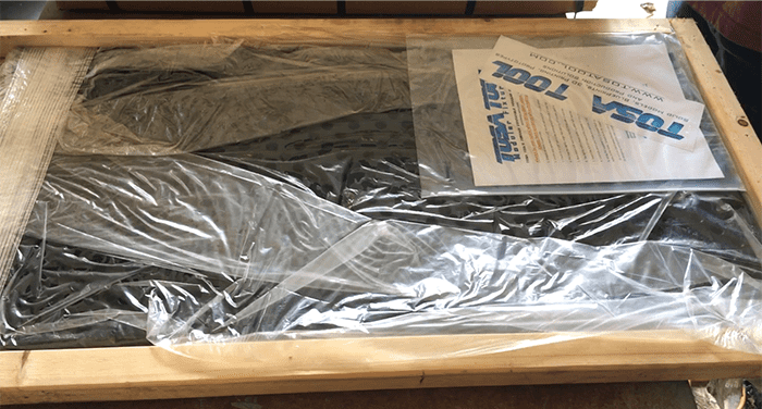

The Tosa Tool Fixture Plates are well made and have some premium features found on much more expensive plates and not available from the other inexpensive vendors.  Here are my favorites:
Packed in a Wooden Crate, not Cardboard
My Tosa Fixture Plate arrived in a nice wooden crate.  No cardboard here!  It’s a precision component, so I appreciate the extra protection afforded by the crate.

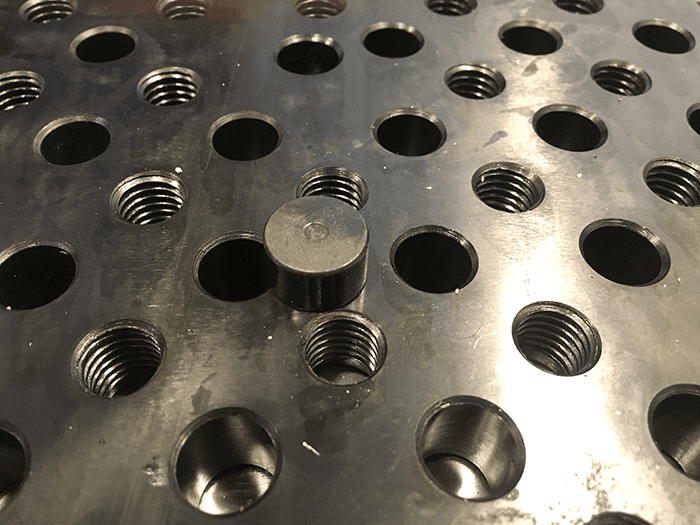

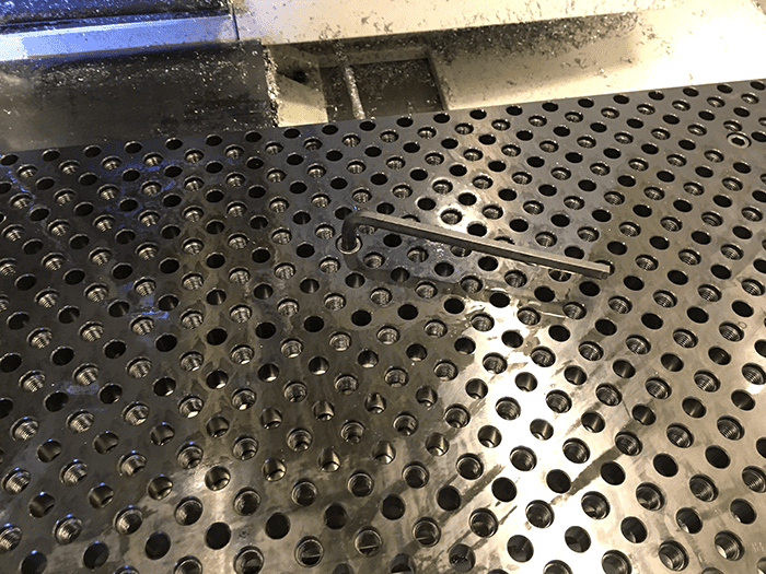

Mixture of Dowel Pin (Smooth) and Threaded Holes
The hole grid on a Tosa Tool Fixture Plate alternates smooth (dowel pin) and threaded holes.  The threaded holes take 1/2-13 bolts, and the dowel pin holes are 0.5005″ in diameter and finished smooth.
Why 2 kinds of holes?
Some vendors tap every single hole on the plate, but having both smooth bore and threaded holes is a better design.  When using a Fixture Plate, the holes perform 2 functions:
  • Location: This is the role of dowel pin (smooth) holes on the Tosa Fixture Plates.
  • Fastening:  This is the role of threaded holes.
If we make one hole perform both functions, we reduce the tolerance and repeatability with which we can perform the Location function. Imagine dropping a dowel pin down two bores.  One is half or even 1/3 as long as the other.  Remember, we’re talking 1/2″ diameters in bores that are 3/4 to maybe 0.8″ deep.  There’s a chamfer at the top and bottom so we have even less length available.  Which bore is going to hold the pin more accurately vertical and in position?
My money is on the full depth bore.  If you do go with a combination bore (threaded and smooth sections), make sure the smooth section is at least 1 diameter in depth so dowel pins are positioned with sufficient accuracy
In addition, if we have to thread a shorter length to make room for a Locating Dowel Pin, we reduce the amount of thread available for fastening.  What will that do to the strength and stability of our workholding solution?

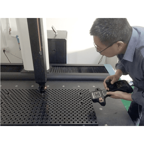

Precision Made
Inspecting Tosa Tool plates on a CMM to ensure tight tolerances…
When Dan Bye makes a Fixture Plate, he specifies that the hole bores are located within 0.0004″ tolerance.  Plates are blanchard ground to start and finish ground at the end. Every 5th plate is checked on a CMM (Coordinate Measuring Machine) to ensure tolerances stay tight.  Sounds great, but why is it so important?
The precision doesn’t affect most of the functions of a Fixture Plate at first glance.  After all, the fact a hole is off its theoretical ideal position by 0.001″ doesn’t affect repeatability or most other factors.  What it does affect is how easily we can use more than one hole to locate and orient whatever we’re positioning on the Fixture Plate.

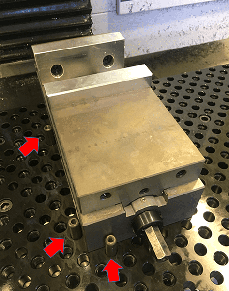

Now that you’ve got a Fixture Plate on your mill, let’s do something useful with it.  Consider setting up a vise on the Fixture Plate.  We’ll use our normal clamps to mount the vise, except that they’re screwed into the fixture plate instead of T-Slot Nuts.  I’m not going to bother showing that because it’s nothing new.
But here’s what is new:
We can ensure the vise is installed repeatably to the same location and perfectly trammed very easily.  Basically, the Fixture Plate locates your vise in the Z direction, so what we need to do is repeatably locate the rectangular base to an exact location and make sure it’s square.
Doing that requires us to locate 3 points, which are shown here:
mount a vise on a fixture plate
I’m using some dowel pins that are part of Tosa’s modular fixturing kit.  It comes with a variety of gizmos.  Here are just a few of the locating pin variety:
fixture plate locating pins
Locating pins for threaded holes, pins for smooth bores, and two keys for Tormach’s Milling Vise…
To use the three pins, place the vise on the Fixture Plate and slide it up against the two side pins.  This locates the vise on the X-axis and ensures it is square (trammed) to the Fixture Plate.
Next, slide it back so the rear edge contacts the rear locating pin.  That locates the vise on the Y-axis.
We’ve now located the vise on all 3 axes and ensured it is square to the table.  If we take care while clamping to ensure the vise remains in contact with the three pins, we will have installed it ready to go in a very short time.  No tramming required!
We can set up a work offset on the machine for the left corner of the fixed jaw, and the g-code will also know exactly where to find the vise and can assume that corner is part zero.  Now if we design parts with that in mind, we save all sorts of time.
And, if we need to pull the vise off and use another fixture, we can put the vise back on when finished with the other fixture and not even have to change our work offset (assuming it still has the old value).
Are you beginning to see the value of Modular Fixtures and Fixture Plates?
