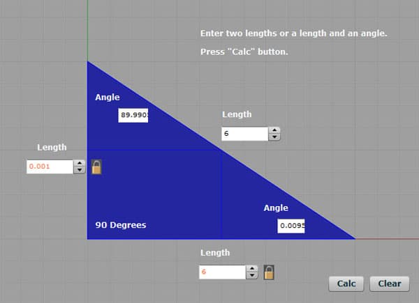

Let’s use G-Wizard Calculator to find out. We’ll start by asking how accurate a normal indicator sweep tram is.
Assume 6″ wide vise jaws, and further assume we sweep to an accuracy of 0.001″ across that 6″ distance. What’s the resulting angle?
We set up a right triangle in G-Wizard for this problem like so:
The maximum error we measure, 0.001″ with the indicator, goes on the left leg of the triangle. The 6″ jaw length goes on the bottom. We press “Calc” and the result is an error of 0.0095 degrees or less.

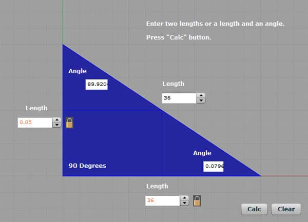

Now consider the straightedge. It is 36″ long. We can see a gap of probably 0.050″ without too much trouble. Set that up the same way and we get:
This method is obviously a lot less accurate: 0.0796 degrees versus 0.0095 degrees–about 8x less accurate. This is what you’d get if you indicated to within 0.008″. It’s probably not going to work out for a lot of jobs unless you can site it more closely than 0.050 in the gap. I did some experiments and I can personally see the gap accurately down to a small enough size to be good to an indicated 0.001″ tram.
