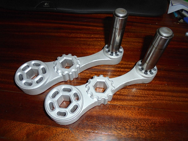

Evidently he’s cranking through enough parts to need one. I really liked his custom speed handles for his vise’s too:
Custom vise speed handles: nice!
