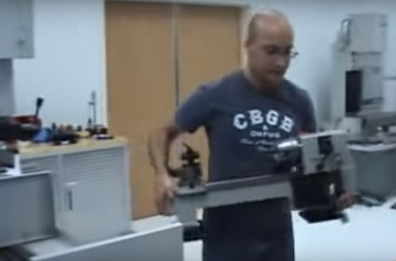

The Duality Lathe involved mounting an entire 7″ x 14″ Chinese lathe (essentially) to the table of a Tormach CNC Mill:
The Tormach Duality Lathe…
The Duality Lathe was an innovative idea, but not very robust. The little lathe had minimal capacity, questionable rigidity, and was heavy to put onto or take off the table. But, it enabled Tormach to get experience with the “Turning-On-A-Mill” paradigm and understand how customers would use such a tool. That experience was essential to enabling them to create their next generation product, which is called RapidTurn.

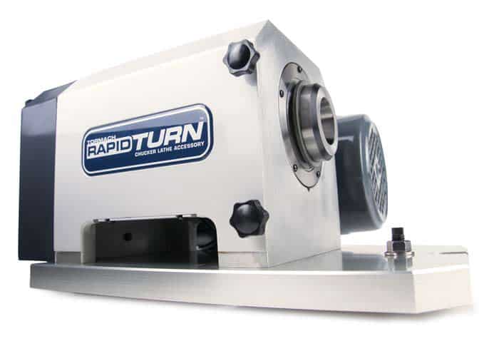

Tormach RapidTurn: Makes Turning on a CNC Mill Easy…
RapidTurn is in every way a much more robust unit than Duality. There’s some pretty clever stuff going on here:
- RapidTurn includes a locking indexing plate that lets you lock the part on 15 degree indexes so you can mill it. It’s not a real 4th axis, but you can do some useful things with 15 degree indexes such as cutting hex wrench flats.
- To make programming easy, they’ve made it compatible with their SlantBed Pro Lathe–using it with the PathPilot CNC Control is virtually identical. The unit supports CSS, Single Point Threading, and all the rest–so there is an encoder on the spindle.
- Tooling is held in a standard 0XA Quick Change Tool Post. Tons of standard lathe tooling will work with it off-the-shelf.
- They’ve thoughtfully included an upgrade kit at a lower price for Duality Lathe users. They can upgrade for $1695. If you don’t have a Duality Lathe, you can get a RapidTurn for either $2195 for the Starter Kit or $2795 for the Deluxe Kit which includes more accessories such as 5C collets.
- The unit is heavy duty, but lots of aluminum means it’s as light as possible when it comes to moving it on or off the table.
I suspect from the look of things that the RapidTurn will share other interchangability with the full scale SlantBed Lathe, though I don’t know that for sure.
