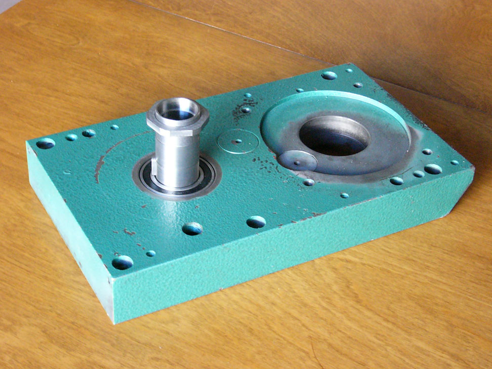

ATCSpindle Cut Away

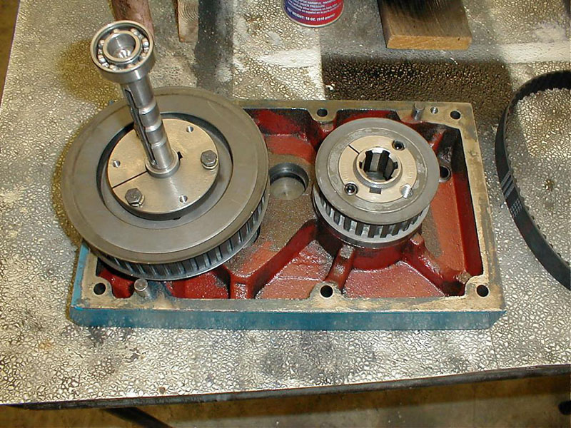

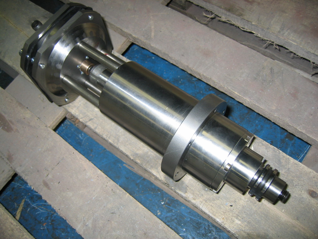

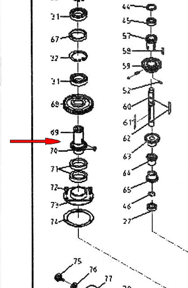

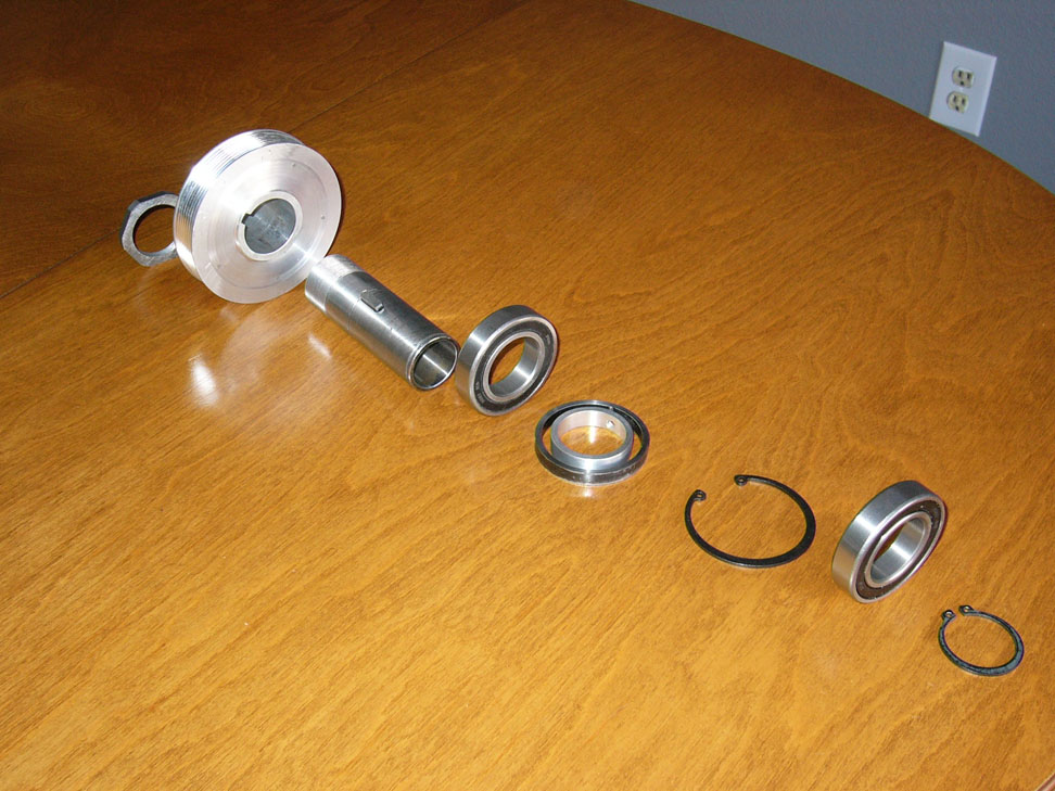

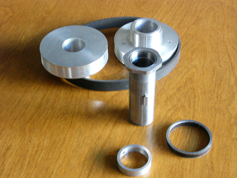

GD.Marsh's RF-45 Belt Drive
Some pix and comments from his CNCZone thread:

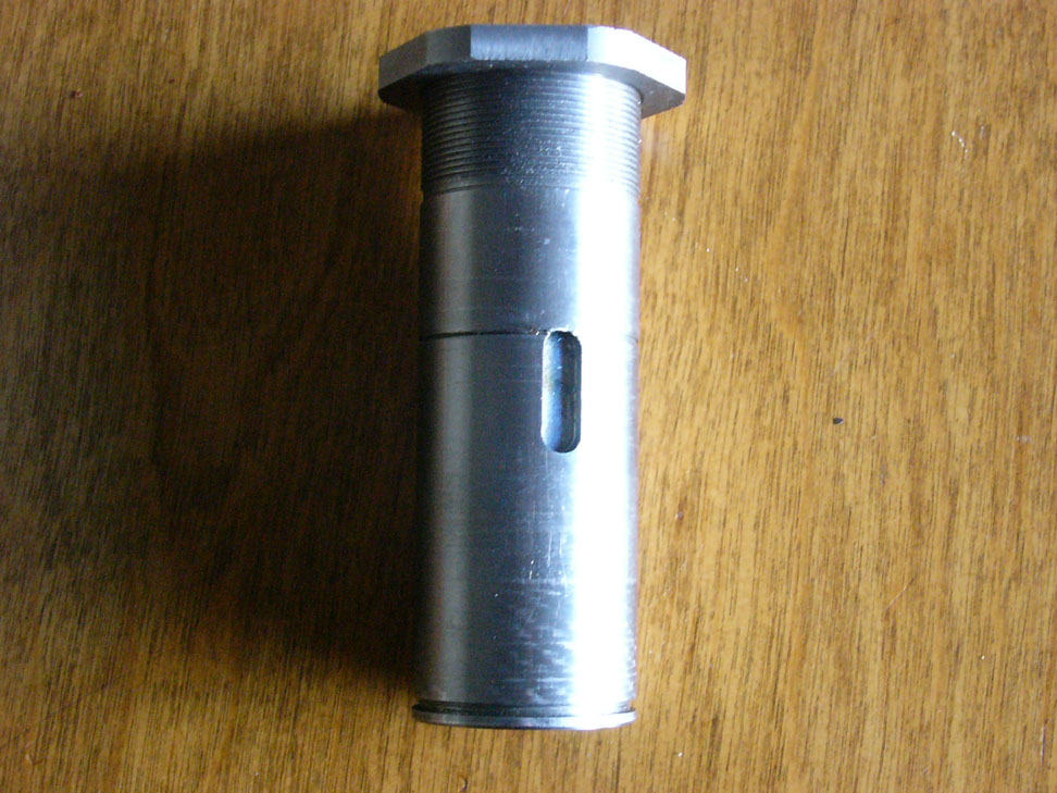

Exploded view of the mill head. This conversion involves the part with the red arrow...

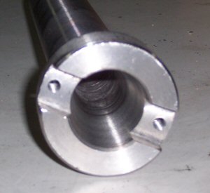

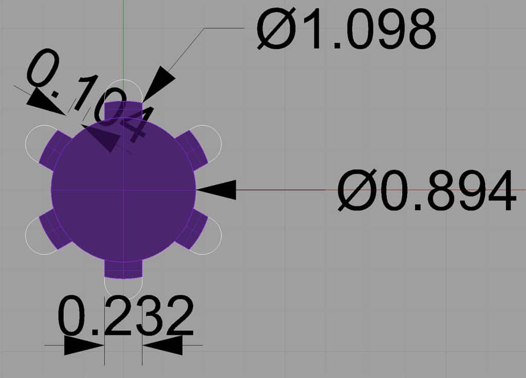

The sleeve contains the splines that engage the spindle. A gear had to be turned off the original...

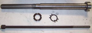

Components...
Bearings will be used to support the sleeve...
Here the stack is assembled with the bearings. Motor pulley to the right...
And here it is fitted to the top of the spindle case...
Bottom view...
Ready to receive the motor...
Ready to run, save bolting rather than clamping the motor mounts. The gizmo on top is so the power drawbar can squeeze instead of push and avoid damaging spindle bearings...

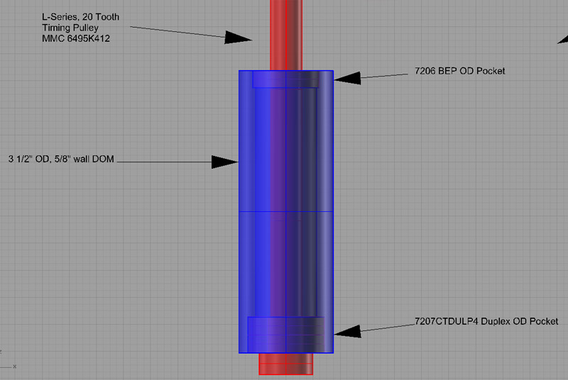

Here are the Nachi angular contact bearings he ordered from VXB:
Kit10017 7207 Nachi A/C 35x72x17 - $20.46
Kit10016 7206 Nachi A/C 30x62x16 - $16.11
He later upgraded to these:
7207CYP4 Abec-7
7206CYP4 Abec-7

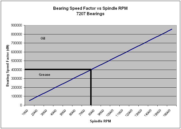

Bearing Greasing Factoid
There's a formula to get the cc's of lube, it is the last to digits of the bearing number x 5 x .06. This will give you the amount of cc's per bearing.
ex for bearing 7008:
08 x 5 x .06 = 2.4 cc's of lube.

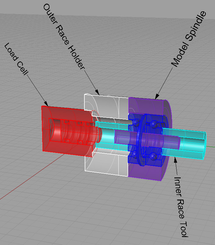

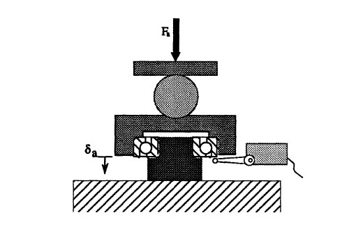

Another Preload Measuring Setup
Given a dial indicator to measure deflection, and a known preload that is to be established, here is a fixture to measure the deflection and hence the spacer required to create a given preload:

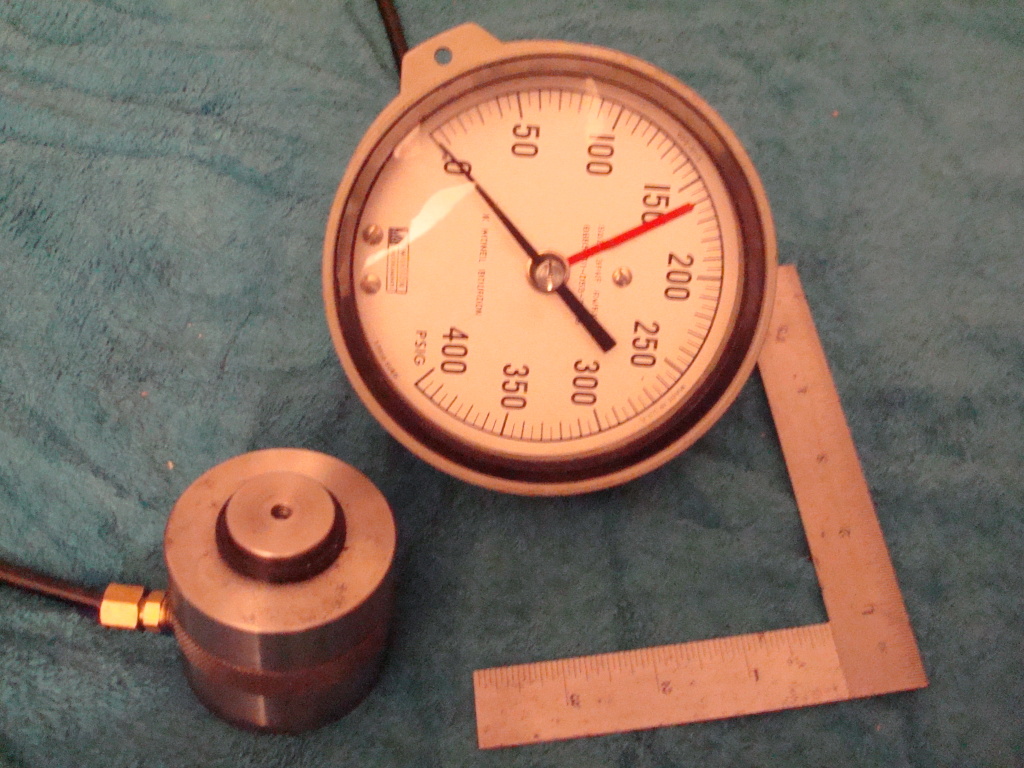

A Hydraulic Scale for Measuring Bearing Preload
Here is a hydraulic scale for measuring preload on bearing pairs similar to what I describe near the bottom of this page:
The idea is to use the scale with a test cell to measure the displacement of the bearing inner race when the appropriate preload is attained. Once that has been determined, spacers can be machined that deliver the same displacement and hence the same preload. There is some good discussion about this on the PM boards.

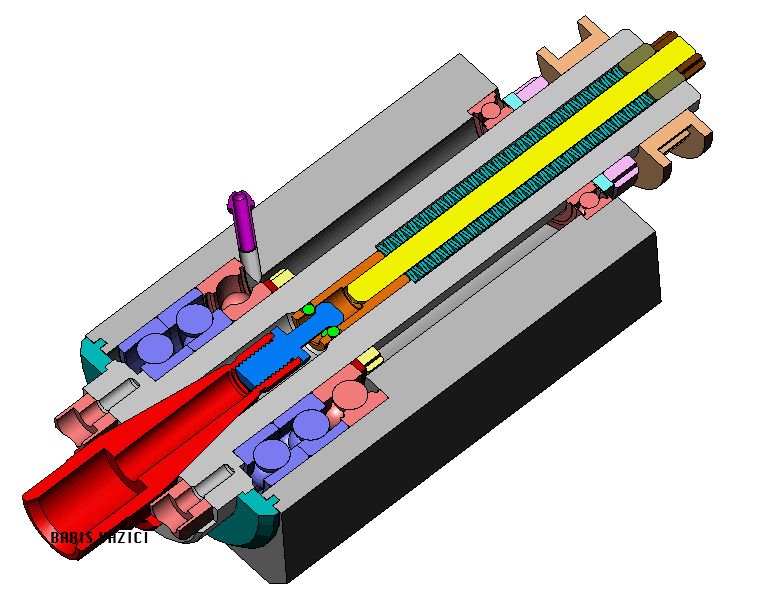

The Value of Spindle Wall Thickness
The stiffness of the spindle goes up as the fourth power of the wall thickness according to some information I saw in one of the bearing catalogs. That means you want the largest possible bearings you can afford because a small increase in the thickness makes for a much stiffer spindle.
How thick is thick enough?
A Mazak QT-20 lathe runs 120mm ID bearings on the spindle and has a spindle bore of 2.44. That works out to a wall thickness of about 1.142" or about 29mm.
Now let's say we want to build a lathe spindle with a spindle bore of 2". Let's give it a 1" wall thickness, so we need bearings with 4" ID which is 101mm. Since bearings come in 5mm ID increments, we can look at a 100mm or 105mm ID, which would be a 7220 or a 7221 angular contact bearing.
Brand new Nachi 7220 CYDUP4 bearings are $1351 each and you need 2 of them. Ouch!
I can see some others on eBay such as an SKF 7221 BECCM for $249.99. Better, but still painful for an experimental spindle project.

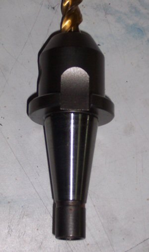

Spindle Orientation for Drive Tangs

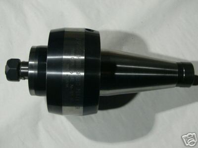

Suppose you want to run a 30 taper. It has drive tangs, so you need to be able to line up your spindle properly with the tangs to build an automatic tool changer. Most of the commercial VMC's are using a servo to drive the spindle (even
if it is a fairly ordinary motor with a fancy drive). That's one approach, but not cheap. Try looking for a 2 or 3 HP servo drive and motor!
Another thought is to use a smaller stepper that can be disengaged to index the spindle for tool changes. You want to disengage it because if it's driven all the time it wears out the stepper and it generates back EMF that will fry the servo drive. At the least you need to electronically disengage it.

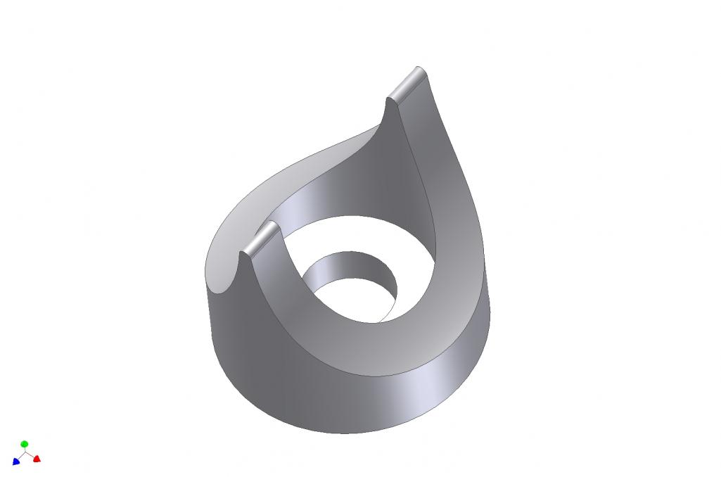

But there is yet another way that I just saw on CNCZone. NEATMan suggests using a cam action. Imagine a cam that looks like this and is clamped to the top of the spindle:
Now let's say we have an impact wrench style powered drawbar or an air cylinder that compresses a Belleville spring stack. Either way, there is a downward motion. We use that downward motion to push a roller equipped assembly against the cam. The roller will then turn the spindle until the roller is at its lower point, which should line up the indexing for the drive tangs.
Clever!

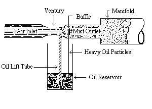

Principles of a Spindle Oil Mister
Commerical VMC's running at higher speeds (10K and up) use an air-oil mist to keep the bearings lubricated and cool. It works along these lines:

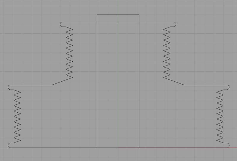

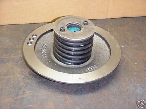

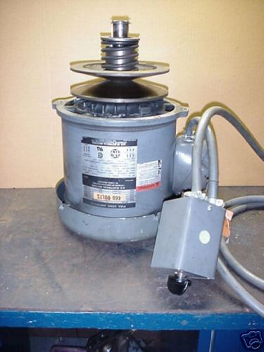

Snowmobiles Use Variable Pitch Sheaves
Could be a source of cheap parts. Check this Gates article.

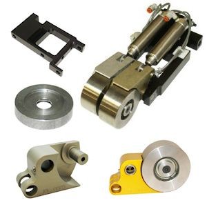

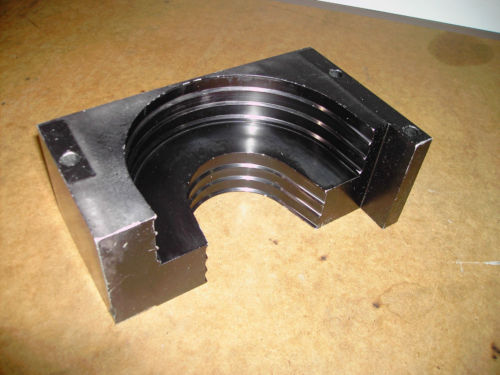

Fadal's Spindle Transmission Using Ribbed Belts and Idler Pulleys
Downloaded a set of manuals for a Fadal 4020. It's amazing what you can learn from these. There are exploded diagrams and detailed maintenance procedures.
The two things that interested me most were the details of how the toolchanger works, and the details of how the 2-speed transmission for the spindle works. The latter is particularly intriguing for this belt driven spindle project. I can't quite fathom all the details from the drawings and pictures, so I posted a question on CNCZone on a likely Fadal thread I found. If what I suspect is true, it would be a slick way of building a 2-speed transmission to extend the speed range beyond what a VFD will comfortably deliver.
Hopefully the gang on the ‘Zone will fill in my blanks.
Here is a picture of the idler assembly, $800 to buy one!
Fadal Idler Pulleys...
The system has 2:1 pulleys on the motor and the spindle. There is a ribbed belt on each, a 315K10 if that matters.
To engage one of the speeds, the idler pulley is triggered to apply tension to the belt being engaged by an air cylinder, visible in the picture above. A belt guide keeps the belt that isn't engaged from getting tangled up:

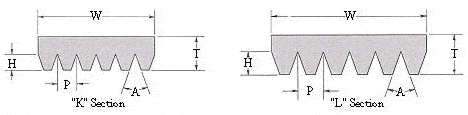

Fadal Spindle Belt Guide...
Node the ridges, and the way the top belt has a shelf to support it. The ridges allow a little bit of belt slippage without too much surface area for the belt that is disengaged. Not too hard to imagine the bottom belt just sitting there quietly. If tension is removed, it will flex out and not be driven. In addition, it is held slightly out of the way by gravity.
Given the ratios available, the "hi" gear will drive the spindle at 2x motor speed and the "lo" gear will drive it at 1/2 motor speed. Couple that with a 3600 rpm motor and you should have a range that extends from a hundred rpm all the way to 7,200 rpm. If you can overspeed the motor safely, you can get to the magic 10,000 rpm number. The Fadal-style transmission is also relatively compact. It seems an ideal addition to the project if I can figure it out. I might even build a manually operated prototype and look into air cylinders later.

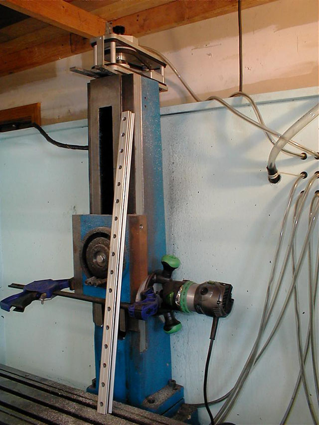

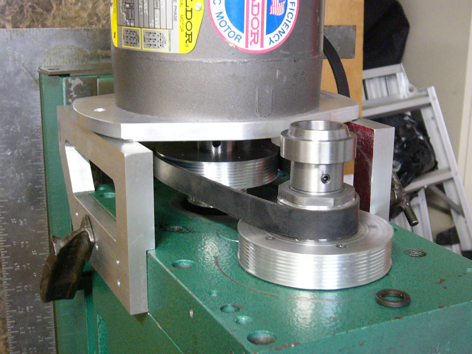

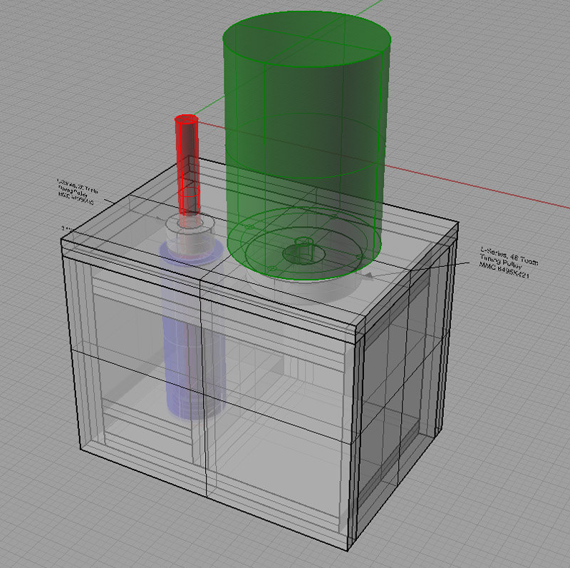

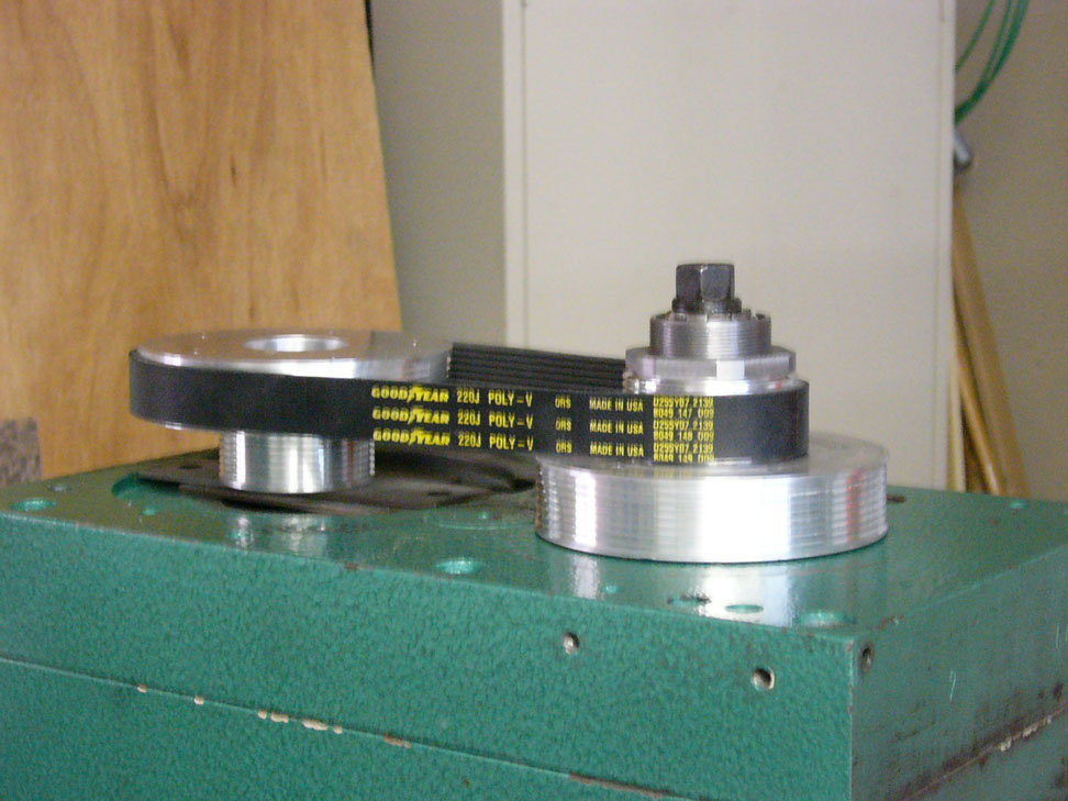

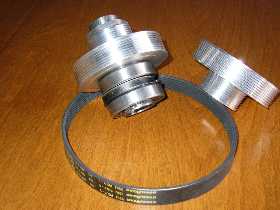

Another Belt Drive for the IH Mill is in the Offing!
What ho! The game is afoot!
Cruiser is documenting his belt drive conversion experience over on the CNCZone as we speak. In the same thread he has also gotten jiggy with the idea of attaching some linear slides to the sides of the IH column to help facilitate the Z-axis and overcome some of the stick slip from the poor marriage of a heavy head and very average dovetail ways. That's also quite an interesting mod:
Cruiser uses a router tied to the
existing dovetail slide to cut a bed for his linear slides. Cool!
Here is one "teaser" photo:
Go check out the CNCZone thread for full details!

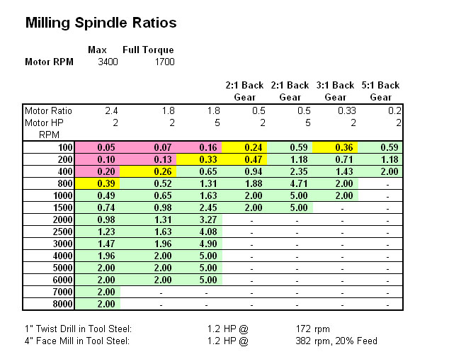

My conclusion on this is that a back gear of some kind is needed for low speed operation. There's just too much loss of torque at low speeds if you try to run belts directly with no ability to change gear ratios. One could use something as simple as cone pulleys to provide different rations, or something more complex like the variable pitch pulleys I have discussed below. Another idea is to use a much bigger motor, so that the torque drop off is less noticeable. For example, these mills start out at 2 HP. A 5HP motor should notionally be able to run at 1/4 rpm and have the torque of a 2 HP.
To get an idea, I did some rough back of envelope calculations. Let's say your motor is great down to 1/2 rpm, so a 3400 rpm motor is good at 1700 rpm. Let's further say you want to preserve torque to run at 100 rpm. I've worked out some possibilities in this spreadsheet:
The spreadsheet estimates horsepower available on the assumption that:
- The motor will deliver full horsepower down to 1/2 speed.
- Below 1/2 speed, HP falls off in direct proportion to how far the rpm is from rated speed.
- You can't run the motor over its rated speed.
I've experimented with drive ratios, which are listed along the top 2 rows, as well as motor horsepower, listed right below. The numbers in the sheet are "estimated horsepower". They're likely bogus as exact horsepower figures, but helpful as a guideline. If I had less than 0.2 horsepower, I marked that off in pink as being unusable. If I had less than 0.5 horsepower, it is marked yellow-probably usable if you go slow with a cutter that won't take much horsepower. To give an idea of some high horsepower operations, I played with a Feeds and Speeds Calculator and came up with big twist drills (always use lots of power) and a 4" indexable face mill. When cutting tool steel, they need 1.2HP. This just to give some "worst case" checks.
My conclusion from all of this:
- Bumping up to 5 horsepower doesn't buy you a lot more speed range. It's pretty similar (not surprisingly) to a 2:1 back gear.
- A 2:1 back gear is essential for lower horsepower motors just to survive with steel. 5 HP with a 2:1 back gear gets you all the way down to 100 rpm.
- 5:1 back gear is too wide a spread with a 2 HP motor. You'd have a dead zone from 800 - 1500 rpm.
- 3:1 back gear 2HP looks about right to me.

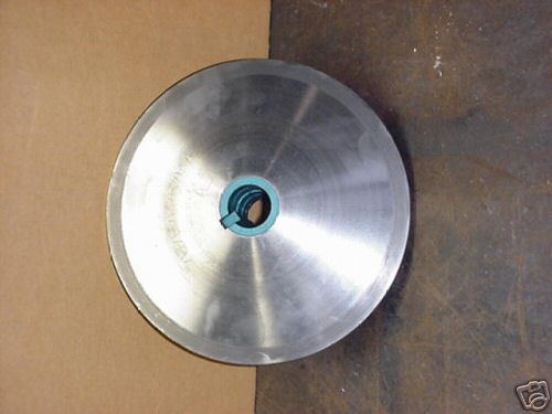

I like the use of a variable pitch pulley for system for back gear. Hey, if it was good enough for Bridgeport, its good enough for me!
You can use the variable pitch as your hi/lo shift mechanism. That means the vari pulley needs enough total ratio to cover the back gear + high speed. So, using the numbers above, for a 6000 rpm spindle that's 2 * 1.8 = at least a 3.5:1 vari pulley setup. For an
8K spindle (which I'm aiming for), you'd need 4.8:1. I'd run the system with preset stops. Probably 3 stops on the range is good, and use the VFD to fine control speeds within a stop.
A 2-stage system could use a 2:1 back gear and a 3:1 varispeed to get up to a 6:1 advantage, for real power down low. Some kind of tumbler system like the lathe guys use could work for the back gear shift.

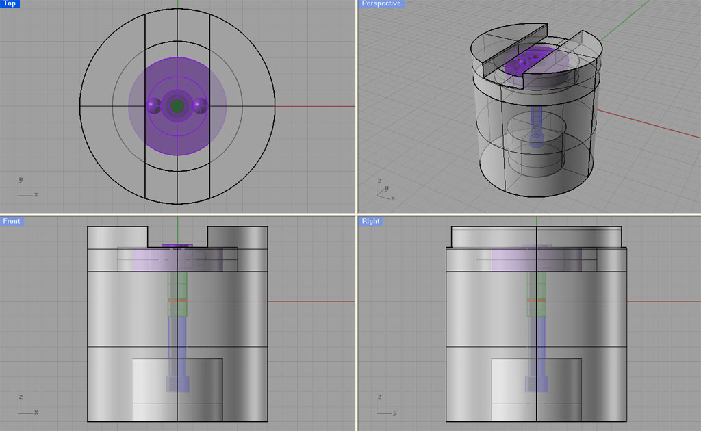

It seems most of the time that preload is going to be specified as pounds. For example, NCCams claims that 150lbs for a pair (75 lbs each) is the proper minimum loading for angular contact bearings holding a ballscrew. I keep trying to envision how to go about getting the bearings ground for that sort of preload. I presented my load cell idea below, but here is another idea.
Let's build a little fixture that uses some Belleville washer springs to come up with 75 lbs of preload. I can get 40lb Belleville springs from McMaster-Carr very cheaply. These springs are 0.312" in diameter, 0.025" thick uncompressed, and they reach their desired load after 0.004" of travel. So let's design a preload fixture:
The preloader works by applying compressing the Belleville washers (red) with a 1/4-20 socket head cap screw (blue) from the bottom. This compression is transferred by an anvil (green) that meets up with the bearing's inner races (bearing is purple) and forces
them up by whatever amount the 75 lbs manages. Before use, the fixture is calibrated by placing the desired preload weight atop the anvil and screwing in the cap screw until the weight is just lifted up.
Once calibrated, a bearing is placed on the anvil, and the slotted top piece is bolted down onto the fixture to hold the outer races flat against the surface of the fixture. A small section of the bearing's inner races will protrude. The fixture with bearing needs to be run through a surface grinder until it "sparks out" against the outer races, indicating that the inner races are now flush despite the preload.
If the fixture were to be used a lot, various sizes of cap and top anvil could be made up to suit different bearing sizes. The only requirement is that the anvil not contact the area very much outside the inner races, and the cap be made to only hold down the outer races and provide access to the inners.
I designed this fixture to be largely made on the lathe because that's where I think most will get their greatest accuracy. For best precision it seems to me the top and bottom of the cap as well as the top and bottom of the fixture's main barrel should also be ground flat and parallel. The slot in the cap need not be precision, and can simply be milled out.

Variable Pitch Pulleys
I worry about the effective operating range of a belt driven spindle that has only one drive ratio. The differences in speeds
when going from steel to aluminum are extremely large. While we can make the motor run slowly for steel with a VFD, it will lose a tremendous amount of torque in the process. For this reason, most machines have at least 2 drive ratios. A low or back gear is used for cutting steel, while the high gear is used for aluminum and other materials requiring higher spindle
rpms. One of the mechanisms used to effect these differing ratios is the classic cone pulley arrangement. This is painful because it requires a manual operation to swap the belt over to a different ratio.
A little better is a back gear arrangement, which could be done similar to the "tumbler" reverse arrangement that is
so popular for lathes. If this is done, one would thing the ideal thing is to have the gears driven directly from the motor such that the output of the tumbler gears is either 1:1 the motor's speed or 1/2 the motor's speed. This would then be multiplied via belt pulleys to get to the desired maximum spindle rpm. For example, let's say we have a 1500 rpm motor and we want to run at a maximum of 8000 rpm on the spindle. This calls for a 5.3:1 pulley ratio driving the spindle. If the back gear runs the motor at 1/2 speed, we would have 2 ranges: 0 to 4000 rpm and 4000 to 8000 rpm. So even when we run the spindle at 100 rpm, our motor is running at 100/5.3 * 2 or about 38 rpm. If the back gear had a 3:1 ratio, at 100 rpm we'd be running 56 rpm whereas at 8000 rpm we'd still be running 1500 rpm on our motor.
This is not bad, but back gears are going to be noisy, and we will have to fabricate a tumbler mechanism. Another approach to consider is a variable pitch pulley. In this arrangement, the pulley sheave is constructed of two halves that can separate and allow the belt to move in and out to various diameters. It's a really flexible system found in a lot of "pro" machine tools. Here is the variable pitch pulley still attached to the motor for a Bridgeport 2J head:
**Bridgeport Variable Pitch Pulley...
And a couple of other pictures of the Bridgeport variable disc assembly:
Bridgeport variable disc...
These pieces almost look simple enough to build from scratch. My main issue with that is I don't understand them
well enough to be sure my design would work well or to debug it if it didn't. I am probably better off to try to acquire one.
Variable pitch pulleys are available commercially from places like Lovejoy, but they do not look cheap. Interestingly, they are also available from the go kart industry where they're referred to as "torque converters" and are much cheaper. The go kart variety cost circa $60 to 70 for a 3-5 HP capable pulley system capable of giving a 3:1 range. One difference is that the go kart system changes its ratio based on the speed the motor is turning at using a centrifigul weight system. I don't know that you'd want that in a machine tool (although you might), but it seems like it ought to be possible to replace the entrifigul mechanism with a manually adjustable system.
For comparison a Bridgeport has a back gear and a vari-speed (variable pitch pulley) system. The back gear delivers 2 speed ranges: 60 to 500 rpm and 500 rpm to 4200 rpm. From this, we can see that the back gear has a range of 500/60 = 8.3:1-quite a stout back gear ratio!
The vari-speed system provides a further 8:1 variability range. Meanwhile, because this was all done mechanically, the motor is free to run at all times at its designed rpm, ensuring that maximum power is being delivered to the spindle.
By contrast, most VFD based systems are going to produce less power as the spindle slows down almost in direct proportion to how slowly the spindle is run. So the 8:1 range offered by the vari-speed system on the Bridgie means a reduction to 1/8th the power because the motor is running so slowly at the lower speeds. With the capability of maintaining the power supplied by the motor at constant levels due to infinitely variable pulley ratios, it is no wonder the Bridgeports and other commerical mills can outperform simpler amateur designs! A VFD can do a little better than this. According to a white
paper by Reliance Electric, they can hold constant horsepower over a 2:1 speed range. If you have the cash for a fancy vector drive, you can expand that ratio to 4:1, which is why the big VMC makers like Haas use vector drives to run their spindles.
If we add a go kart torque converter to our VFD only system, it has a 3:1 range. Let's say that rather than running from say 100 to 3000 rpm on the motor, this lets us run the motor at 300 to 3000 rpm. At the bottom end we're getting 3x as much torque as the VFD-only system. That seems a decent improvement. Of course the Bridgeport is generating 8x as much power at the lower end of its range, and the ranges are chosen to be an 8x spread of rpm for that reason so that the motor always delivers full power. For our example, 300 to 3000 rpm is a 10:1 range that the VFD has to span. Better than the original 30:1 range, but it means we may be looking at 1/10th the power at the bottom end. The trouble is the low end may be precisely where we want more power because we're cutting some really tough material.
Let's say we add a Hi/Lo back gear system to our go kart vari-speed system. Further, let's say we're doing so for a 100 to 8000 rpm spindle range, such as we're trying to design for this belt driven mill head. We have a motor that runs at 3000 rpm. With a 3:1 vari-speed, if we want to keep the Bridgeport ideal of max motor power throughout the range, we can allow a 3x variation. So, the top gear would run 2600 rpm to 8000 rpm, and the bottom gear would run 888 to 2600 rpm. Our back gear would be a matching 3:1 ratio. If we want to run more slowly than 888 rpm in low gear, we're looking at running the range down further than the vari-speed can compensate for with the VFD. 100 = 1/8th, so we have 1/8th the horsepower available at the slowest speed. Given the VFD allows a 2:1 range, we may have more like 1/4 the horsepower. If we tried to cover that whole range without a back gear or vari-speed, we would be looking at 100/8000 = 1/80th the horsepower at the lowest speed!
One issue that is going to develop from use of a vari-speed system is getting Mach 3 to understand what speed the spindle is really moving at. Imagine a system that mates a go kart "torque converter" to a VFD equipped motor. Let's leave the centrifigul feature in place so that the torque multiplication at lower rpms is automatic. One wonders how repeatable speeds will be. Mach is built without a closed loop to a spindle tachometer, so the assumption is that response to a given Mach 3 voltage level will always produce the same rpm. There is a provision for a "pulley" setting to allow Mach 3 to take back gears and the like into account, but this is discrete and not continuously variable.
This concept needs more thought and research, but some sort of back gearing mechanism or variable speed pulley seems a must for this project.

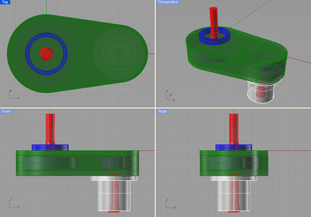

Belt Speeder Design Sketch
Below is a sketch of what Barry Ward called a "belt speeder":
A belt speeder...
The belt speeder is designed to plug into your existing R8 taper and clamp around the quill. Internally, it uses timing belts and pulleys to multiply the speed of the spindle. A compact spindle cartridge to the right contains another R8 taper which will now be travelling at 2.5x whatever the main spindle is doing. You could define the timing pulleys to create larger ratios if desired. I just did a quick sketch after hearing Barry mention it to get an idea of what one might be like.
Some of my thoughts about this setup:
- I'm not real happy with how bulky it seems. This makes me wonder about rigidity. Serious thought would need to be
given to getting it well clamped to the mill. - The offset allows access to a short drawbar for the new taper from the top. If I were to build one of these, I'd want
a power drawbar arrangement there, I've sworn off hand wrenching drawbars for life since building my power drawbar! - Since the spindle cartridge is so short, it may be possible to build it with just 2 angular contact bearings (one
at either end). Need to consider thermal expansion when doing so.
In the end of the day, I am still convinced a new mill head is the best bet for me, but for a lot of other folks, a removable spindle speeder may be a nicer idea. Certainly if you have a big mill like Barry's Shizuoka CNC mill, it's probably hard to consider building a new head for it.
One other thing that goes through my head is whether a planetary gear arrangement couldn't be built. I have purchased
on eBay a 4x spindle speeder to look at (it was cheap):
Yuasa Spindle Speeder
My thought is whether one couldn't use the planetary gearset from an automatic transmission to do this job. They
are available very cheaply from many sources, including eBay. In fact, I purchased a set to build a fancy collet chuck (another project I still haven't gotten to!):

Bearing Speed Factor (dN) and Bearing Lubrication = Oil Mist or Oil Lubrication
Bearing speed factor is calculated as follows:
dN = N x (ID + OD) / 2 where N = spindle rpm, ID = bearing inner diameter, and OD = bearing outer diameter.
So, for the example of this spindle, we're looking at 7207 bearings and 8000 rpm, so we get a dN value of:
8000 x (35 + 72) / 2 = 428,000
What does this tell us? It gives us an idea of what kind of lubrication we need to consider. Assuming we get the preload correct for the bearings, we must still get the lubrication right or the bearings will overheat and fail. If we are even marginally off on preload, we're going to need some safety margin on the lubrication front as well, so we don't want to flirt with the theoretical maximums.
The theoretical maximum for grease lubricated AC bearings is a dN of 850,000. However, if we consult the literature from Barden bearing, we will see that this requires a pretty specialized grease to achieve, and that more typical values for dN are 400,000 to 600,000. My conclusion looking at that information is that we ought to consider oil mist lubrication for this spindle project. It has a theoretical limit of 1,500,000 dN, which seems like it gives a much better margin for error. Oil misters are inexpensive and readily available, so it seems like it would be straightforward to add oil mist cooling to a cartridge spindle such as the one we are contemplating here. Below is a graph showing spindle speed versus bearing speed factor for
the 7202 bearings that will be used for this spindle project.
Bearing Speed Factor for 7207 AC
Bearings Showing Grease vs Oil Lubrication Regimes
It is interesting to note that your basic modern CNC milling machine spindle, such as a Haas, typically uses oil mist lubrication. I don't know if I will go to the trouble of an oil mist or not, but it seems worth considering at least. What's needed is to test the spindle and monitor temperatures and preloads. If they do okay, there is no need for the added complexity. If they are marginal, its worth looking into. The other thought is that it is easy to see why 8000 rpm is a difficult number for this project as it sits right on the cusp. 6500 rpm or 7000
rpm (if you are feeling luck) would be a slam dunk for greased bearings. And that's just where a lot of commercial knee mills wind up.
HuFlungDung, who has rebuilt the spindle on his Haas VF3, mentioned that the oil mist system on the Haas is dead simple:

My thought on determining the right shim thickness for a given preload would be to create a special load cell that simulates the bearing application and use that load cell to measure the effective preload as various shim thicknesses are experimented with. For a DB configuration, which is most desireable for a spindle (its the stiffest), the inner rings would be ground. This is simulated by shimming the outer ring. Now the load cell has to measure the amount of force needed to bring the inner rings into contact for a given amount of shim between the outer rings. The load cell preload testing rig looks like this:
Load Cell Testing Rig for Bearing
Preload...
The load cell (Red), is a simple cylinder filled with mineral oil and equipped with a pressure gauge. The piston
has a little tool (Light Blue) attached to it that bears against the bearing inner race (Dark Blue) while a similar tool bears against the second bearing's inner race. The two bearings are installed in a model spindle (Purple),
complete with shaft, and are separated by a precision spacer. The outer races are held by another piece of tooling (Gray/White) as well as by their press fit in the model spindle.
To use the test rig, stand it up in an arbor press and apply force to the top inner race tool. Force could also be
applied using weights or by tightening a screw. It should be possible to increase this force until the inner races of the two bearings are tight against one another. Since force is applied to the top bearing, no load
will register on the lower bearing until the two races are in contact. At that point, further increases in force are passed through, so we need to look for the minimum force that will register on the test rig, and this will be the preload that is generated by the spacer between the bearings. A thinner spacer will result in less preload, while a thicker spacer results in more preload. It will be necessary to follow a test regimen that involves several spacers being tested until the appropriate preload is achieved. Unfortunately, we need to work our way from thinner to thicker spacers, which will necessitate making more than one spacer in order to perform the tests. In this way, it should be possible to create a desired preload by substituting some labor in this testing and in the creation of spacers for the purchase of more expensive duplex bearings.
I note from a CNCZone thread that Misumi will sell you a custom bearing spacer for $7.00. I'd like to know more about the specs and tolerances, but that might be just the ticket to preload bearings.

Mounting the Spindle Cartridge
Commercial units, such as the [Setco belt drive cartridge spindles](https://www.setcousa.com/files/files/S-0001-2 ProMetrix-HS.pdf), are typically mounted using a flange
and machined cylindrical surfaces. Adding a flange either requires completely boring solid stock or welding a flange to the DOM tubing and machining both back to trueness. Another approach also found in Setco's line is a rectangular block for the cartridge. This still requires considerable machining effort. The likely material for such a block would be aluminum, although Setco uses gray iron, which is also a possibility. Either a flange
or rectangular block simplifies the task of mounting the spindle cartridge to the case considerably.
For what it's worth, the Setco cartridge spindles run with two angular contact bearings up front and two roller bearings in back. The angular contact bearings are duplex but are not in contact, and are separated from one another by an inch or two, and are run in a "DB" (back to back) orientation, not "DF". They offer an optional 3 bearing nose system for even more rigidity. The design accomodates swap in of the additional bearing simply by installing a new, shorter spacer between the original two, which creates a DT-DB combination. Yet another swap also a quad DT-DB combination to be installed for even higher performance.
Their F040-030M model is an NMTB #30 taper spindle cartridge.

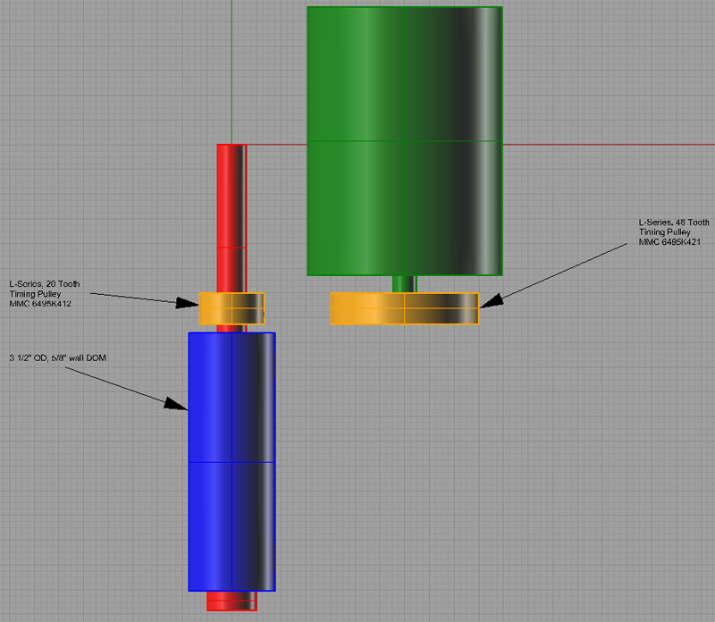

Mill Head Sketches
Here are some quick sketches in Rhino 3D of the mill head. It is based on a 3 bearing design, with the duplex ABEC 7 7207CTDULP4‘s at the bottom and an ABEC 3 7206 BEP at top. I really think the duplexed bearings that surround the toolholder will add tremendous rigidity. This design is based on a couple of off-the-shelf timing pulleys, and on the Leeson 192074 motor upgrade that Aaron recommends and that is sitting in my garage as we speak. Based on a top speed of 3000 rpm from that motor, and the 2.4:1 ratio'd set of pulleys, this yields a top spindle speed of 7200 rpm, which is right what I am shooting at. McMaster Carr also lists one larger pulley size, and these sketches will accomodate that pulley as well. If one uses such a pulley, a spindle speed of 9000 rpm would be generated at the top end. That seemed a bit much for me, but the pulley is not that expensive to order and experiment with.
There is a lot that is not considered by the sketches. For example, how do you go about changing the timing belts or adjusting their tension? The exact mechanism by which the cartridge spindle is clamped in place and aligned for precision and rigidity is not detailed here. I'm wondering if a split clamp arrangement like what one finds on engine crankshaft bearings wouldn't work. Yet another issue is how the bearings will be protected from swarf and coolant. This is not detailed. One thought I have is whether to feed compressed air to the spindle cartridge. This would have two benefits. First, there is a cooling benefit. Second, it would provide a positive pressure system that would help blow swarf back out of the spindle. Ideally it would be arranged so the air only flows while the motor is running, by using a solenoid valve in the air line. Cosmetics could be greatly improved with judicious chamfering and rounding of edges, and I have not specified fasteners at all. I need to make sure there is the potential for thermal expansion without damaging the bearings. The list goes on. It's a sketch, not a finished design!
Materials are pretty straightforward. The spindle cartridge is 3 1/2" OD x 5/8" wall thickness steel DOM tubing. I've checked and it can be machined to the specs desired for the bearings. The rest of the mill head is made from 1" aluminum plate. Ideally one should do a Finite Elements Analysis to optimize and quantify the design. Perhaps someone on one of the web sites will offer to take a 3D model from me and perform that analysis. It is tempting to fill the big chamber behind the spindle cartridge with concrete in order to further dampen any vibration in the head. With all of the aluminum, it seems unlikely this will make the head much heavier than the stock gear drive head.
One last thought is that the IH spindle clearly protrudes considerably above the top of the head. This is due to elimination of a quill. It would be my thought to cut this off and fit a shortened drawbar with power changer up there.
On the face of it, this does not look like all that difficult a project, although it must be completed with some precision. Here are the sketches:
Overall transparent view of the
head...
The Spindle Cartridge, Timing Pulleys,
and Motor...
Some Detail on the Spindle Cartridge...
Souping Up This Spindle With Duplex AC Bearings
Aaron called out 2 bearings to mount the spindle in the IH mill as designed, a 7206 BEP at top and a 7207 BEP at bottom. A duplex pair of 7207's at the bottom would really increase the rigidity of this spindle setup, although not cheaply. It looks like there is enough bearing area on these spindles to accomodate a duplex pair, although I would need to measure it to be sure. One source for such a pair in ABEC 7 accuracy
(very good!) is Bearings Direct, which will sell a matched pair of 7207CTDULP4 for $347.89.
This would provide a significant step up in rigidity for this mill. Given that I plan on machining a new head to house the spindle, it would be straightforward to make provision for a duplex pair. It's mighty tempting, I have to say!
I was reading another thread on spindle design on CNCZone and Mike Aber opined that having looked
at 3 different Asian mills, they were all using deep groove ball bearings and not angular contact bearings. He chose to use that as an excuse to save the cost of the expensive AC bearings. I choose to look at it as reason to believe the performance with a nice set of bearings could be a lot better than the old mill head.
New #30 Taper Mill Spindle Came Today!
I got the spindle from Industrial Hobbies and the bearings from McMaster-Carr. Nice combo. The finish on the spindle is nicer than what IH pictures on their web site. Now I'm champing at the bit to turn it into a mill head! Just have to wait until I finish my other projects though. I need to research carefully how the bearings needed to be fitted to both the spindle and the bores in the mill head I will fabricate. The bearings are SKF's, a 7206 and 7207 angular contacts. Their specs indicate a pretty high speed is possible, so hopefully my goal of 6000-8000 rpm will be doable. I should think so in this application which is pretty lightweight.
Building the mill head will largely be a matter of fabricating a box. I need to build a box that will properly house the spindle, bolt to the existing dovetail assembly that the current head bolts to, and that will be nice and rigid. I'm thinking of making it out of some pretty substantial aluminum, perhaps some 1" thick stock or even thicker at top and bottom. I'm thinking of aluminum because it doesn't have the problem of internal stresses moving it after it is machined, so it will stay true. While I'm at it, I think I'll set up this head so it gets trammed in once, and then stays put. There's no need to have a swivel head on a CNC machine, as well as no need for a quill which just reduces the accuracy and rigidity of the head anyway.
By taking this approach, I also avoid having to turn down the shaft of my larger motor to fit the IH gearhead. I can just specify a pulley for the timing belt that fits the motor as is.
NMTB 30 Spindle for the IH Mill!
Industrial Hobbies is having a going out of business sale, and one of the things they are offering is an ISO 30 or NMTB 30 spindle for the IH Mill. At $65, how could I resist? This is a better spindle taper than the classic Bridgeport R8, and is really the preferred taper for building a toolchanger for this mill. Aaron also recommended a set of angular contact bearings from McMaster-Carr that cost another $100, so I ordered those too. What I'd really like to do is take these goodies and create a belt driven head for my mill that's capable of higher rpm's than the current geared head. The more rpm's the merrier so far as I am concerned. I can always use a VFD to cut down on the rpm's if need be.
Anyway, this will be one of those very long term projects. I had to act now to get my hands on one as they were in limited supply and he is going out of business. We'll see what comes of it.

Belt Drive for the Industrial Hobbies/Rong Fu Mill
Spindle Drive Adapter

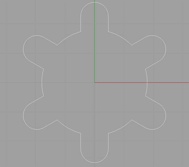

The critical and most difficult part to fabricate for the IH belt drive is the Spindle Drive Adapter. This piece has to fit over the top splined part of the spindle to drive it. It must do so tightly, while transferring the full power, and it must be supported in bearings so as not to allow the tension on the belts to transfer lateral force onto the spindle itself.
Here are the dimensions for the Industrial Hobbies mill spline:
Rather than broaching the splined piece, I plan to just mill out an approximate shape, something like this:
This path can be milled out via CNC using a 3/16" endmill. I want this part of the adapter to be at least 1" thick so it is solidly clamped to the spindle. That's apt to be a chattery business to cut more than 5x deeper than the endmill diameter, so I plan to drill 6 holes and then interpolate the center hole (or perhaps bore it in the lathe) before I attempt to profile the complex curve. The spline width of 0.232 is a touchy business too, since it is smaller than 1/4" and much larger than 3/16", finding an appropriate endmill diameter is problematic. If I can use a 6mm diameter endmill, that gets me with an oversize of 0.004". Worth a try to see if it works very well being that much oversize.
Rather than profile those deep slots to connect the interpolated center hole with the drilled spline holes, I am thinking the answer is some plunge milling. Plunge milling is ideal for rigidity challenged situations. In this case, a series of plunges that move from the center hole radially to the drill holes should clear out that material very nicely without a lot of chatter.
I'll machine a test piece that consists strictly of this part to trial fit it to the spindle shaft before I attempt to make the overall adapter. I want to make sure it all comes off well!
CNC Codes
Note: These codes are for a test piece, and not the actual adapter!
Spline Holes: Drill 6 holes with a 0.236" twist drill bit ("A" drill).
Center Hole: Interpolate the center hole with a 1/2" 2 flute endmill.
Final Profile: Cut the final profile with a 3/16" (0.1875") endmill.
Sheave Designs
A little research in Gates Heavy Duty V-Belt Design Handbook yields their recommended minimum sheave sizes. I am still waffling on a 1750 rpm vs a 3450 rpm motor, so I picked a minimum size a tad larger than what the 3450 requires. These minimum sizes are designed to allow maximum transmission of power-in this case up to 5 HP. Allowing for a 2:1 ratio at either end (e.g. my 1750 rpm motor will drive the spindle to 875 rpm or 3500 rpm depending on which ratio is selected, hi or low), I want a 2.75" small sheave and a 5.5" large sheave.
I have settled on using a K-series multi-rib belt because what the heck, that's what Fadal used for their spindles. It's probably overkill, but the belts are cheap. Getting the K-series profile right was not hard given a G-Wizard user had just sent me some information machining sheaves for automotive ribbed belts. Here is the K-Series profile:
For "K" series belts (most automotive belts) : P = 0.140" (3.56mm), W = No. of Ribs X P, T = 0.235" (5.97mm), H = 0.110" (2.79mm), A = 40 deg.
For "L" series belts: P = 0.185" (4.70mm), W = No. of Ribs X P, T = 0.280" (7.11mm), H = 01.65" (4.19mm), A = 40 deg.
I need to think a little more on whether to stick with the K or drop down to say a J-series to reduce the size, but for now, let's continue the exercise assuming K-series. Here is what the double sheave will look like:
A rough profile of the double sheave...
There's still some design features to think about:
- How will the sheave be locked in place on the spline?
- How about guaranteeing the height of the bottom above the base so there is no rubbing?
- What about a speedometer or encoder provision?
The grooves for the belt ribs are 40 degree angle. I also need to think about what sort of tool I want to use to machine those:
- The automotive ribbed belt tooling from Tool-Flo came well recommended, so I need to see what that would cost.
- The grooves can be profile with a 35 degree diamond tool. A combination of SECO VCGT331F-AL KX insert in a SVVBN123 holder was recommended in this Practical Machinist thread.
- I can also grind a 60 degree threading insert to the 40 degrees required for these sheaves.
A number of considerations here. The Tool-Flo and reground threading inserts are all about plunge grooving while the 35 degree diamond is all about profiling. Plunge grooving would be very easy to hand program if your CAM doesn't support it, but most any CAM will figure the profile needed by the 35 degree diamond. If you had to make a bunch of pulleys (I don't), it might be better to plunge groove.
