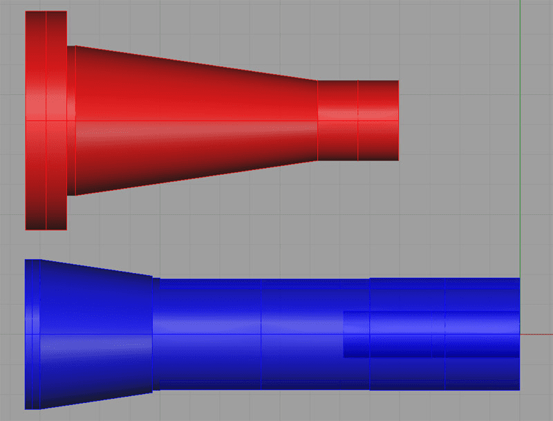

For comparison, here is a CAD drawing to scale of a 30 series next to an R8:
BT30 versus R8…
The BT30 is a little shorter than an R8, but it is much beefier along the tapered section where it counts. If you hold the two in your hand there’s no question which one is the more rigid and industrial strength option–it’s the BT30. This should come as no surprise–the R8 has been around a very long time and the people that designed more recent tapers were well aware of it and wanted to design tapers that could outperform it.
Being shorter helps too because it preserves a little Z-travel for the machine. Remember there has to be room under the spindle at max Z to slide the toolholder under for a tool change. All things considered, a 30 series or perhaps one that’s a little smaller is the taper I would target for the Ultimate Benchtop CNC Mill. An even smaller taper makes more sense if you plan on a fairly high rpm spindle. You won’t be running the types of cutters that need a bigger taper at such rpms anyway.

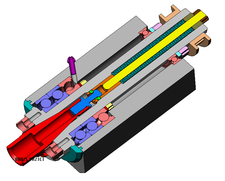

Given an actual spindle or spindle cartridge, you’ll need some automated way to install and remove toolholders from the spindle taper. These mechanisms for the tapers we’ve been discussing are called “powered drawbars”. They’re drawbars because they grab the end of the toolholder and draw it up into the spindle until it is held tightly in the taper. Two styles are prevalent–the washer spring version with pullstuds and a version that uses an impact wrench to operate a conventional manual drawbar. The latter is much easier to engineer while the former can be faster and quieter to engage and disengage the toolholders. The principle issue will be whether you can create a pullstud and drawbar arrangement inside the confines of your spindle. This may require re-machining the ID of the spindle to accomodate the action of the pullstud clasper. Here is a typical design using ball bearings (more details and source links on the CNCCookbook spindle page):
Spindle design showing pullstud drawbar setup…
The toolholder (a proprietary design in this case) is shown in red, and the pullstud is blue. The drawbar, yellow, is tensioned by a stack of Belleville or Washer Springs (blue green). The orange unit on the end holds several ball bearings (green) that are sized so they can fit under the head of the pullstud and grab it. As the drawbar moves down to release, the ball bearings are no longer trapped against the narrow wall of the upper spindle–they can move aside and let go. Therein lies the problem–you need the right shape inside the spindle ID to guide ball bearings (or whatever other mechanism you use).
Here’s a great video from Dave DeCaussin (the man who originally did most of the design work and helped found FADAL) on his “Cat R8” taper and how the drawbar works there:
The Tormach Tooling System drawbar does this nicely by relying on an R8 collet permanently connected to the drawbar by threads just as a manual drawbar would be. That makes accomplishing all this in an R8 taper relatively easy. But for other tapers, another solution must be found.
One thing to make sure of if you’re designing a drawbar system like this is to avoid putting pressure on the spindle bearings. Typically these systems use a sort of pinching arrangement that balances the pulling force against a fixed component of the inner spindle so that there is no pressure agains the spindle bearings that might damage them. Another thing to consider is the forces required to hold the toolholder properly. They’re quite high. Checking the drawbar force is a standard maintenance procedure for VMC’s, so it’s worth seeing what the recommended force is for various taper sizes.

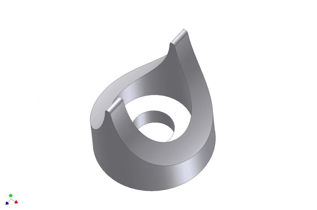

The last method is mechanical position. A shot pin that goes in a conical hole can align the spindle if you can get it stopped electrically at nearly the right place. Alternatively, you can use a cam action and the downward motion of the drawbar to align the spindle using a cam atop the spindle that looks like this:
Cam action for locating spindle orientation for a tool change…
There are lots of different solutions to the problem.

The only comment I have is that having a drawbar release mechanism leaning on the spindle bearings is not automatically a bad thing. Intuitively, it makes sense to release the drawbar via some kind of ‘pinch’ mechanism that leverages against the spindle and not the bearings. However, all spindle applications axially load the bearings in normal operation. Drilling a 1/2″ hole in steel, for example, puts a very significant axial load on the spindle bearings.
A properly engineered spindle would consider the largest probable axial force, add a safety factor and compare the result with the dynamic and static load specification for the bearings used. Deep groove ball bearings have relatively low capacity. Angular contact are much higher and tapered rollers can withstand massive axial forces.
So, while in some cases (as might be the case with adding an inexpensive cartridge spindle) it would be prudent to keep the drawbar forces off of the tiny spindle bearings as a reasonable precaution. However, in an engineered system where all of the forces and specifications are known, it may be that the drawbar tension ranges from 2,000 to say 4,500 lbs closed to open, and the spindle bearings have a static axial force spec of 7,000lbs, The bearings in that case would not be harmed by carrying the drawbar release force, and the arbitrary addition of an expensive and potentially troublesome pinch mechanism would not provide any tangible benefit.
Steve, sorry I’m going to stick to my guns on the need to avoid leaning on the spindle bearings. Fortunately, I am in good company as Haas and many others take care to use a mechanism that squeezes rather than pushes. You can see the Haas model very clearly in their maintenance manual here:
http://diy.haascnc.com/sites/default/files/Locked/Manuals/Service/2008/Mechanical_Service_Manual_96-0283E_Rev_E_English_June_2008.pdf
Just search down to TRP section. It also shows quite nicely their sensors for whether the drawbar is locked or open.
Why would they include a mechanism that’s expensive and troublesome if it weren’t needed?
First, the mechanism is neither troublesome nor expensive. It simply requires mounting the drawbar air cylinder on a platform that floats on spring loaded guide pins and engages against a flange at top of the spindle. No big thing.
Second, the issue they’re worried about is not whether they will exceed the static axial force spec of the bearings. These machines have far higher specs for that relative to drawbar force than any hobby class machine is ever likely to.
The answer is the bearings do not like static force very much at and and they particularly do not like static shocks. Even the forces of excessive vibration can lead to false brinelling and the premature wear of your spindle. Or, as one spindle repair shop says:
” Never strike a spindle. Never transmit static force through the rolling elements. Always protect spindles from vibrations.”
http://www.highspeedtechnologies.com/spindle_repair_faq.html#8
At the very least, there can be no question that what we’re talking about is transmitting static force through the rolling elements. It’s not that hard to avoid it, so why not take the expert’s advice and do so?
On the spindle bearing pressure with a drawbar, if you pushed rather then squeeze you would push the spindle out of the bearings. They are rated with the force being applied from the tooling side, not the top side.
