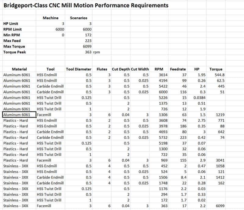

Let’s work through some example scenarios. I like to use a spreadsheet to compile the scenarios, and G-Wizard Calculator to generate the data. If you don’t already have G-Wizard Calculator, you can get a free 30-day trial of it.
Bridgeport-Style CNC Milling Machine
To give an example of taking a look at Motion Performance scenarios, let’s say we want a machine roughly comparable to a Bridgeport Knee Mill in capability. It has a 5000-6000 rpm R8 spindle, depending on which clone you look at, and these mills are good for cutting anything from plastics to steel. It’s important to know your spindle’s rpm limitations (both fastest and slowest rpms) when working through these scenarios. Here’s what my spreadsheet (click to download) looks like:
Scenarios for analyzing the motion performance requirements for a DIY CNC Mill…
For an actual project, you’ll want to work through more scenarios, but this gives us a starting point for discussion. What you can see from the spreadsheet is the basic performance envelope you’ll need. The maximum feedrate is 223 IPM. It’s required for plastics, which are soft and can take quite a lot of chip load. We can choose to run more slowly than that, of course, but it is good to know that would be a nice number to hit.There are not a lot of feedrate numbers over 100 IPM, which is why you see so many hobby machines in that category. High feedrates come about from soft materials and high spindle rpms.
We can also get an idea of horsepower and torque requirements, or at least understand what the stressful edge of the envelope will be. In this case, we are using up to 3 horsepower for some of the scenarios, and the torque peak is face milling stainless steel. Not a big surprise, stainless is challenging. We may have to limit our width of cut on stainless.
Something to note: our Torque Peak is at 363 rpm. That implies we will gear down our motor so that it’s max torque peak is in that neighborhood. BUT, the counter argument is we may need even more torque to accelerate the axis, in which case we would want the torque peak close to maximum rapids we want from our machine. What we need to do is run both scenarios and see which one requires more. From a cutting speed standpoint, it’s hard to make a case that we need more than 200 IPM, and then only if we spend a lot of time cutting very soft materials. 100 IPM would be a more practical number from a feedrate standpoint. Rapids can be set up to be a little faster, so maybe 120 or 150 IPM could be our target.
