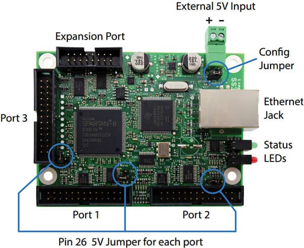

Green circuit board with various components and labels on a white background featuring ports and Spartan-6 LX9 FPGA chip.
A basic motion control card, like a Smoothstepper, can generate pulses 40x faster than most Windows parallel ports...

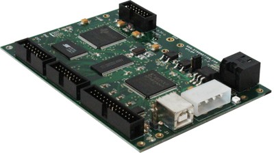

Green circuit board with microprocessor, memory chips, and USB ports on a light gray background.
Dynomotion: KLFLOP motion control board has powerful DSP capabilities on board.  It also has its own G-code interpreter so you need not use Mach3, or you can use their plugin and run with Mach3.
Warp9TD: Smoothstepper motion control board.

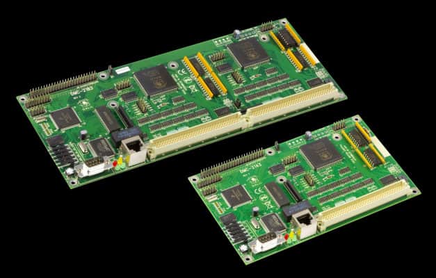

Two green circuit boards with yellow wires and black chips against a gray background.
Galil: Galil motion control boards have been around a long time, have available Mach3 plugins, and are higher end alternatives.  I've personally seen a Galil card work well with Mach3 to make molds for a carbon fiber project.  Be sure to check Galil's application notes to see which of their products are Mach3 compatible.
