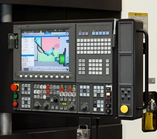

It turns out the idea that an industrial grade CNC controller can’t be built on top of Windows is false. We know that because there are many successful industrial CNC controls that are built on Windows. Okuma’s THINC®-OSP control is Windows-based, for example.  They tout their resulting open architecture as a big advantage, and THINC-OSP even lets you install apps as a result of its Windows underpinnings.

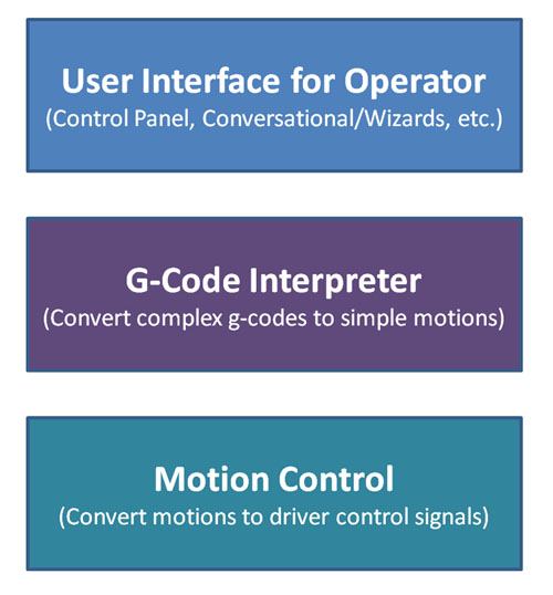

The key answer to getting industrial-grade CNC Control performance is that controls must separate the functions of low level motion control from the user interface and g-code interpreter. Look at a CNC controller as consisting of 3 layers:
CNC Controller Block Diagram
3 layers of function separation for CNC Controllers…
At the top level is the human interface, the part that talks to the operator through the control panel. The middle level is the g-code interpreter. Give it a block of g-code (uploaded by the User Interface through a USB key, serial feed, FTP, or other means), and it knows how to convert that g-code into simple motions.

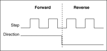

Those simple motions go to the motion control portion of the program which is responsible for converting the simple motions into driver control signals. For example, if you want the machine to move to X0Y0Z0 and the machine is at X1Y0Z0, the X-axis has to move -1 to get to 0. Let’s say your machine moves in 0.0005″ steps. It then has to move 1 / 0.0005 = 2000 steps in the correct direction.
To accomplish that, the Motion Control portion of the Controller sends 2000 steps to the hardware driver for the servo or stepper motor on the X-axis.  At the same time, it must also control the direction line so the motor spins either clockwise or counterclockwise, as desired:
stepdir
Motion Control must generate step and direction pulses to send to the controller…
An additional wrinkle is that the faster we want the axis to move, the faster the 2000 pulses have to be sent to the step pin of the stepper or servo driver.  If we run Mach3 through a parallel port, it’s cheap and cheerful, but the faster the axis needs to move, the more we are expecting from the software.
