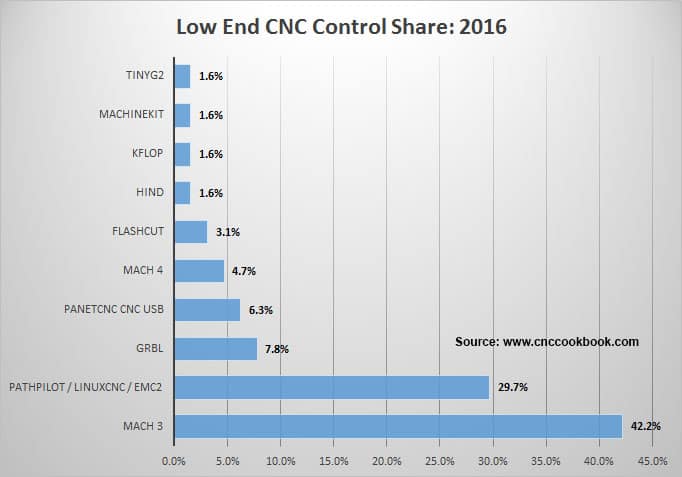

Low End Market Share
If we break down the relative share of the Low End CNC Controls, here is what we see:
Low End CNC Market Share
Low End CNC Control Market Share…

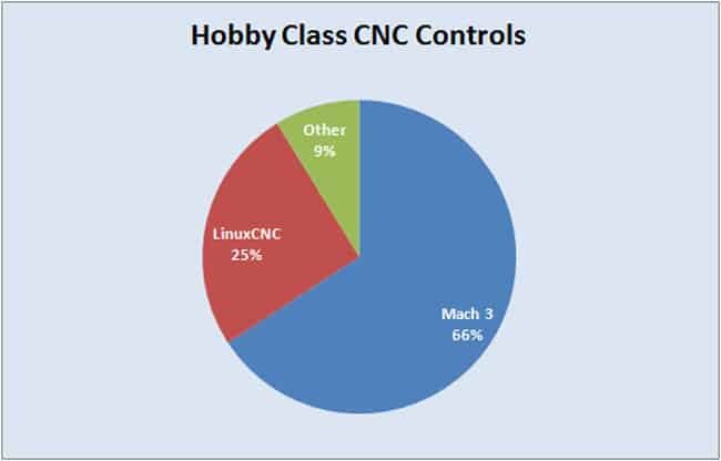

For comparison, here are the 2012 results:
2012 Results for Comparison…

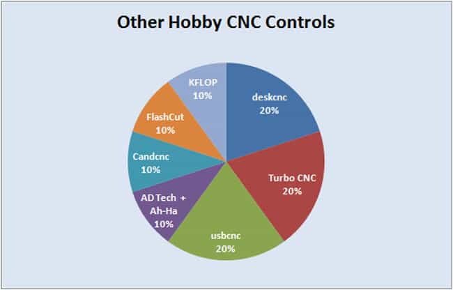

The 2012 “Other” Category, broken down…
There’s been some serious shifting going on!
First, while Mach3 remains the leader, it has lost about 1/3 of its share–that’s quite a large dip.  The LinuxCNC world is responsible for taking some of that share, having gone from 25% to not quite 30%.  GRBL, CNC USB, Mach 4, and FlashCut have also taken bites out of Mach 3 and grown their shares.
We can speculate on the cause of some of this.  Certainly Tormach’s decision to switch from using Mach3 to PathPilot/LinuxCNC had a big impact.  That’s been relatively recent, having happened last year.  We don’t have any detail on exactly when these market share changes took place between 2012 and now, but if Tormach did play a role in such a short time it suggests further deterioration in Mach3’s share could be rapid.
It’s also clear that the new controls that don’t require PC’s such as GRBL are taking share rapidly too.  Mach4 also accounts for some share loss and to a degree, it mitigates the loss of Mach3 share.  However, it’s pretty late to the game and doesn’t look to be growing all that rapidly.
I also have to wonder if the advent of Low End Affordable CNC that is ready to go hasn’t really slowed down the DIY CNC market that Mach3 played so successfully in for years.  It’s gotten tough to save money building a CNC when already built machines and kits are available at such good prices.

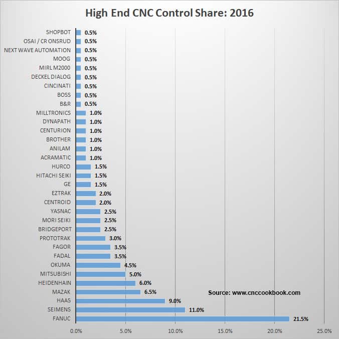

High End CNC Control Market Share
Here are the High End Control numbers:
CNC Control Fanuc Siemens Haas Mazak Market Share
High End CNC Control Market Share for 2016…
Just looking at the Top 5 from 2016 and 2012, we see the following trends:
  • Fanuc was #1 both surveys, but went from 26% in 2012 to 21.5% in 2016.  They’re losing a little share there.
  • Haas was #2 with 14% share in 2012 but has fallen behind Siemens in 2016 who took 11% share this year.  Clearly Haas is losing some share too, and Siemens more than double their share (it was just 5% in 2012).
  • Heidenhain fell from #3 in 2012 (9% share) to #5 in 2016 (6% share).
  • Mazak grew tremendously from a fraction of a % share in 2012 to the #4 position and 6.5% share in 2016.
  • Mitsubishi is about the same in both surveys percentage wise–they grew from 4% to 5%.
As for the rest, Centroid fell off from 4th place and 6% to 14th and 2% share.  I have seen a lot of inexpensive Siemens controls on the market lately and wonder if they’re displacing Centroid in the retrofit market?
Okuma is up quite a lot while Fadal and Fagor are basically unchanged.
What’s it all mean?
Hard to say.  Some of it reflects real control share changes, some reflects growing popularity of machines that carry particular controls, and some is just not obvious.
