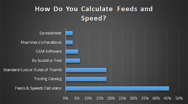

How Do Machinists Calculate Cutting Feeds and Speeds?
We surveyed our readers to ask experienced CNC'ers what the hardest CNC concepts and techiques to learn were, and here's what they said:
Bar graph showing percentage of respondents finding various CNC aspects difficult to learn.
Feeds and Speeds are the hardest thing to learn in CNC...
The answer, by a wide margin, was that Feeds and Speeds are the hardest thing to learn in CNC.  This Guide is here to make that learning curve much easier for you!
For starters, it’s worth asking, “How do machinists determine Feeds and Speeds?” We surveyed our readership and here’s what they said:
Machining methods for calculating feeds and speeds.
There are a number of approaches:
– You can build or borrow a spreadsheet.  This is the least popular for reasons I’ll discuss.  Basically, it’s a lot of work for a lot of limitations.
– About the same number use Machinery’s Handbook.  It’s pretty antiquated, especially for CNC applications.
– Amazingly few use their CAM software, even though most CAM has provision for it.  The reason is simple, and we uncovered in our CAM Software surveys.  Most CAM software does a truly lousy job with feeds and speeds.  It’s pretty easy for you to do better.
– You can rely on sound or feel.  This requires quite a lot of experience and even though it has its devotees, it basically doesn’t work.  If it did, you could buy "ear training" CD's for machinists and Boeing would require you to pass a feeds and speeds by ear audio test before they would hire you.  None of that happens because you can only hear really bad feeds and speeds.  You can't hear somewhat bad and you sure can't tell the difference between ok and really awesome feeds and speeds.
– You can rely on standard cuts that have worked in the past or rules of thumb.  This method is pretty popular, but it sure is limiting.  After all, are all of the pockets you cut the same depth?  There are variances in every job and if you're locked into just a few standard cuts, you're missing out on the possibilities.  BTW, one of the reasons CAM does such a lousy job is it takes the approach of databasing standard cuts.  Every job is different.
– You can rely on data from the Tooling Catalog feeds and speeds chart.  That data is important, but used by itself, it’s also loaded with limitations.  For example, a feeds and speeds chart is a 2 dimensional table.  It can only cover 2 variables.  Our G-Wizard Feeds and Speeds Calculator covers 60 variables!  When was the last time you looked through 30 charts to figure out Cnc Metal Cutting Feeds And Speeds?  You basically can't do it, which is why:
– By far the most popular option is to use a Feeds & Speeds Calculator such as our G-Wizard. If you're ready to accept a Feeds and Speeds Calculator and want to move on and learn other things, click here.  If you want to know more about other options, keep reading.

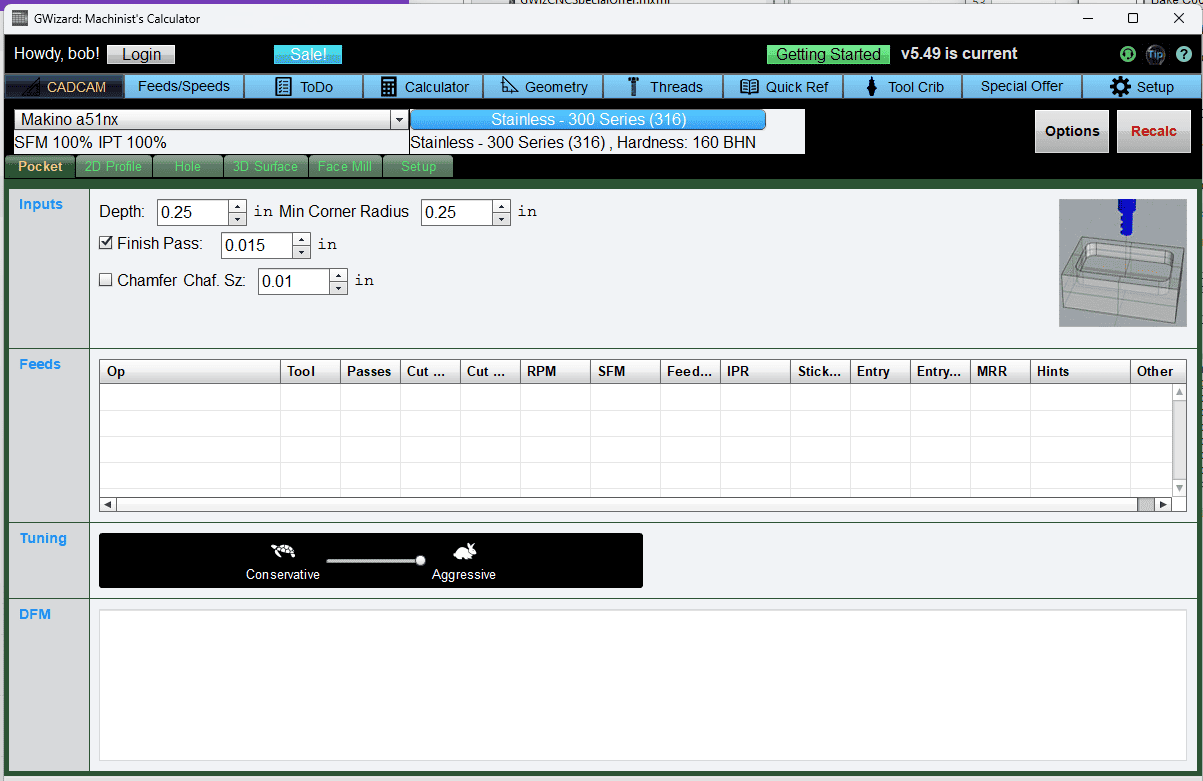

There are remedies for this. G-Wizard, for example, considers a lot of manufacturer’s recommendations in an apples to apples match up (i.e. same coatings and geometries). It then does some very sophisticated number crunching to try to separate out the fact from the fiction. In other words, it tries to determine whether a manufacturer is overly aggressive (great MRR, lower tool life) or overly conservative (great tool life, lower MRR) to get to some “balanced” numbers. It does this by analyzing a minimum of 3 manufacturers for uncommonly used tools and 12-15 for commonly used cutting tools (e.g. endmills or twist drills). It then provides a slider that lets you configure whether you’re more interested in being conservative or aggressive:
CNC Calculator with fields for feed rates, surface speeds, and metal cutting parameters
The G-Wizard Gas Pedal or “Tortoise-Hare” Slider…
We call this feature the “Gas Pedal”, and it is depicted by a tortoise and a hare, much like the old Bridgeport manual mills had for speed control. I’ll talk more about how to use the Gas Pedal and how to think about how aggressive you want to be in the article “Toolroom vs Manufacturing Feeds and Speeds“, which is the next article after this one.
Being able to make your own choices about whether to be conservative or aggressive is useful, but here is the real way to think about calculators and other machinist’s software: It’s all about how many variables you can master.

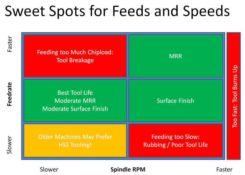

The “Speeds” portion of the Feeds and Speeds combo refers to your spindle Speed (rpm). Determining the correct Speeds for a job is largely a question of determining how fast the cutting tool can be spun without overheating it in the workpiece material you’re cutting. Once a tool overheats, it softens (well short of melting), and this causes the sharp edge to dull. It doesn’t have to get very dull before the cutting tool is done. If you keep going with a dull edge, you’re likely to break the tool, but you’ll see a very deteriorated surface finish before that happens.
In a series of experiments performed early on in machining, it was determined that your spindle speed is the biggest determiner of your tool’s life. Running too fast generates excess heat (there are others ways to generate heat too), which softens the tool and ultimately allows the edge to dull. We’ll talk more in our series about how to maximize tool life, but for now, consider your spindle speed to be largely about maximizing tool life.
“Feeds” refers to the feed rate, in some linear unit per minute (inches per minute or mm per minute depending on whether you’re using the Metric or Imperial system). Feed rate is all about the tradeoff between maximizing your material removal rate and being able to extract chips from the cut. Material removal rate is how fast in cubic units your mill is making chips–the faster the better for most machinists, right up until it creates problems. The most common problem is cutting tool breakage or chipping when you feed too quickly.  When that happens, the chips jam up in the flutes and pretty soon the cutter breaks.
I’m a Beginner, How About if I Just Run the CNC Machine Super Slow?
It’s a common mis-conception that you can “baby” the cut in order to be ultra conservative. Just run the spindle speed super slow and the feed rate slow too and you won’t break anything, right?
Well, not exactly. Here’s some examples of what can happen if you run too slowly:
– If you reduce your spindle speed too much relative to the feed rate, you’re forcing the flutes of your cutter to slice off too much material. The endmill is being pushed too fast into the cut and the chips get too big. You can easily break a cutter this way.
– If you reduce your feed rate too much relative to spindle speed, you will soon cause your cutter flutes to start “rubbing” or “burnishing” the workpiece instead of shearing or cutting chips. Many machinists will tell you the fastest way to dull a cutter is just to run it with the spindle reversed and make a pass, but having too slow a feed rate creates a similar effect. We’ll talk more about how this happens in the Feeds and Speeds article, but suffice it to say that running too slow is just as hard on your cutters as running them too fast, if not harder.
Incidentally, "chip load" is a commonly used intermediate value for feed rate.  The chip load is the actual thickness of the chips your cutting edge slices off.
The Sweet Spot for Feeds and Speeds
Yes! That’s exactly right, there is a Sweet Spot for every cutting operation.
It’s not a point that has to be hit exactly, but at the same time, it is not very large either, and there are penalties if you miss it completely. The more difficult the workpiece material you’re cutting, the smaller the sweet spot and the greater the penalties.
Once you know where the Sweet Spot is, you can tweak your cutting parameters within that envelope to maximize Material Removal Rates, Surface Finish, or Tool Life. In fact, you can often maximize any two of the three, just not all three at once. Let’s take a look at the sweet spots for different things, as well as the danger zones: Feeds and Speeds chart with four quadrants illustrating optimal machining conditions. This chart is relative, meaning you can’t assume anything about the proportions or scale. Just look at the positions of the regions relative to one another, and relative to the idea of faster and slower spindle speeds and feed rates.
Let’s consider the different labeled zones, left to right, top to bottom:
Feeding too Much Chip load As we’ve discussed, when you feed too fast for a given spindle speed (rpm), you’re likely to break the cutting tool. The more you exceed the appropriate speed, the more likely. At some point, you’ll always break the tool. Consider the absurd case where spindle speed (rpm) is zero and you rapid the tool into the work. Pop! Just broke another tool.
MRR:Running the spindle as fast as we can without burning the tool, and feeding as fast as we can without breaking the cutting tool is the sweet spot for maximum material removal rates. If you’re manufacturing, this is where you make money by getting further up and to the right than the competition.
Too Fast: Too much spindle speed will generate excess heat which softens the cutting tool and dulls it faster. There are exceptions and mitigating circumstances we’ll talk about in more advanced installments.
Best Tool Life: Slowing down the spindle a bit and feeding at slightly less than appropriate for maximum MRR gives the best tool life. We’ll talk more below about Taylor’s equations for tool life, but suffice it to say that reducing the spindle speed (rpm) is more important than reducing the feed rate, but both will help.
Surface Finish : Reducing your feed rates while keeping the spindle speed up lightens the chip load and leads to a nicer surface finish. There are limits, the biggest of which is that you’ll eventually lighten the feed rate too much, your cutting tools will start to rub, and tool life will go way down due to the excess heat generated by the rubbing.
Older Machines: So your spindle speed has come way down, and in addition, so has your feed rate. You’re probably on an older cnc machine where you can’t run the kind of speeds you need to take advantage of carbide tooling. You may need to switch to HSS.
It comes as a surprise to many that there are areas of the feeds and speeds envelope where HSS can outperform carbide, but it’s true, depending on your cnc machine’s capabilities and the material you’re cutting. Check the article “Is Carbide Always Faster than HSS” for more information.
Feeding Too Slow: What happens if feed rate is too low?  As discussed, feeding too slow leads to rubbing instead of cutting, which can radically shorten your tool life and is to be avoided.  Poor tool life with too slow feed rates is caused by rubbing and potential work hardening if the material is susceptible to it.
Now that you know how the sweet spots break down, you’ll have a better idea how to steer your feeds and speeds to the desired results.
I always find it’s easier to remember concepts with a visual, so hopefully the Sweet Spot diagram will make it easier for you too.  Go ahead and print it out and tape it up somewhere prominent in your shop if it helps further.

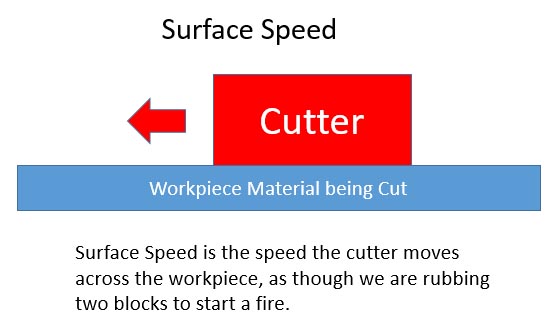

Surface Speed: How Fast the Tool Slides Against the Workpiece While Cutting
You'll come across the term "Surface Speed" pretty quickly because we use it to determine the right spindle rpm.  You may also hear Surface Speed referred to as "Cutting Speed".
When specifying the specifications of a cutting tool, surface speed goes hand in hand with chip load. Just as chip load is a better way to talk about cnc feed rate because it is independent of so many factors, surface speed is a better way to talk about spindle rpm. Imagine that instead of a rotating cylinder with cutting edges, your cutting tool was a flat piece of metal slid against the workpiece. The recommended speed to slide when cutting is the surface speed.
Here’s the visual:
A graphic illustrating surface speed in machining, featuring a red rectangle with white "Cutter" text and an arrow pointing left.
Visualizing Surface Speed…
Surface speed is measured in linear units per minute: feet per minute (SFM) for Imperial, and meters per minute in Metric.
The faster the Surface Speed, the more heat that's generated.  So, the optimum is about matching the amount of heat generated by a specific cutting tool and material to the requirements of the cutting tool.  Carbide will withstand a lot more heat than HSS tooling, so it runs at higher surface speeds.
You can’t really cheat on Surface Speed. It is what it is and exceeding the manufacturer’s recommendations is sure to reduce tool life fairly drastically except for some very special HSM (High Speed Machining) cases you should only worry about when you’ve mastered the basics.  Running too fast overheats the cutting tool, gets it too hot, which softens the cutting tool, which makes it dull and wear out quickly.
