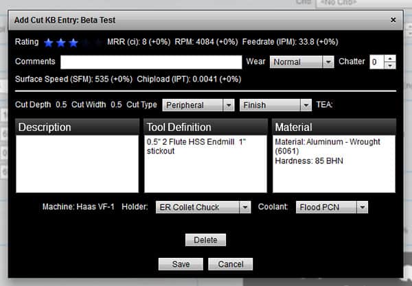

G-Wizard has a capability called “Knowledge Based Machining.” This is a capability that is reserved for the most expensive CAM packages, and most of them don’t really apply it successfully to Feeds and Speeds so much as other CAM-related issues. Think of it as teaching G-Wizard where the absolute edge of the performance envelope lies so you can take advantage of that knowledge on future jobs. The secret to Knowledge Based Machining in G-Wizard is a feature we call the Cut KB, which is short for Cut Knowledge Base. Think of it as a helpful diary in the form of a database for tracking the results you get from various Feeds and Speeds. You add an extry to the Cut KB by setting up the Feeds and Speeds in G-Wizard and then clicking the “Add to Cut KB” button at the bottom. It will pop up this screen:
Adding to the Cut KB…
What comes up is a screen that records all the important information about the cut, but it also provides you the opportunity to add subjective information:
- Overall rating with 0-5 stars
- What was the wear like? Choices are Normal, Poor, Chipped, and Broken.
- How much (if any) chatter was encountered?
- Exactly what kind of operation was being performed? Peripheral milling, pocketing, slotting, etc.
- etc.
There’s enough information being recorded to serve a lot of purposes. For example, chatter is a very reproducible phenomenon and you will see in advance if you’re choosing a combination that’s been chatter prone in the past. To use the Cut KB, simply record all your cuts and then when you have built up some data, start using the “Search Cut KB” button. After you’ve set up a cut in Feeds and Speeds, click Search Cut KB and you’ll see prior cuts that are similar. By strategically running tests that find the limits of Tool Life and Chatter, you will map out the edge of the performance envelope and see how much faster you can go than the basic Feeds and Speeds recommendations. You can customize G-Wizard further by adding correction factors to Tooling Entries in the Crib or to the Machine Profile itself. Perhaps you’ve found you never have a problem on your big Horizontal Mill if you run 5% more rpm and 15% more feedrate. Just bake that in and G-Wizard will start producing recommendations based on that. From there, the individual cut types will inform even more performance. You can often go faster peripheral milling than pocketing, for example, because chip clearing is better.
If you’re willing to invest the time, Knowledge Based Machining can unlock considerably more profit for your shop. It’s really the ultimate in Feeds and Speeds productivity, and the thing is, you don’t have to invest the time all at once. Try running a little faster on each job until you find the limits. Cut KB is the record keeping tool that makes tracking it all easy.
