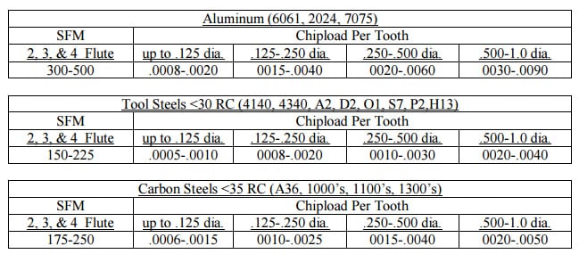

First, Look Up the Data
You should aim to retrieve the most favorable data issued by the provider for the material being cut, and the tool or insert that will be utilized. Please refer to the Tooling Catalog of the Manufacturer for this data. More often than not, a variety of figures will be presented to you. As an example, refer to these standard sets of charts provided by Lakeshore Carbide:
Typical feeds and speeds data from the Manufacturer’s catalog...
Note how most all of the numbers are in a range–300 to 500 SFM for aluminum. And the chipload is 0.002 to 0.006 for 1/2″ diameter in aluminum. We want the most aggressive numbers, so we would use 500 SFM and 0.006″ of chipload per tooth. Some catalogs may tell you to reduce these values for full slotting or some other condition–ignore all that, G-Wizard will make such adjustments automatically, and it does a much better job.

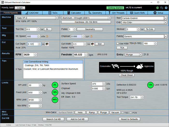

Second, Enter it Into G-Wizard
Once you have the two numbers, just enter them into G-Wizard like so:
We entered 500 SFM for Mfg’s Sfc Speed and 0.006 for Chipload…

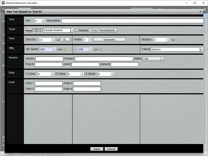

Add the Tool to a Tool Table
Once you have it in G-Wizard’s Feeds / Speeds tab, you can easily create a tool in the Tool Table.  Just press the “To Crib” button.  A popup asks you which crib to put it in, then takes you to the Tool Crib’s Tool Editing Popup so you can modify it before saving to the Crib.  Here’s what that looks like:
Looks pretty familiar, as it is based on the layout of Feeds / Speeds.
“To Crib” let’s you build up your Tool Tables on an as-needed basis, working as you go.  Pretty soon you’ll have all your most commonly used tools in a table.  But there’s an even more powerful way to capture Manufacturer’s Data that we call “Tool Famillies”.

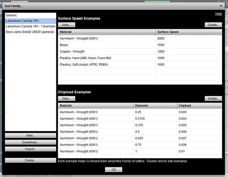

Save Your Manufacturer’s Data with Tool Families
Just to the right of where you entered the Manufacturer’s Data you’ll notice there’s a dropdown menu that says “Generic”. That’s the Tool Family menu, and you can use it to save frequently used Manufacturer’s Data. If you click the dropdown button, you get the following popup:
The Tool Families Pop Up…
Tool Families consist of Examples. You give examples for Surface Speed and Examples for Chipload. These examples are the same data you would enter in directly for the “Generic” choice, so use the guidelines at the top of this page to look them up.
The idea is that G-Wizard learns from the Examples, and it can use them to estimate specs for tools you haven’t entered any Manufacturer’s Specs on.  This can save you having to type in the whole set of numbers.  It’s a real timesaver that doesn’t exist in any other Feeds & Speeds software.
To use Family information, G-Wizard needs to have a material entry of the same material to calculate surface speed. To calculate chipload, it needs at least one example with a diameter within 25% of your target tool’s diameter. Or, it needs 2 examples, one larger than or equal to and one less than or equal to in diameter. The examples must also use the same material as the cut you have setup.
Every time you add examples and close the window, they’ll be saved so they’re available next time you need to use them. This makes it easy to enter just the examples you need for a job as you go, instead of entering those giant tables from the tooling catalogs before you can do anything.

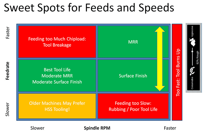

While it can be used just to “turn down the volume” on any cut that needs to be done more conservatively, the primary role of the Tortoise-Hare Slider is to select between a smoother finish for Finish Cuts (Tortoise) and a little rougher finish in order to hog out material faster (Hare).
From 0 to 29%, you’re in the Finishing Range.  From 30% to 100% you’re in the Roughing Range.  Recall our “Sweet Spot” diagram from the very first lesson:
I’ve overlaid the yellow arrow and Tortoise-Hare Slider on the Sweet Spot diagram to show you what the slider does.  In fact, the arrow is a touch diagonal, since it also will slow the spindle a bit as you move to the Tortoise end.  That’s so it is even more useful at making cuts more conservative if you have a lightweight machine or a setup that may not be as rigid as you’d like.
Here’s another tip:
Full Tortoise is set up to be the exact slowest you can go before rubbing sets in.  That’s really useful to know, because as we know, rubbing is terrible for tool life.

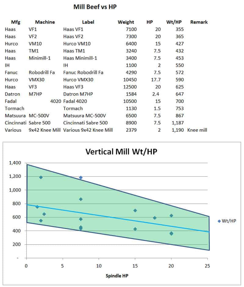

Industrial VMC’s weigh thousands of pounds yet the actual size parts they can machine may not be a lot larger than a mid-sized desktop CNC Router.  Clearly those thousands of pounds do something for the VMC that the little machine isn’t getting, and that something is machine rigidity.
Spindle Power (HP in Imperial and KW in metric) is a measure of how much power the machine has available to try to deflect the machine’s frame.  It doesn’t just go to deflection, it also goes to cutting, but let’s take the worst case here.  In the industrial world, the relationship between machine weight and spindle power is pretty predictable.  Here it is visually:
Machines fall within a pretty narrow zone…
G-Wizard uses this relationship, together with your machine’s work envelope (volume of its travels in X, Y, and Z) and weight to find an “ideal spindle power” that is right for the estimated rigidity of your machine.  If that adjusted spindle power is less than your spindle’s rated power, then it derates to the adjusted power.
