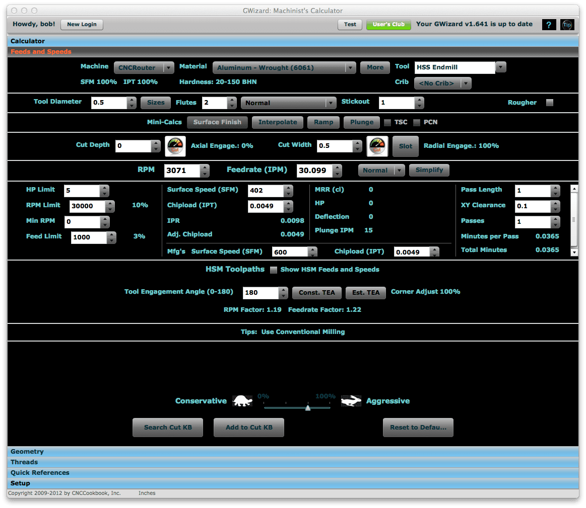

The latest release of the G-Wizard Machinist’s Calculator includes a new feature to make it even easier to use Manufacturer’s Data for your feeds and speeds calculations. Take a look at the screen shot:
G-Wizard Feeds and Speeds Calculator
Notice the new area right above the HSM Toolpath section that has the label “Mfg’s Surface Speed”. There is a place to enter chip load just to the right. Using these two fields, you can easily give G-Wizard the manufacturer’s recommended surface speed and chip load for the particular tool or cutter you are using. Previously, the only way to do this was to create or download a full custom surface speed and chip load table for the tool, which requires quite a bit more effort. Let’s look at a couple of key questions to gain a better understanding of this feature:

Given this understanding, the Manufacturer’s Data is the surface speed and chip load without considering cut conditions. The Surface Speed and Chipload shown above it reflect G-Wizard having adjusted that starting point for the cutting conditions.
How did G-Wizard operate with the manufacturer’s data before this feature was added?
If you don’t enter anything into the Manufacturer’s Data, G-Wizard uses an idealized estimate of what these should be. This estimate is arrived at by a statistical analysis of a lot of different tools that are similar. By similar, that means tools that are made of the same material, have the same coating, same number of flutes, and so on. In practice, the analysis is fairly conservative and seeks to combine data from aggressive manufacturers with that of conservative manufacturers. It works well for general purpose use, but if you’re using more premium tools, you may find you can go faster by using the manufacturer’s recommendations.
While G-Wizard does a great job for most tools, the biggest opportunity to get ahead with Manufacturer’s Data is when using indexable tooling. The reason is that there are so many different inserts available and GW just uses a “one-size-fits-all” estimate. With this new feature, just look up the recommended chip load an surface speed for your insert, put them in, and you’re good to go.
