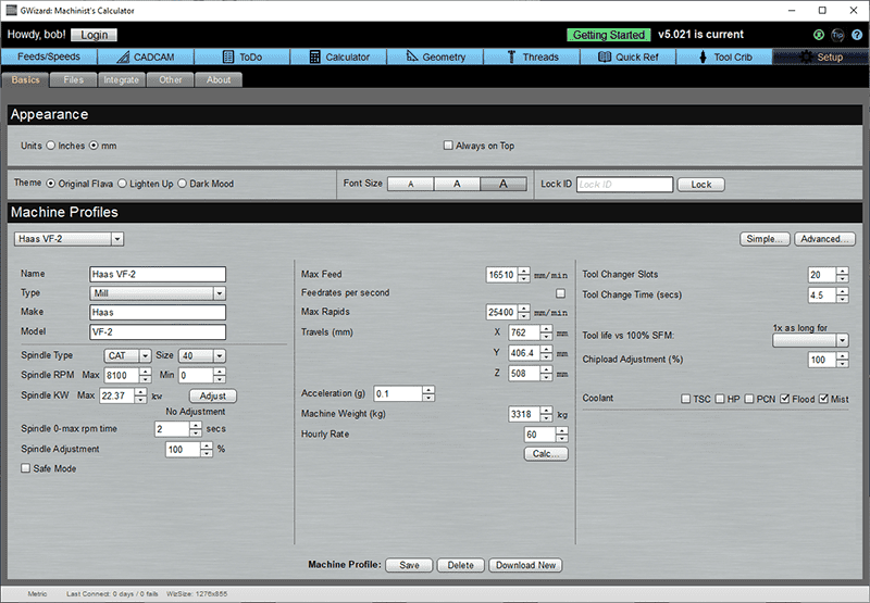

Machine Profiles Panel
Machine profiles let's you create new custom profiles for your machines.
Note the buttons next to the Machine Profile Selector:
- Simple is for creating profiles that have the minimum information needed to make G-Wizard work. Creating these profiles is quick and easy.
- Advanced is for squeezing the maximum performance out of G-Wizard. A lot more information is collected.
Here are all the different kinds of information G-Wizard can use. Most of it is on the Advanced page.
Name: Call it whatever you'd like, but keep it short
Type: Lathe or Mill. Router users should choose "Mill".
Make and Model
Spindle Type and Size: e.g. "CAT" and "40".
Max. RPM: Your spindle's maximum speed
Max. HP: The maximum horsepower your spindle will produce. G-Wizard will keep your cuts within this limit.
Coolant: What kind of coolant does your machine use?
Tool Changer Slots and Change Time: Use chip to chip for change. Calculator doesn't use this information but G-Wizard Editor does.
Max. Feed: The maximum feedrate of your machine. Sorry, G-Wizard only tracks one, so if you have different maxima on different axes, you'll have to choose one.
Max Rapids: G-Wizard Editor uses this information, for example to calculate how long it will take a program to run.
Travels: What are your machine's axis travels.
Acceleration: What is the maximum accurate acceleration of your CNC? This is used by the interpolation calculator to keep feedrate within this limit so you get an accurate hole. The number is usually determined through experimentation.
Machine Weight: This is used for Rigidity compensation by G-Wizard Calculator.
Spindle 0-max rpm time: Used by G-Wizard editor to figure program run time
Min. word time: A measure of how many blocks your controller can execute.
Coolant on/off time: Used by GWE to figure program run time
CNC Controller: Used by GWE
SFM Adjustment: The value, in percent, by which to multiply SFM. 100% will simply used G-Wizard's recommendation. 200% would double the recommendation while 50% would have it. There is also an SFM adjustment available tool by tool in the Tool Crib.
Tool Life Estimate: The biggest contributor to Tool Life is surface speed, according to Taylor's Tool Life Equation. This line tells you the contribution your SFM Adjustment makes to Tool Life. In the screen shot, setting SFM to 80% results in 6x longer tool life. You can get crazy with it. Setting it to 10% predicts 100 million x longer life. You should take 100 million as the tool will last a LOT longer! Because the numbers get silly after a while, I limit the results to be no more than 1000 times longer life.
Chipload Adjustment: The value, in percent, by which to multiply chipload. There is also a chipload adjustment available tool by tool in the Tool Crib.
Safe Mode: Turning on Safe Mode enables extra margins for error for beginners to greatly reduce the risk of breaking a tool. See this video for more on Safe Mode.
G-Wizard remembers all the profiles you create. It also remembers the profile you last selected in the Feeds and Speeds calculator and brings that up each time you restart G-Wizard.
Editing a Profile
To edit a profile, select it with the "Machine" dropdown menu, change whatever fields you like below, and press "Save".
Creating a New Profile
A new profile is created any time you change "Name" to a name that didn't exist before and press "Save".
Deleting a Profile
To edit a profile, select it with the "Machine" dropdown menu, change whatever fields you like below, and press "Delete Machine".
Warning: You can't get it back and there is no "Undo"!
Reverting to the Default Profiles
To revert to the default profiles, press "Reset".
Warning: This deletes any new profiles you may have created!

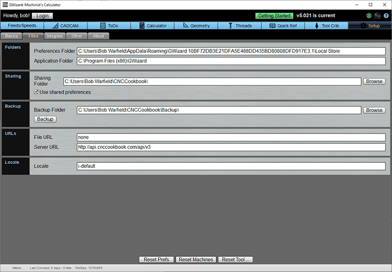

Files Tab
The files tab shows you the directory where the various preferences and setup files are located:
Backing Up Your Preferences and Moving to a New Machine
Use the Browse button on the Backup row to indicate the folder where you want the backup to be copied. Click the Backup button to copy the files.
Or, just point your file explorer at the Preferences Folder and copy everything in it. Remember, if you are running Shared Preferences, you need to back up the shared folder too.
Taking a backup is a good way to capture all your settings when you get ready to move G-Wizard to a new machine.
Just install G-Wizard on the new machine, then copy your backups into the folders the new G-Wizard shows.
Shared Preferences
Whether sharing between multiple users in a shop, or multiple G-Wizard apps (why re-enter your machine and tool data for G-Wizard Editor and Estimator?), Shared Preferences will save you time.
To set up Shared Preferences, go to the Setup tab and then select the Files tab.
Scan down to the bar that is titled “Sharing”. You have two options:
- You can tell it which folder to use. By default, it will select the “CNCCookbook” subfolder off your main documents directory.
- You can turn sharing on and off with the check box.

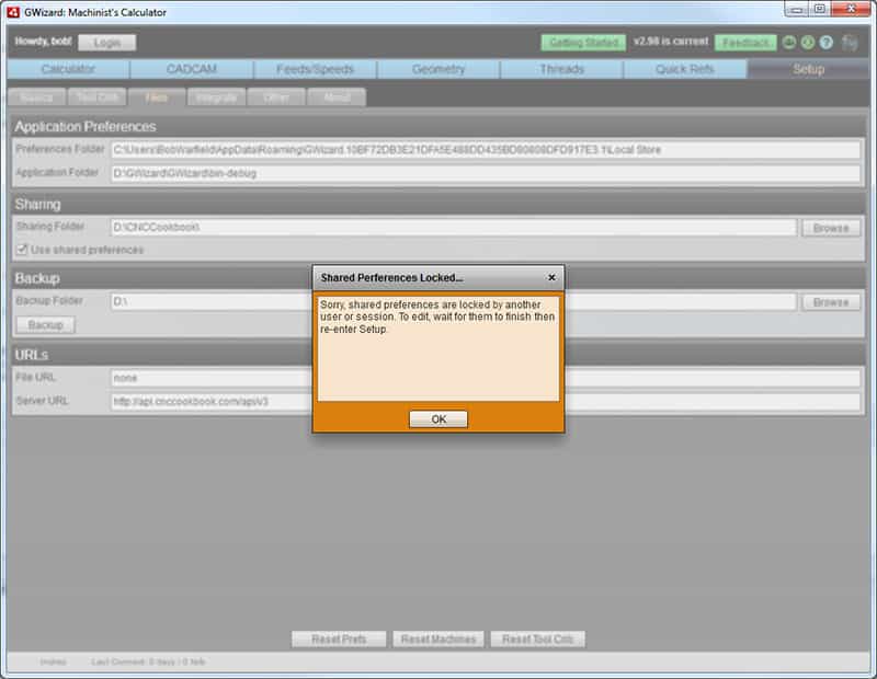

First thing, is that any G-Wizard product that has Sharing turned on will always load the latest version of the Shared Preferences at startup and then whenever you go into the Setup tab. It won’t load them otherwise, so if you need to be sure you have the latest, visit the Setup tab on your machine.
Next, whenever you go into the Setup tab, it attempts to lock any Shared Preferences so that you are the only one who can change those settings. This prevents collisions when multiple users try to change things at the same time. If you go into Setup and someone is already editing the Shared Preferences, you’ll see this:
Shared Preferences are Locked!
Like the message says, “shared preferences are locked by another user or session.” What you have to do is come back later by exiting and re-entering Setup after the other user finishes. You can look around if you like, but you can’t edit the locked preferences.

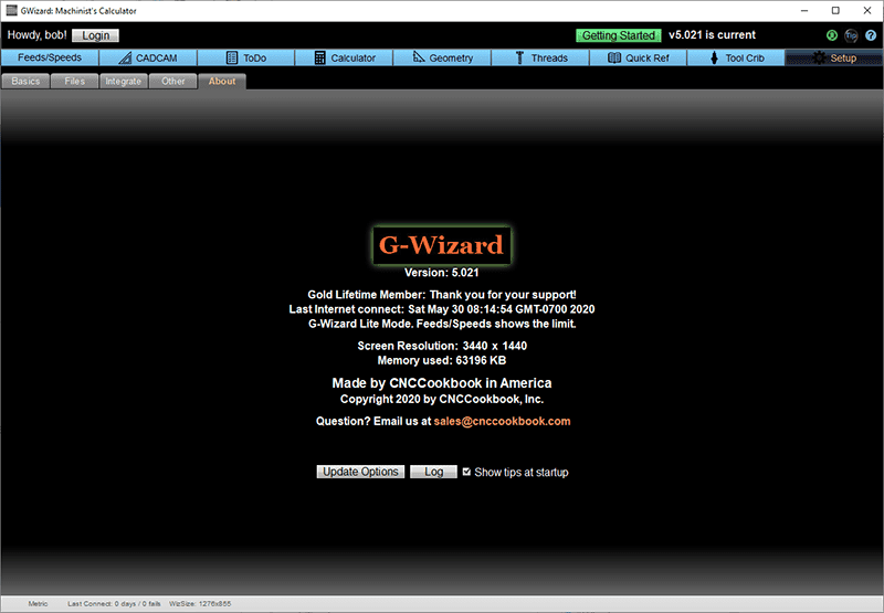

About Tab
Here's a typical About Tab:
As you can see, it shows your subscription status (Gold Lifetime Member), the last time the Internet was reachable (you must connect every 28 days), Screen Resolution, Memory used, copyright notice, our email for questions, and some options.
The options let you decide how often you want G-Wizard to update, whether to show tips at startup, and there is an option to view the error log that's for our use if you're having problems.
