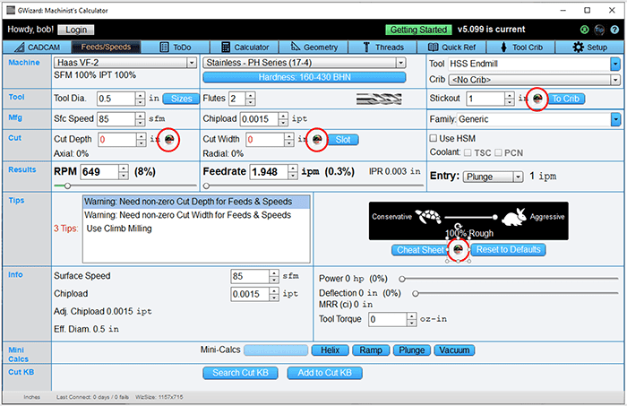

Check out this screen shot of the Feeds / Speeds tab:
The Cut Optimizer is activated by an icon that looks like a little speedometer.  I have circled them in red on the above diagram.
Using Cut Optimizer is simplicity.  Just click the icon next to the value you want to optimize and Cut Optimizer will find the largest value for that parameter that does not trigger a Deflection Warning.  No popups or further interaction required.  Just one click.
For example, let’s suppose you know you need to do some slotting. Press the “Slot” button to set the Cut Width to be the tool diameter. Then press the Cut Optimizer button next to Cut Depth. This causes the Optimizer to figure the maximum Cut Depth that’s possible while slotting. Or, choose a depth, perhaps because you’d like to cut a pocket at full depth in one pass. Then press the Cut Optimizer button next to Cut Width and the Optimizer will tell you the maximum Cut Width (stepover) that can be used within deflection limits.
