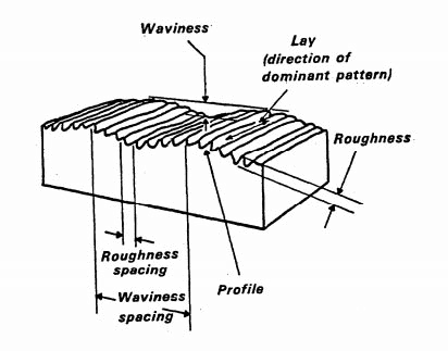

Understand How Surface Finish Will Be Measured
If your concern for surface finish is based on the requirements placed on a particular part, understand how the Surface Finish will be measured. Which Surface Finish Measurement system will be used–RA, RZ, or some other? The link will take you to our page on Surface Finish Measurement which will help you understand the ins and outs of these systems as well as provide handy conversion between the different systems.

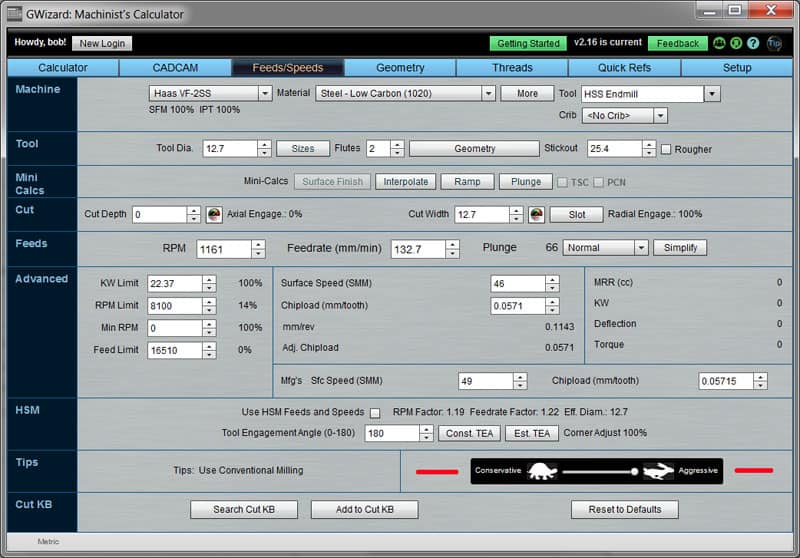

Use the Right Feeds and Speeds
It’s absolutely critical to have the right feeds and speeds for finishing work–no guessing!
Use a proper feeds and speeds calculator like G-Wizard–most finish work needs to take radial chip thinning, ballnose compensation, and a host of other sophisticated factors into account.
Keep the rpms up where surface speed says they should be and back off the feedrate for a finer finish. G-Wizard has its “Tortoise and Hare” slider to do this adjustment. Move it all the way left. That’s its special “Fine Finish” setting which puts the chip load as close to rubbing as you want to go for best possible finish.
Move the Tortoise and Hare slider all the way left when finishing…
Don’t allow the chip load to go too low or you’ll be rubbing the tooling instead of taking clean cuts.  In general, the Tortoise-Hare slider provides a tradeoff between quality of finish and how fast it removes material when roughing.

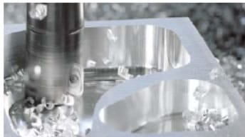

Clear the Chips!
Chips down in the work will scratch it up as your cutter slides them around in the hole. With work hardening materials like stainless, you may as well scatter a handful of hardened steel chips to scratch up your work.
Use your coolant or air blast to get the chips completely out of the way of the hole. Hurco calls this out as one of the first and most important things to attend to in order to improve your surface finish.
Keep the chips clear so they won’t scratch the workpiece or dull your cutter…
The chips won’t clear of their own accord, although the tendency for gravity to help the process along is one reason horizontal mills can be more productive than vertical mills (or lathes too for that matter). Either Flood Coolant or an air blast with mist if needed will do the job if properly set up. See our article on the role of coolant for more.

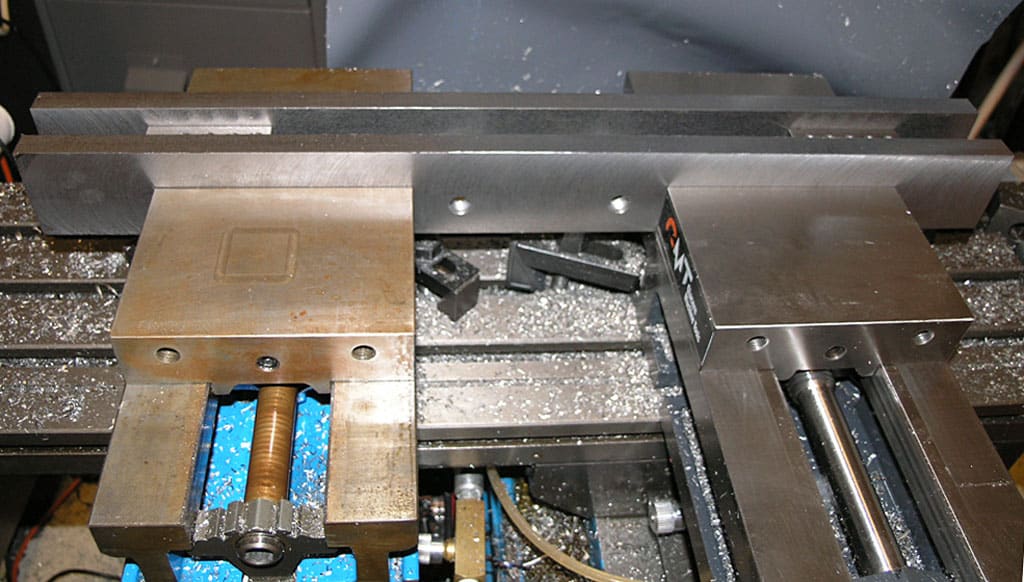

Use the Most Rigid Possible Workholding
Rigidity in all areas is key to a fine surface finish and any vibration of flex is going to be bad for your surface finish.
The primary impact of workholding on surface finish is vibration. In the worst case vibration will turn into chatter, which is a harmonic effect that will be very visible in your surface finish. Clearly, the more solid you can make your workholding, the less likelihood of vibration there will be.
Make sure your workpiece is supported and clamped over as much area as possible surrounding the cut while still leaving room for the cutter to get in there and do its job. Remember that as you are removing material during the machining process, you are in some sense weakening the workpiece. You may weaken it to the extent that the vise or other workholding fixtures can start to deform the part.

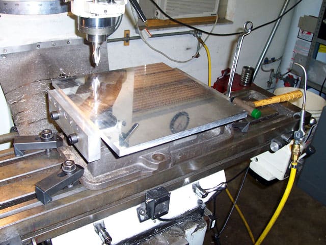

For example, suppose you’ve firmly clamped a relatively thin piece of aluminum plate flat in the vise. You intend to machine away the middle so it’s like a picture frame. The initial slotting pass may relieve enough material that the slot pinches against the cutter with poor results.
Plates are some of the most difficult pieces to machine because they often want to vibrate like gongs. The thinner and more poorly supported the plate, the greater the tendency. Here are some things to consider when machining plates:
– Glue the plate to a subplate with super glue. It releases with heat (careful, the fumes are toxic!) when done. You can also use double sided tape and various commercial products for machinists that are intended for the purpose. Jeweler’s wax (sometimes called “Dop Wax”) is also good for securing parts as is hot glue. For all of these adhesives, make sure they will stand up to your coolant!

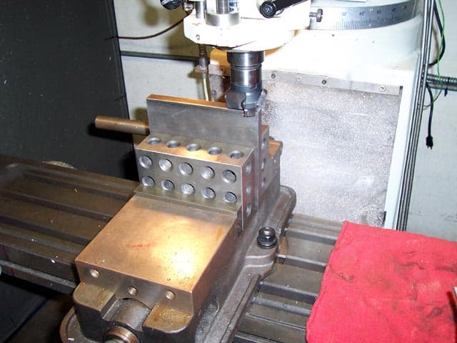

– If you stand a plate on end in the machinist vise or other fixture in order to machine the edge, support the plate as much as possible up to the edge. A pair of 2-4-6 blocks make a great strengthening sandwich around a plate standing on end:
Providing a little extra support for the plate with 2-4-6 blocks…
– Move the vise jaws to the outside so the plate is supported in the middle by the vise:
– In general, keep the unsupported workpiece overhang as little as possible for all machining operations.
– Make a set of “Vise Jaws of Doom” as I did to support long workpieces with two vises:

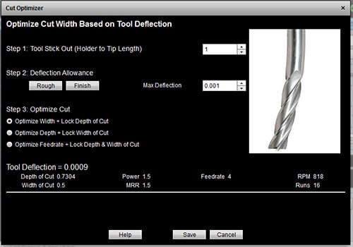

Minimize Deflection and Chatter, Maximize Tool Rigidity
You can’t get good surface finish if your tool is deflecting excessively or chattering. You’ll see every bit of that in the finish on the cut sidewalls.
Minimize tool deflection for best surface finish and to minimize chatter!
A tool that is deflecting wants to act like a tuning fork. It will neither leave a good surface finish, nor be accurate. How much deflection is too much? Ingersoll’s ballnose catalog talks about just one thousandth of an inch leading to a chatter-prone tool. It’s surprising how easy it is to get that little bit of deflection with small diameter or long reach tooling. In fact, the ratio of diameter to length of the tool is a great place to start talking about reducing deflection.
Reducing length to diameter ratio by 25% makes the tool more than twice as stiff so it deflects less than half as much. Deflection is directly proportional to length to the third power (a tool twice as long will deflect 2*2*2 = 8 times as much, all other things being equal!) and inversely proportional to diameter to the fourth power (a tool half the diameter will deflect 2*2*2*2 or 16 times more, all other things being equal!). In other words, use the shortest, fattest tooling possible.
Rather than worry about all those estimates, use G-Wizard Calculator not only to figure your tool deflection, but to help you choose the optimal parameters to minimize deflection:
Use G-Wizard Calculator to Optimize Away Tool Deflection…
Consider a toolchange between roughing and finishing. Instead of using the largest tool that fits the smallest radius of the tool path, use an even larger tool for roughing and let the finishing pass deal with the smaller radii. Roughing is where you’re hogging the deep chatter-prone cuts anyway.
Never use a longer tool than necessary. Any length more than 3x the tool’s diameter starts to be chatter-prone and by 5x you’re wishing for all the help you can get to control the chatter.
Choke up the tool in the chuck as much as you can to reduce stickout.
By the way, the part of the endmill that is fluted is weaker than the solid shank. Use the shortest possible endmills with the shortest possible fluted lengths for maximum rigidity.
Solid carbide cutters are much more rigid than HSS cutters. Hence, even if you’re not running them at flat out carbide speeds, they may still produce a better finish. This will be especially true for longer reaches, smaller diameters, and so forth. Incidentally, carbide generally takes a smaller chip load than HSS, but it runs at so much higher rpm that it still comes out ahead.
Use G-Wizard’s Cut Optimizer to minimize deflection, avoid chatter on finish passes, and do what you can to increase rigidity and minimize vibration of any kind. Chatter is the worst kind of vibration and will be very visible in the finish. Check out our chapter on chatter for more tips on how to get rid of it. Our G-Wizard Calculator even has a chatter calculator to help you determine the optimal spindle rpms to minimize chatter:

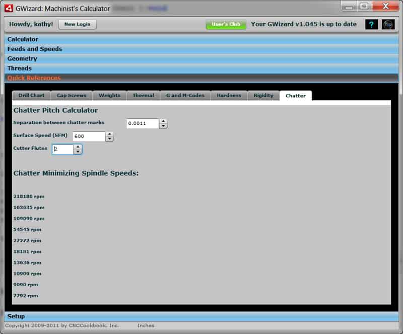

G-Wizard includes a Chatter Pitch Calculator that can give you optimal spindle rpms to minimize chatter…

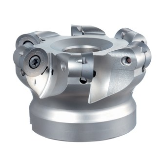

Surface Finish With Facemills
Facemills are a staple for most shops. They’re great for squaring blocks and facing large areas. Here are some things to keep in mind when facemilling:
– One of the challenges for surface finish when face milling is that each insert differs in cut depth by just a little bit–they’re not all cutting at exactly the same depth. More expensive facemills let you adjust each insert individually. If you can get them adjusted to a couple tenths or less, finish will be greatly improved. Failing that, try a flycutter. A big adjustable flycutter can cover the most territory in the fewest passes, and will often leave the most pleasing finish. However, you can convert even a regular facemill into a flycutter simply by removing all but one insert.
– The best efficiency occurs when 2/3’s of the facemill engages the workpiece at a time (67% stepover). This also results in a better surface finish. Full engagement of the cutter keeps the forces on either side of the centerline fighting each other (leads to vibration) as well as starting chips out at zero thickness. Chip formation should start thick and end thin for best surface finish. See the note below on Entering the workpiece (“rolling in”) for more on starting thick and ending thin.
Climb mill with this 2/3’s cut ratio. Conventional milling with a face mill causes the chip to start out thin, which sometimes leads to rubbing at the outset of chip formation that is bad for surface finish and can lead to BUE. The best finishes start the chip out fat and then thin it out before the chip releases.
– Take a light cut when finishing: 0.003 – 0.010″
– Keep an eye on the horsepower required for your cut. Facemilling uses a lot of it with surprisingly low depth of cut because the cutter is so wide. A wide cutter relative to the workpiece produces a more pleasing finish (fewer “mow” bands), but too much horsepower can be injected into the cut and will lead to vibration problems. Your horsepower used (or a load meter on your VMC) is telling you how much of this tendency there is.
– Roll into cuts with a face mill as described below under Toolpath Considerations.
– If you don’t need a square shoulder, a 45 degree lead angle facemill will often leave a better finish than a 90 degree. Chips are also about 30 percent thinner versus a 90 degree facemill so faster feedrates are possible.
– Where surface finish is the major consideration, use the extra sharp finishing inserts, they make a big difference.
– Recutting or back cutting occurs when the surface that was already cut is cut again by the back edge of the facemill. A perfectly trammed machine cuts on the leading edge only, but perfection only occurs in theory. Slight tramming errors and deflection can make back cutting a reality, and it usually results in a poorer finish. Some machinists will put their machines very slightly out of tram so that the cut is always made on the leading edge of the path. This also helps to prevent chips being dragged around the circumference of the cut which further degrades the finish. Obviously you’d only want to cut travelling in one direction as well. The bias in tram needs to be very slight lest the angle cutter create scallops that are too pronounced. Larger diameter cutters will magnify the scalloping effect.
– “Wiper” inserts can be used to great effect for improved surface finish. A wiper is a flat ground on the insert. It cuts with the leading edge of the flat (which is parallel to the workpiece) and then the “wiper” burnishes the work as it passes underneath. The width of this wiper flat must be greater than the advance per revolution to allow the cutting edges to overlap. Spindle tilt such as was discussed around back cutting is critical when using wipers. Due to the sharp ends on the insert, excessive spindle tilt can cause dig-in.

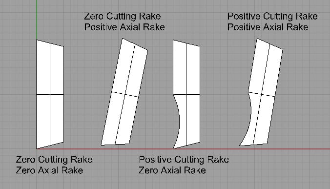

Use Sharp Inserts, Lead Angle, and Positive Rake
All things considered, sharper inserts, more lead angle, and positive rake all lead to better surface finish. A 45 degree face mill produces a much nicer finish than a 90 degree square shoulder face mill.
Positive rake cutting geometries will typically require lower cutting forces (resulting in less deflection), and they will produce a finer surface finish. The positive geometry bites into the material’s shear planes with less force.
– Prefer sharper inserts. These are often more expensive ground inserts rather than pressed or molded inserts.

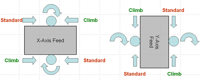

Climb vs Conventional Milling: Assume Nothing About Which is Best for Finish
This is a complex topic. Climb milling reduces cutting forces and ordinarily that would be the best answer for finish. But, climb deflects into the wall and conventional does not. Read our Climb vs Conventional Milling Page to decide which will be best for your needs.
Climb vs Conventional Milling…

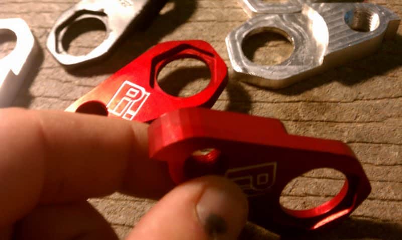

The Truth About “Mirror” Finishes
Anyone who frequents the machining boards online has seen countless threads where someone is asking after how to get a “mirror” finish from their mill or lathe.
While it is easier to come close on a lathe, the truth about mirror finishes is that they largely do not exist.
Yes, there are machine tools capable of doing optical quality finishes. These are extremely rigid machines that largely use diamond tooling. But, those are not the machines most of us will have access to, and they are not the machines most people are talking about as they ask after a mirror finish.
Have you ever noticed how most photographs of a so-called mirror finish have the workpiece tilted at an extreme angle? Have you ever seen the highway mirage where it looks like there is a pool of water on the road far ahead of you that vanishes as you get closer? Same principle. Even asphalt will apparently have a “mirror” finish (that water you saw in the mirage was a reflection of the sky) if the angle of incidence is right.
Ask to see the mirror finish looking straight down on the part and you’ll see more clearly what these finishes are all about.
This is not to say that a fine milled finish cannot be extremely attractive, its just that it doesn’t really look like a mirror when viewed straight on. The tooling marks will still be visible, but they will be extremely faint grooves. In the best case, you’ll see rainbows created by diffraction effects acting on the grooves. It’s a look that has been called “prismatic”. The closest thing to it is the back of a CD where all the rainbows are, but the milled finish will be a more subtle effect.
That’s what you’re looking for to decide you have achieved a great finish. If you need to do better, it’s time to go to some abrasives of some kind and either user vibratory polish or a buffing wheel.
