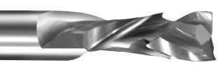

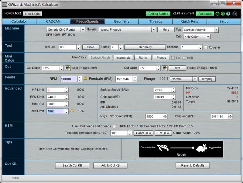

Let’s say we’re going to cut some laminate with a compression spiral cutter.  These cutters push the chips to the center to reduce the chipping on either the top or the bottom of the sheet material.  For Plywood, Vortex is quoting a chip load of 0.021-0.023″ for a 1/2″ diameter cutter.  And, while they don’t mention a surface speed, they say per the quote above to use 10,000 to 20,000 rpms.  Our first problem is to figure out a surface speed.  We can use G-Wizard to reverse engineer that value.  Here’s how I’d do that:
ReverseEngiSFM
Reverse Engineering Surface Speed from a recommended RPM…
This is pretty simple to do.  I selected “Plywood”, a “Carbide Endmill”, set my tool diameter (0.5″) and flutes.  Then, this is important, I chose a modest Cut Depth, 1/2 a diameter, so GW wouldn’t fool around adjusting other things too much, and a slot.  Lastly, I entered the mfg’s recommended rpm, and I just chose the top of the range or 20,000 rpm.  You could choose the middle if you like, but GW is good at adjusting these values for cut conditions.  Now we can read the Surface Speed for the cut as being 2618 SFM (right there below the Feedrate).

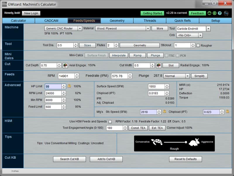

Now we have everything we need to properly set up for G-Wizard using Manufacturer’s Recommended Data.  Let’s try it on a little fancier cut.  Let’s use this 1/2″ compression spiral and cut some shapes in 3/4″ Plywood.  Here’s the Feeds and Speeds:
PlyCut
Notice how I put 2618 SFM and 0.023″ into the Mfg’s Sfc Speed and Chipload entries, respectively.  That’s how I’m telling G-Wizard about this particular tool’s performance envelope as advertised by the manufacturer.  Whenever you use a premium cutter, it’s worth checking the Mfg’s Recommended Data as you may get more performance than just going with the defaults.  In this case, we’re maxing out the 15HP spindle by running 12775 rpm at a feedrate of 493 IPM.  That cutter is going to be flying through the plywood and G-Wizard has dialed things down to a limit of 14.8 HP to avoid stalling the spindle.  It’s interesting to note how it did that dialing back.  A lot of times the Tooling Reps just tell you to bury it and go full bore–“Sure it’ll take all that and more.”  But this is the Real World and we’re buying not selling cutters.  G-Wizard recognizes and accounts for a number of things in this cut:
1.  We’re about 1 x Diameter deep.  Chips need a place to go or they build up and can break the cutter.  The deeper the whole, the harder it is to evacuate the chips.
2.  We’re also doing a full slot.  The more of the circumference of the cutter is working on cutting, the harder it is to fling those chips out into space.  Once again, if they build up too much we can break the cutter.  A slot is very difficult–half the cutter is actively chewing at the material.  Corners can be worse, and straight plunges are the absolute worst.  Note the plunge feedrate is dramatically less (247 IPM) than the straight slotting feedrate (493 IPM).  So G-Wizard took the depth and width of cut and figured it had better derate the chip load from 0.023″ to 0.0193″.
3.  With this cut, we are right at the limits of Spindle Horsepower.  In fact, the reason the “HP” area and the “HP Limit” are red is because G-Wizard’s first try exceeded our horsepower limit.  The spindle would stall in that case and you’d probably break a cutter.  So it has to pull back somehow.  G-Wizard’s first choice on the pullback is spindle rpms.  The reason is that you get a lot of tool life benefit from fairly modest rpm decreases due to something called “Taylor’s Tool Life Equations”.  So it’s going to dial back on spindle to a preset limit (point of diminishing returns) to see if that will work.  Once it hits that limit on rpm pullback, it’ll try to reduce the feedrate.  There’s a limit here too–if we reduce it too much the cutter will start to plow and rub.  In any event, GW has done its pull backs and now we have a workable cut that will maximize tool life while giving us as much Material Removal Rate as our spindle horsepower can deliver.
What would the cut have looked like with a more powerful spindle?  Easy enough to answer, just override the HP Limit like this:
BigHPPlyCut
That’s quite a cut–over 17 HP, 14901 RPM, and 575 IPM feedrate!
Now we can see exactly how G-Wizard derated for the spindle power limitations.  G-Wizard considers over 50 variables when making its calculations.  It’s not always obvious exactly how they interact, and that’s a good thing.  It’s hard to impossible to grasp how 50 different variables are interacting with one another in the human mind.  I let G-Wizard worry about it, and you can too.  Grab our free 30-day trial and check try G-Wizard Calculator for yourself.
