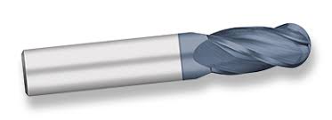

A Ball Nose End Mill, also called a "Ball Cutter", "Ball End Mill", or a "Ball Nose Mill" is an End Mill whose tip is ground in the shape of a half sphere. Ball End Mills are always center cutting, so they can cut everywhere on the ball.  We can think of them as a special case of corner radius endmills, where the corner radius is as big as it can be.
They can be single end or double end. They can be made from solid carbide or high speed steel and are available with coatings. They're available with a full selection of number of flutes, based on their intended material.
They can be used used for milling a large corner radius, grooving with a full radius, and contour or profile milling. The smaller diameters can be used for engraving. Their primary application is in 3D semi-finishing and finishing operations for industries like Mold & Dies.

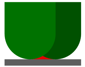

Ballnoses create scallops whose size depends on the diameter of the ballnose, the depth of cut, and the stepover between successive passes:
Green shield icon with red blood drop.
Ballnose Scallops are shown in red…
A moment spent looking at the image above illustrates a connection between scallop height and the stepover value- increase one and the other increases as well. In the images below we’ll use a stepover equal to 1/10, 1/5, and 1/3 of the tool diameter to show this correlation. To put real numbers on this, that would be equavalent to a .012, .025, and .042″ stepover for a .125″ ball mill.

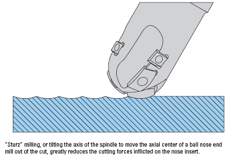

Sturz Milling: Ball Nose Milling With a Tilt Angle
The ball nose has a weakness, which is that the closer you get to the tip, the slower the flutes are spinning. It sounds counter-intuitive, but just think of that tip as a series of concentric circles at different heights. The ones near the tip are smaller circles, their circumference is shorter, yet they’re spinning at exactly the same rpm as the bigger circles up higher. Hence, the tip moves slower. Conceptually, the exact tip isn’t really moving at all as it is a circle with zero radius.
This observation leads to a clever technique called “Sturz Milling”. With this technique, you use the 4th axis to allow the ballnose to be presented to the workpiece at an angle, so the side of the ball is used more than the tip:
Milling process diagram illustrating Sturz milling technique.
Not only does this allow faster milling (higher feedrates are possible) but it gives a better surface finish and even improves tool life.
