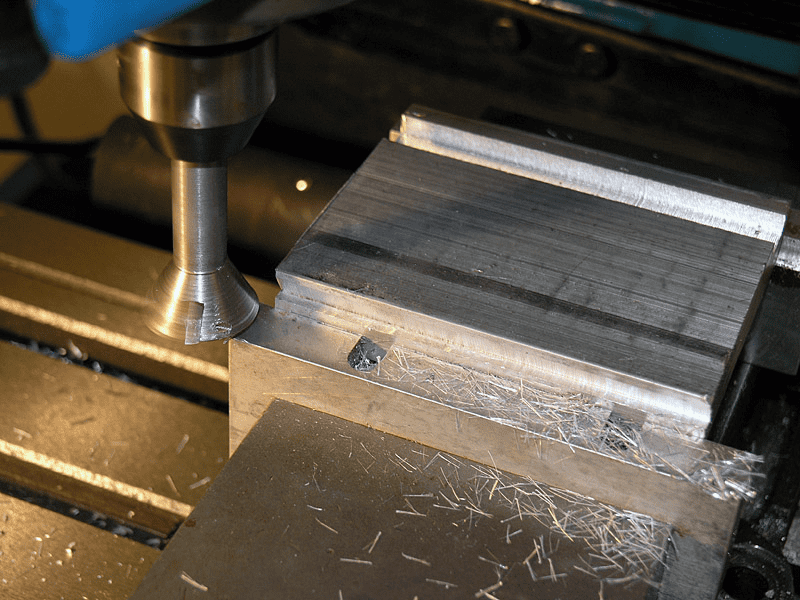

It’s also easier than you’d think to make your own indexable tooling.  Here’s a dovetail cutter I made that uses TPGB inserts:
TPGB dovetail cutter goes to work…
I made it in just a few hours on my manual mill and lathe before I had CNC.  With CNC, it would be even faster to make one.
