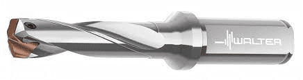

Understanding Indexable Insert Drills
Indexable insert drills, known for their versatility in general, plunge, and stack drilling applications, have become an outstanding choice for a range of drilling tasks. With their diameter varying from 15 – 160 mm (.590 – 6.299 inch) in many lines of indexable insert drills, they offer a wide range of sizes to choose from.
But what sets them apart? The answer lies in their enhanced productivity, superior hole quality, and extended tool life, all made possible by their unique design and modern technology.
Components of an Indexable Drill
At the heart of an indexable drill are two primary components: the tool body and the inserts. The tool body, the backbone of the drill, provides the requisite support and stability.
The inserts, on the other hand, are the workhorses. They are the cutting components that make drilling possible. Together, they form a partnership that brings precision and efficiency to the drilling process.

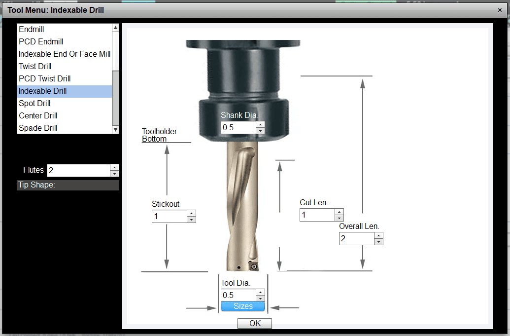

Insert Drill Speeds and Feeds
Our G-Wizard Feeds and Speeds Calculator is capable of delivering numbers for Insert Drills. First, set the tool type to be an Indexable Drill:
Be sure to enter all the geometry parameters. Since the range of inserts that are available is huge, you’ll want to also fill in the Manufacturer’s Recommended Chipload and Surface Speed for the insert drill.
