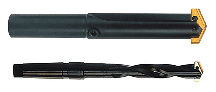

Spade Blade Holders
Spade Blade Holders come in a variety of styles:
- Straight Flute vs Helical Flute
- Different Overall Length will control the maximum drill depth
- Different Diameter Ranges
- Optional through-spindle coolant
Your shop will probably settle on a flute style and whether to invest in through-spindle coolant. After that, it primarily comes down to keeping an inventory of different spade blade holder overall length for various maximum drill depth and holders in each length for each diameter range. Most shops will buy spade drills on an as-needed basis.

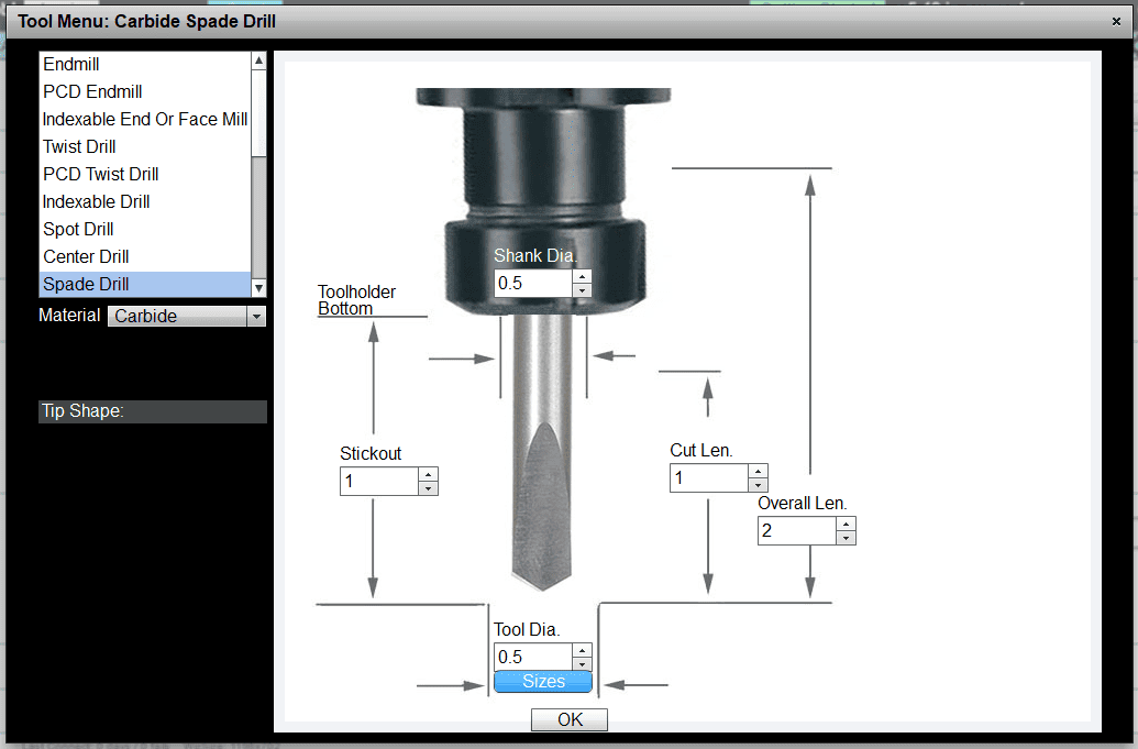

Spade Drill Speeds and Feeds Calculator
The significance of drilling speed when employing spade bits is to avoid overheating and blunting of the bit, and to create a neat hole.
Our G-Wizard Speeds and Feeds Calculator can compute proper Speeds and Feed Rates for Spade Drill Bits in a variety of materials.
[ Get G-Wizard Feeds and Speeds Calculator ]
Selecting a carbide spade drill in G-Wizard:
