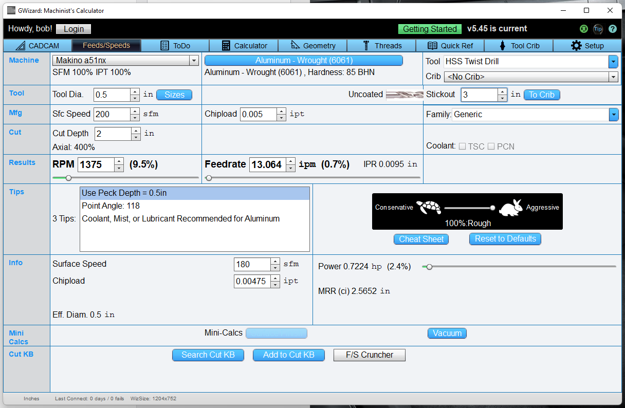

Here are the G-Wizard feeds and speeds for a 1/2″ HSS twist drill going 2″ deep in 6061 aluminum:
Regular Twist Drill feeds and speeds…

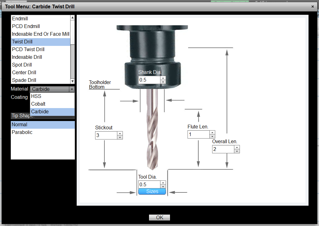

The Material Removal Rate is 2.57 cubic inches per minute. Now, let’s try that same hole with a Carbide Drill. To change, click the Tool button:
Just select “Carbide” from the Material menu…

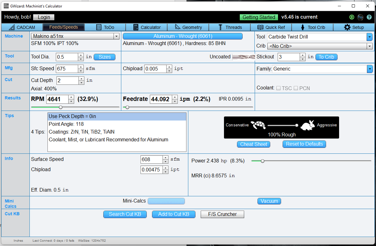

Here are the feeds and speeds with a Carbide Drill:
The MRR goes from 2.57 to 8.66 cubic inches per minute with a Carbide drill.
