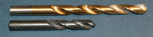

Screw machine length twist drills are much shorter, so they’re less likely to flex as well.  In general, you’ll save a lot of time if you can avoid spot drilling.  Investing in a set of screw machine length twist drills is well worth it.  I hardly ever use the jobber length bits.
Screw machine-length twist drills are shorter and more rigid than jobber length.  They don’t need to be spot drilled.

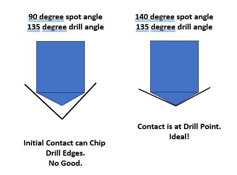

One other factor to consider is Drill Bit Angle.  The larger the angle, the more likely the tip is to wander.  So, for example, if you use a 135 degree angle, you may want to consider spot drilling.  This is particularly true if you have ground a split point on your 135 degree drill bit.

A lot of machinists use center drills for spotting instead of true spotting drills.  Center drills are intended to be used to create a hole suitable for a lathe center.  They have a 2 part tip that has a small pilot as well as the larger countersinking area of the bit.  While center drills are available more cheaply than spot drills, they have some disadvantages.  The small pilot tip is very delicate for example, and if it breaks, the drill will quit cutting.  Not a happy thing if you’re running a job that involves spotting a lot of holes.  Another problem is the hole angle of a center drill is typically 60 degrees.  When spotting, you want an angle that is larger than the twist drill’s angle if possible.  The narrower the spot angle, the more near the outside diameter of the twist drill first contact will be.  If the twist drill’s flutes aren’t perfectly sharpened, one will contact the spot hole before the other and the drill will try to deflect.  This defeats the purpose of spot drilling and can result in a less accurate hole.  The broader angle of a true spot drill means the tip of the twist drill cuts first, which makes for a more accurate hole.  Lastly, the web of a spot drill is typically thinner than a center drill, so it cuts more easily and with less heat.

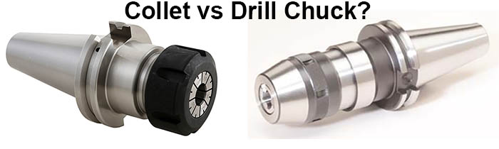

The choice of whether to use a Drill Chuck or Collet Chuck for a Spot Drill or any other Twist Drill is a divided one, because we’re optimizing two parameters and there is a different choice for each.
For best accuracy, use a collet chuck for your spot drill and twist drills.  Traditional drill chucks are less accurate and setscrew endmill holders are worse.
However, for holding power, the drill chuck is the winner.  Here’s why:
  • The Drill chuck concentrates its grip in 3 places.  That grip is so powerful, it often marrs the shank of the twist drill if the metal isn’t hard enough to resist.  A Collet, by contrast, spreads the force evenly 360 degrees around the shank.  You can easily see why that leads to less grip.
  • The internal workings of drill chucks use wedges to create significant mechanical advantage when tightened.  This leads to a lot more gripping force than a collet achieves.
In the end, I recommend using the collets for smaller drills, say 1/4″ and under, and the drill chucks for larger diameters that need more holding power.

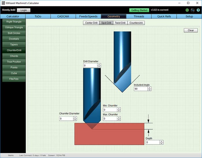

  • If you’re going to do all these cool tricks with a spot drill, you’re going to need to do some geometry calculations.  Fear not, our G-Wizard Calculator has some awesome tools to help:
spot drill geometry calculator
Calculating depths versus diameters for various sizes…

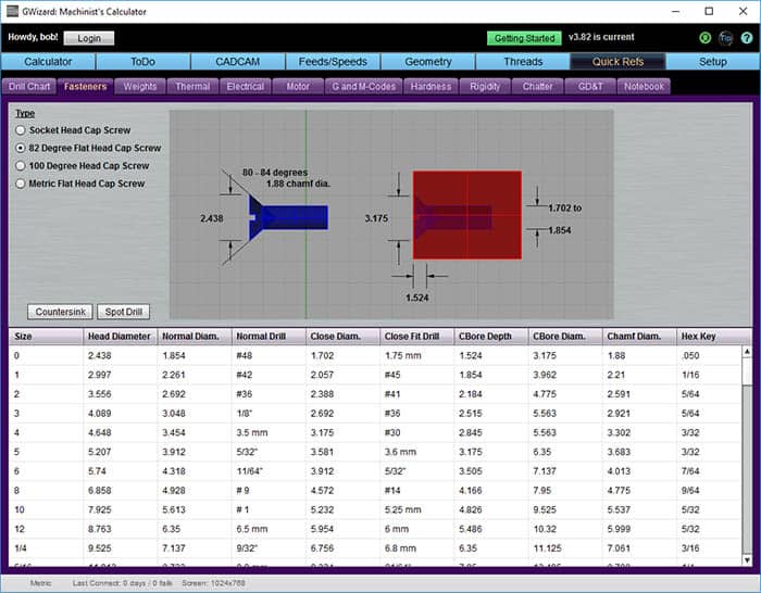

The Calculator covers spot drills, center drills, counter bores, and more.  Plus, there’s even a database of fastener counterbore sizes:
flat head cap screw dimensions
