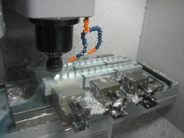

Use Double Vises to Double the Capacity of a Setup
The more vises you can get on your mill table, the more parts you can machine in a single setup. Double vises raise the ante another notch by letting one vise act as 2. Here are 3 double vises on a Haas Mini Mill:
3 double vises = 6x the capacity of 1 vise!
Looks like he has 4 parts in each of the end vise jaws and 5 in the middle vise for a total of (4 + 4 + 5) *2 = 26 parts per setup!

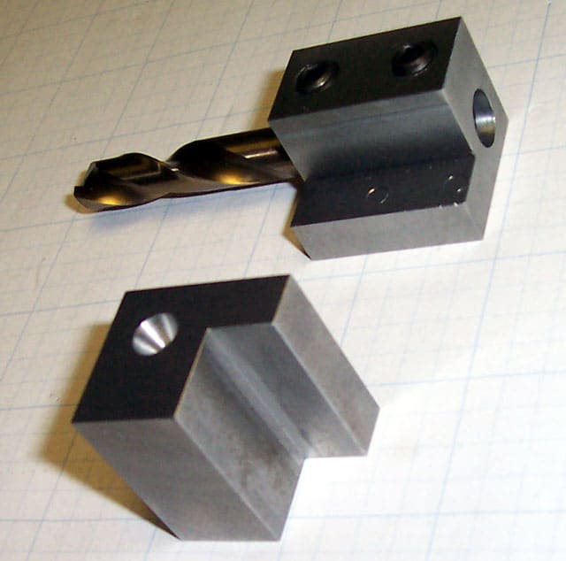

Quit Drilling With Your Tailstock in the Lathe
Widgitmaster made up these nifty drill holders that will fit in a QCTP holder:
He’s got one with a chuck in it too. These just slide into a regular QCTP toolholder which is then clamped down on it. I’ve seen some chucks built into the full dovetail toolholder. One nice thing about this approach is you can set the cutting depth relative to the QCTP by sliding this holder and locking it down at the right spot. This would allow a series of tools to be aligned to the same depth and a carriage stop used to make repeatable production with a set of tools easy.
One thing about using the QCTP to hold these is you will have to dial them into the center of the workpiece. Widgit claims this is a more accurate way to drill holes on the lathe assume you do dial everything in. Of course with CNC, you can likely come up with a way to get the thing dialed in once and then have it be repeatable. Faster than dialing into the center is to put a precision pin in the lathe chuck and use that pin to align the drill chuck on that center. Note that spot with your DRO!
