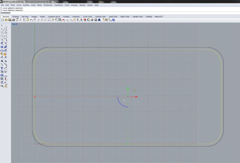

Once you get your hands on the document describing your device’s dimensions, you’ll need to put together a CAD drawing that captures the outline of the phone:
Using your CAD program, generate the outline of your phone…
I’m using Rhino3D for this project, but most any CAD program capable of 3D modelling can be used to follow along. I simply created a rectangle with the overall height and width of the phone (leaving out the buttons that protrude). I then filleted the corners to the appropriate radius. That yields the yellow outline–very easy!
The next question you’ll have to decide is how thick to make your case. For this project, I wanted a case that would not add bulk to the already svelte iPhone, and that would make it easy to operate the phone’s controls through openings in the case. So, I chose to make the case 1.5mm thick. To do that, I simply offset the inner outline by 1.5mm. All decent CAD software will have the ability to offset a line like that.

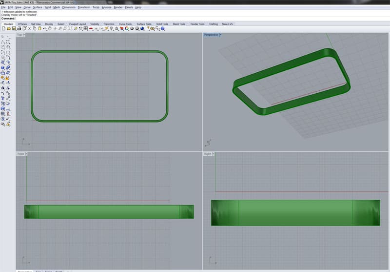

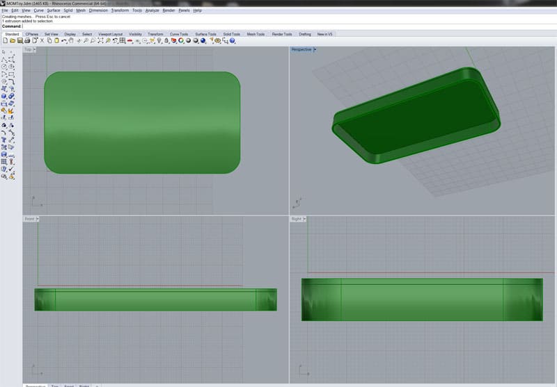

Now I have the basic outline of the case. Time to start converting it into a 3D model. In Rhino, I simply extrude that outline to the some height. This creates the sides of the case:
Phone case sides…
Then I extrude the outer line in the opposite direction for 1.5mm to create the bottom of the case:
Case with bottom added…

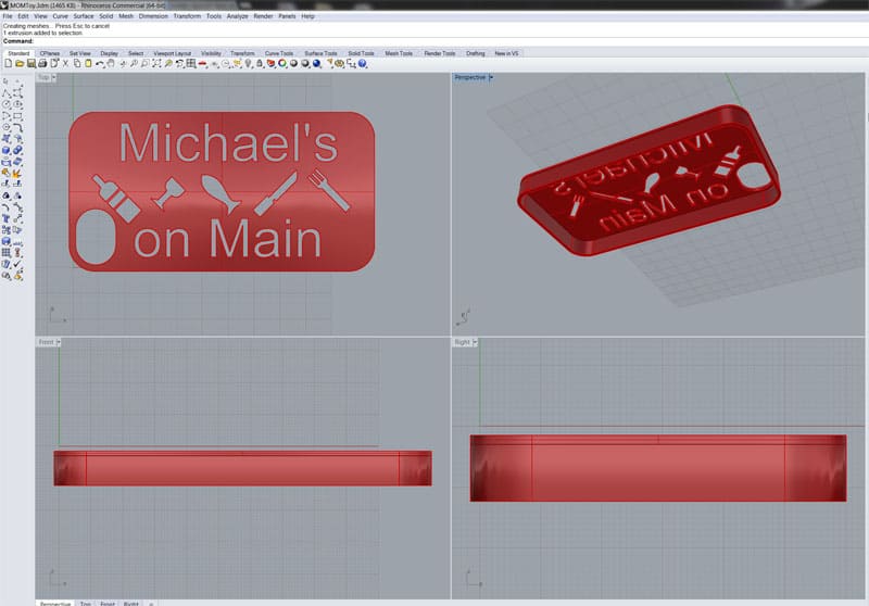

You’ll notice I drew the case face down. That’s because the personalization I want to do goes on the back of the case, and I wanted to make that part easy on myself. What I decided on was to create a custom logo’d case for a close friend who owns a local restuarant. I’ve been a Guest Chef there a number of times and I wanted to give him something fun from my world of CNC. There are a variety of things you could do to customize a case like this, but I decided to keep it simple. My task was to create cutouts in the case that create a logo of his restaurant. The finished 3D model looks like this:
Finished 3D Model of a custom phone case…

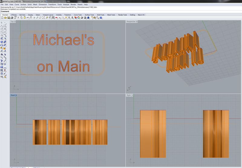

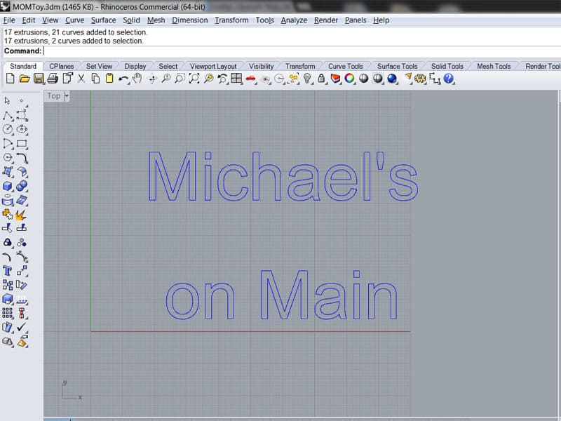

As you can see, this case is an exercise in making a cutout on the back of the case that looks like line art. The first task in doing that is to create the line art:
Text Outlines…
I started with a text outline. I positioned it above the bottom of the case in the Z dimension, and then I extruded it downward:
Extruding the text…

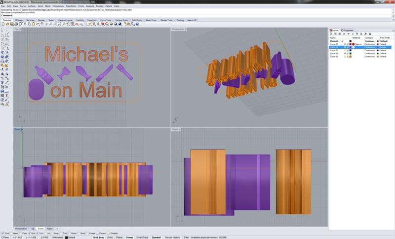

Using a similar process, I created the icons of wine bottle, glass, knife, fork, and fish:
The extruded cookie cutter for the design…
Think of these extrusions as a “Cookie Cutter” that can be used to cut the design out of the back of the case. You’ll notice I added a shape for the camera cutout to make sure it wouldn’t interfere with my design.

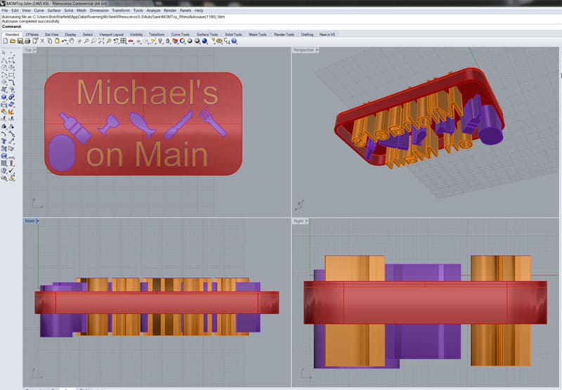

Once I had the Cookie Cutter, I used Rhino’s Boolean Difference operation on the solids to cut the design out of the back of the case:
Subtract the Cookie Cutter from the case using a Boolean Difference…
