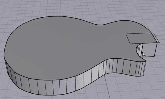

First, we extrude to get to the thickness the finished body should be. You can choose whatever you’d like, but I chose to use the standard thickness of 2″.
Here’s the outline after extrusion:
Here’s the 3D model after extruding the body 2″ thick…

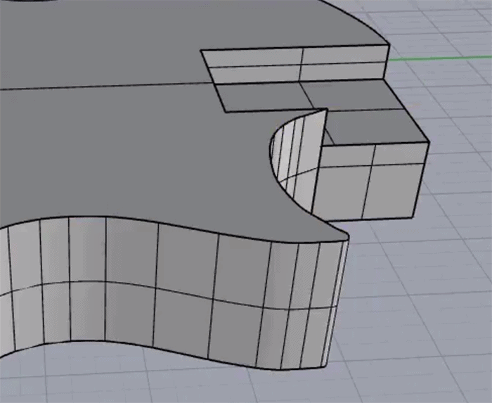

Now we need to cut away the neck pocket.
This is easily done in 3D models by using what are called “Boolean Operations” between two solid models. Suffice it to say, I can “subtract” one object from another.
I extrude the rectangular outline of the next pocket to create a proper object to subtract with. The depth of the neck pocket on these guitars is 5/8″, and that dimension is again something that’s easy to look up on the web.
Here’s the result after the Boolean Difference subtracts the two:
After Boolean Difference, we have a neck pocket…
You can clearly see how Boolean difference subtracted the template object and left behind a perfect neck pocket.

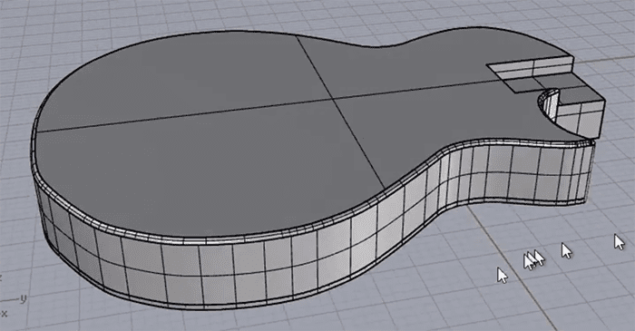

Putting a radius (or chamfer) on an edge is a pretty standard operation in most CAD software, and here’s how it looks when we’re done:
Radiused edges…
Note that we don’t want to radius every edge, some want to be sharp-edged, such as most of the neck pocket edges. Be sure to think that through for your guitar design.

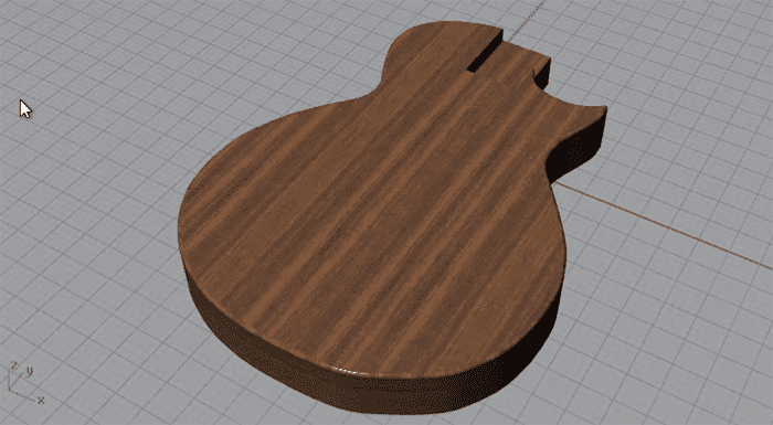

Great CAD software includes a rendering capability so you can see a more realistic rendering of your 3D model than the abstract views you use when creating the models.
Creating a rendering can be as simply as picking from a list of pre-defined materials that the model is made off, which is what we’ll do here. But it can also get much more complex, involving backgrounds and defining what sort of lighting is to be used to illuminate the rendering. A good 3D rendering can look very realistic–more like a photo than a computer generated graphic.
Here’s what our simple rendering looks like on our simple guitar body:
Simulated walnut rendering…
