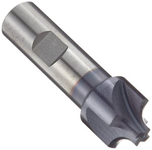

With G-Wizard Calculator version 3.45, we now have support for Corner Rounding End Mills:
Corner Rounding End Mills: New Cutter Type

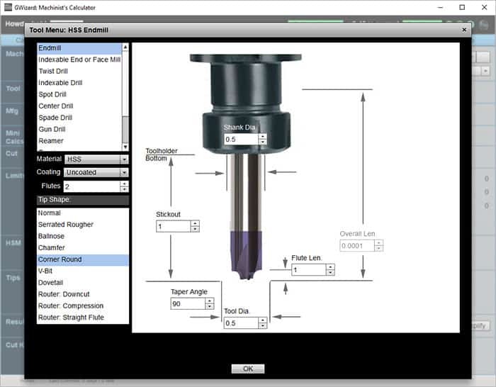

Corner Rounding Endmills are super-easy to use. Just select them as a geometry type from the basic Endmill tool. Be sure to enter the flute length (which is also the arc radius). That's all there is to it. You can let G-Wizard take the Feeds and Speeds from there.
