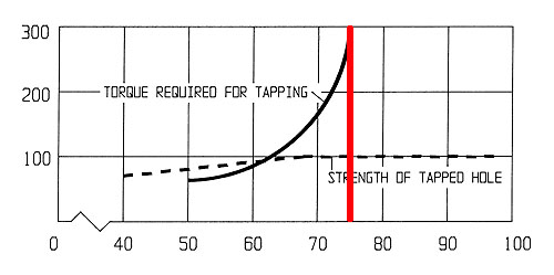

Thread Percentage vs Strength Chart
Let's take a closer look at the relationship between torque and thread strength based on thread percentage:
Machining data: Tap strength vs torque chart.
Red marks the typical 75% percent of thread drill recommendation.  Chart courtesy of Tapmatic.
Red marks the typical 75% percent of thread drill recommendation.  What stands out is the relationship between the torque required to tap (solid black line) and the strength of the tapped hole (dashed line).  When We accept the 75% percent of thread the average drill chart hands us, we're subjecting our poor taps to a huge amount of additional torque for very little extra strength!
Is it any wonder the darn taps give up and break on us after that kind of abuse?

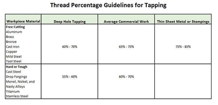

General Guidelines for Choosing Thread Percentage
Try this approach, which is based on material and type of work:
Machining thread percentage guidelines with workpiece materials listed on the left.
The material matters because we can afford higher thread engagement in softer materials and we actually need it to increase thread strength.  For hard or tough materials, a lower percentage can really help tap life and those materials have lots of strength even at the lower percentages.  In deeper holes, we run the most risk of breaking a tap and in sheet metal we need the strongest threads because there is much thread depth for holding power.

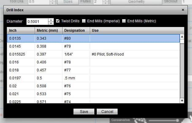

Hey, What About that Free Drill Bit Size Chart?
Here you go, Metric and Imperial sizes are called out in the "Use" column in the chart below.  It's even an NPT Tap Drill Chart:
