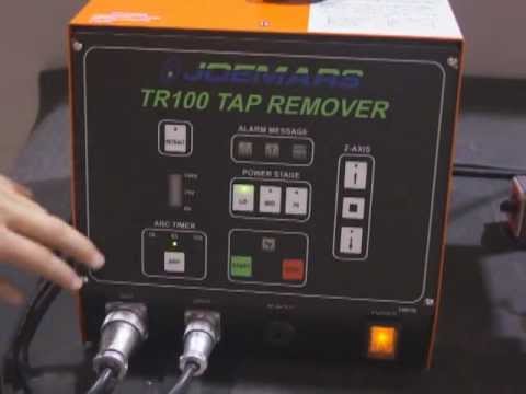

As soon as I saw this video I thought, “What a cool product.” It’s a portable EDM sinker that can be used to remove broken taps and drill bits. EDM (Electrical Discharge Machining) can literally disintegrate metal like Marvin the Martian’s Ray Gun. It’s a fascinating process, and there are parts that are impossible to make any other way.
This little gizmo applies EDM to the problem of removing a broken tap or drill bit from the workpiece. This is a problem we’ve all had at one time or another that generally leads to some strong language. If you’ve got a workpiece you’ve invested a lot of work in, it’s very expensive to start over. You need to remove the broken tap without damaging the workpiece, and this little machine from EDM Tech Center might be just the ticket.
Check it out:
There are no cutting forces to speak of for this application, so a compact Z-axis on a magnetic mount can do the job. The bulkiest part is the power supply and controller which is still about the size of a battery charger.
