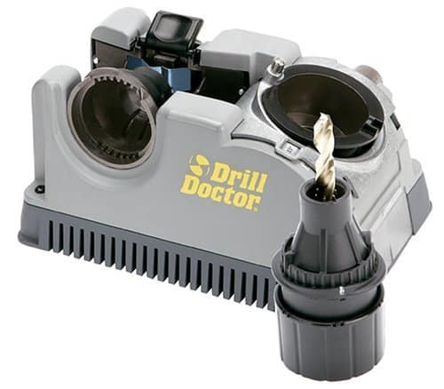

Recently I was working on a sheet metal project (assembling a full flood enclosure for my Tormach 1100 mill) and had to drill a bunch of holes.  Something about the sheet metal was being very ornery to my twist drills–they were severely dulling about every 3 holes.  For many, they’d either have to soldier on with a dull bit or jump in the car and head to the local hardware store.  Not so here–I pulled out my trusty Drill Doctor and sharpened the bits.  Once you get used to always having sharp bits, it becomes an outright need to have sharp bits on hand.  It’s so painful when they’re not.  The Drill Doctor makes short work of sharpening most twist drills.  I went for their higher-end version, the DD750X.  It’ll do split points, different angles, is super easy to use, and sells for just $129 as I write this.  Being able to sharpen my bits easily makes it so worth it!

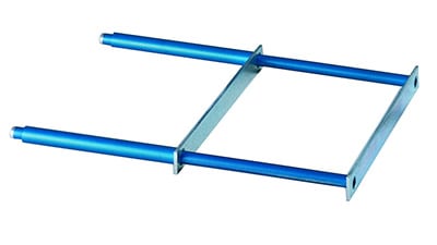

I use parallels in my milling vises all the time and I’ll bet you do too.  These Kurt Parallel Keepers are just the thing for keeping them in place when you are leaning into the enclosure and can’t reach your 3rd and 4th hands in to help:
ParallelKeeper
Kurt Parallel Keepers – $60 from Amazon
They’re spring-loaded and sit low on the parallels so they’re out of the way.
