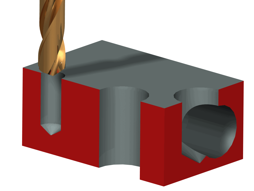

What are Blind Holes?
Gold-coloured drill bit in red cube.
Blind Holes don't go all the way through the material.  Image by By Robert Hewitt
Blind Holes don't go all the way through the material.  As a result, any chips made during drilling, reaming, tapping, or other operations can't just fall out the bottom.  They have to be evacuated by the helix of the cutting tool or some other means.
That makes Blind Hole Tapping tougher than through hole tapping, and therefore, it means you're more likely to break taps. This article will give you the tips you need to minimize tap breakage on blind holes.
