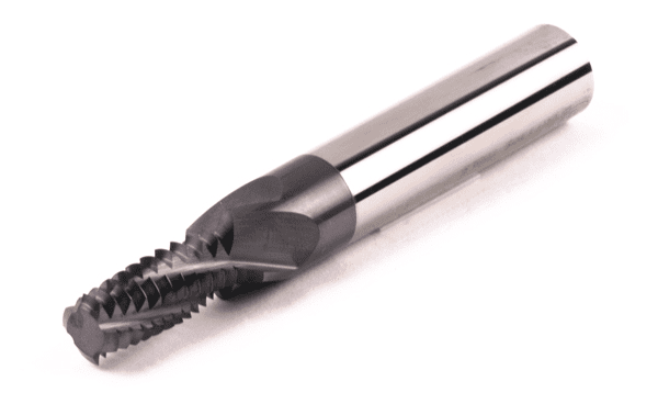

Technical Tips: Spiral Flute Thread Mill (also called “Multi-Point” or “Multi-Form” Thread mills)
A Spiral Flute Thread Mill can cut faster than Single Profile (or Single Point) Thread Mills because more than one thread can be cut by the multiple rows of teeth. The same Spiral Flute Thread Mill can cut lefthand or righthand threads and it can vary the diameter of the threads, but they are limited to a single thread pitch governed by the spacing of their teeth.
They’re called “Multi-Form” because they form many threads per pass. You may only need a single pass for all threads in the hole if the thread length is the same or less than on the thread mill. A Multi-form thread mill thus cuts faster than the Single Profile or Single Point thread mills we will look at next.

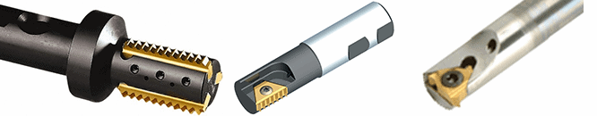

Solid Carbide vs Indexable Thread Mills: Technical Tips
As with most any other tool type, Threadmills are available as indexable tooling with replaceable inserts. A variety of types are available including Single Profile, Single Insert Spiral Flute, and Multiple Insert Spiral Flute.
The usual motivation for indexable tooling is cost–you can replace an insert rather than the entire tool. However, as is the case with most indexable tooling types, the geometry and therefore the performance of equivalent solid carbide tooling is superior. Therefore, an indexable threadmill is only preferred when doing large volumes of threading in relatively larger holes.

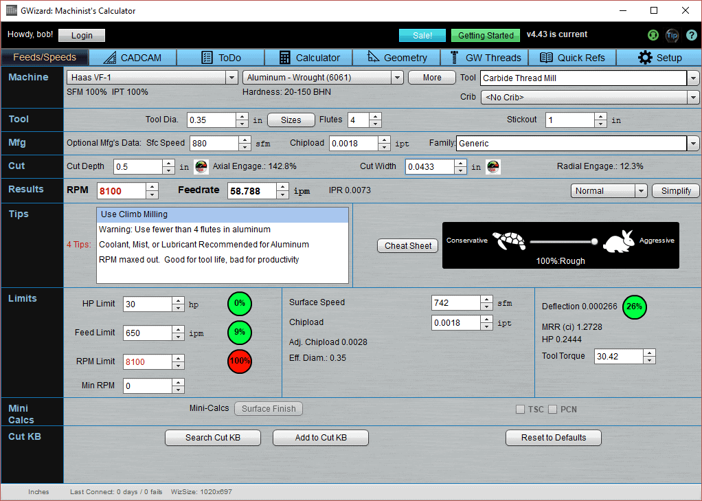

Like anything else having the right Feeds and Speeds is very important for Thread Milling. A Threadmill can be small, delicate, and expensive, so it’s no fun to break one. The good news is our G-Wizard Feeds and Speeds Calculator does Threadmill Feeds and Speeds!
Here’s how it works:
Step 1: Choose machine and material
Step 2: Choose a threadmill for tool type
Step 3: Enter Tool Diameter and Flutes

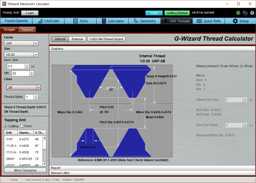

Let’s say we’re going to cut a 1/2-20 internal thread. Our rules for selecting a thread mill require no more than 70% of hole diameter for threadmill diameter. So we want a threadmill that is no more than 0.350″ in diameter. I like Lakeshore Carbide’s tooling (Carl is great to deal with), so I will go choose a threadmill from his online catalog.
I picked an uncoated threadmill and the specs say 0.350″ diameter, 4 flutes.
Step 4: Enter Cut Depth and Cut Width
I’m going to cut threads a 1/2″ deep in one pass, so I will set my Cut Depth to 0.500″. Cut Depth is the difference between major and minor diameter of a 1/2-20 thread. We can look that up on G-Wizard’s Thread Tab:
I’ll just use the Sharp-V height (0.0433″) because its easy. In practice, our cut depth is a little less to allow for the flats.
That’s about all it takes to get some Feeds and Speeds back from G-Wizard:
Note that as the tips say, we could be going a lot faster rpm-wise, but it’s okay to go slower. We’ll get better tool life too.
If we wanted to take it a little easier, we can dial back the Tortoise-Hare slider more to the Tortoise side–whatever feels right for the situation.
That’s all it takes. If you’ve never tried G-Wizard, get on board with our free trial:
