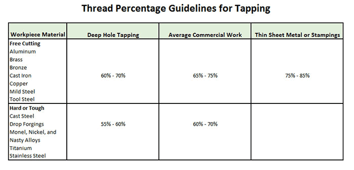

I just finished the 11th episode of CNC Chef for Cutting Tool Engineering. This video gives you 7 ways to avoid breaking taps:
7 ways to avoid breaking taps from Cutting Tool Engineering on Vimeo.

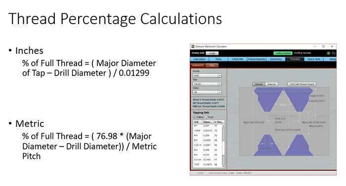

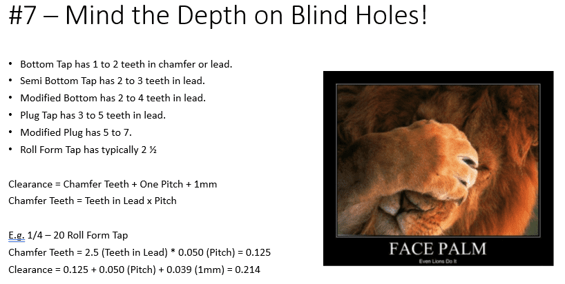

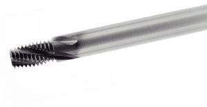

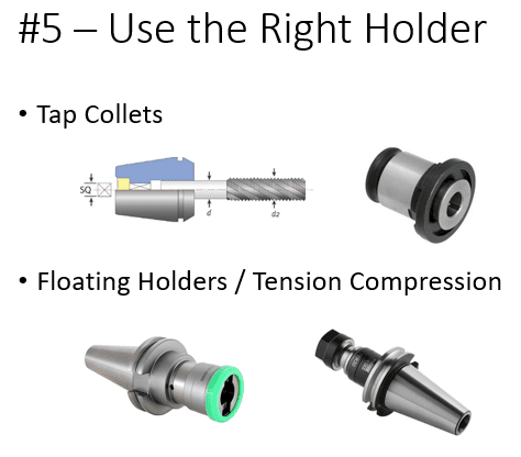

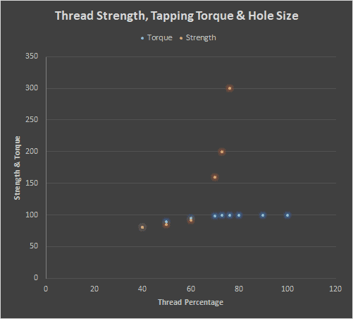

Watch the video for details, but my 7 ways include:
- Choose the best hole size
- Use Form Taps where possible
- Thread Mill critical and tough jobs
- Use purpose-made Tapping Lubricants
- Use the right tool holder
- Extract chips with a spiral fluted tap
- Mind the depth on blind holes
Taken together they provide a wealth of techniques that will make breaking taps far less likely in your shop.
