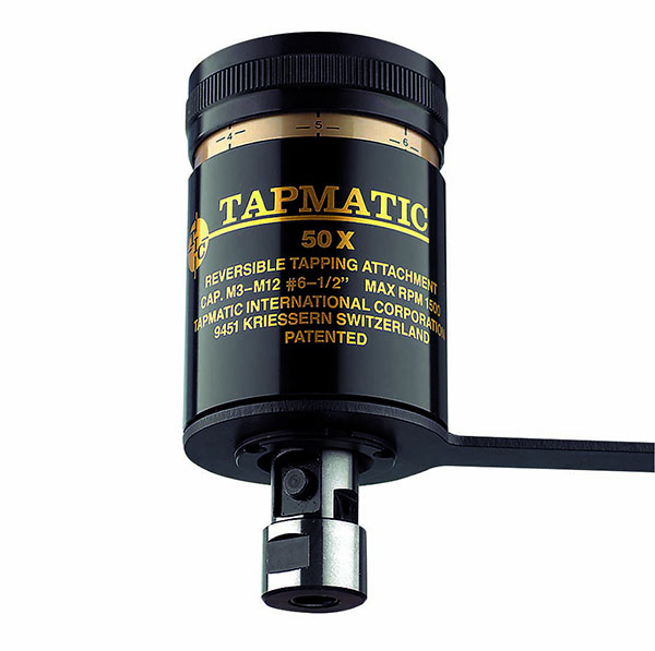

Auto-Reversing Tapping Heads
The next step up in complexity is to use a Tapping Heads. These heads are available from companies like Tapmatic, Procunier, and others. They include far more sophisticated mechanisms than Floating Tap Holders. Namely, they have an auto-reverse gearbox and a slip clutch. What that means is that as soon as the spindle starts to retract, the tapping head reverses direction automatically. Frequently the reversing gears operate at higher speed since it is possible to retract more quickly than one can cut threads. The slip clutch can be set to a torque rating based on tap size so you're less likely to break a tap through the application of too much torque.
Here is a typical Auto-Reversing Tapping Head:
Tapping Head from Tapmatic...
Tapping Heads incorporate friction slip clutches, axial free play, and a reversing feature that automatically reverses the spin direction when the feed direction reverses. They were originally created to make tapping easy for drill presses and manual milling machines. They can be used on CNC machines, but they're not nearly as common as Rigid Tapping or Tension/Compression Holders.

- Rigid Tapping is the fastest method, followed by a Tapping Head which is typically about 25% faster than a Tension Compression Holder. The reason is the Tapping Head can reverse much more quickly and can also typically be programmed to tap more quickly and retract more quickly as less safety margin is needed. There is an exception to this rule which is that a Tapping Head can be faster for very small taps depending on the acceleration/deceleration and rpm capabilities of your machine's spindle.
- For machines that don't do Rigid Tapping (which in itself is often an expensive option), Tension Compression Tap Holders are the cheapest answer for tapping. A Tapping Head is much more expensive.
- In most cases, a Tapping Head cannot be used with an Automatic Tool Changer. It needs a stop to keep it from rotating and often they're too bulky to fit into an ATC. There are exceptions, but obvious the loss of automatic tool change capability can be a real disadvantage for a Tapping Head.
