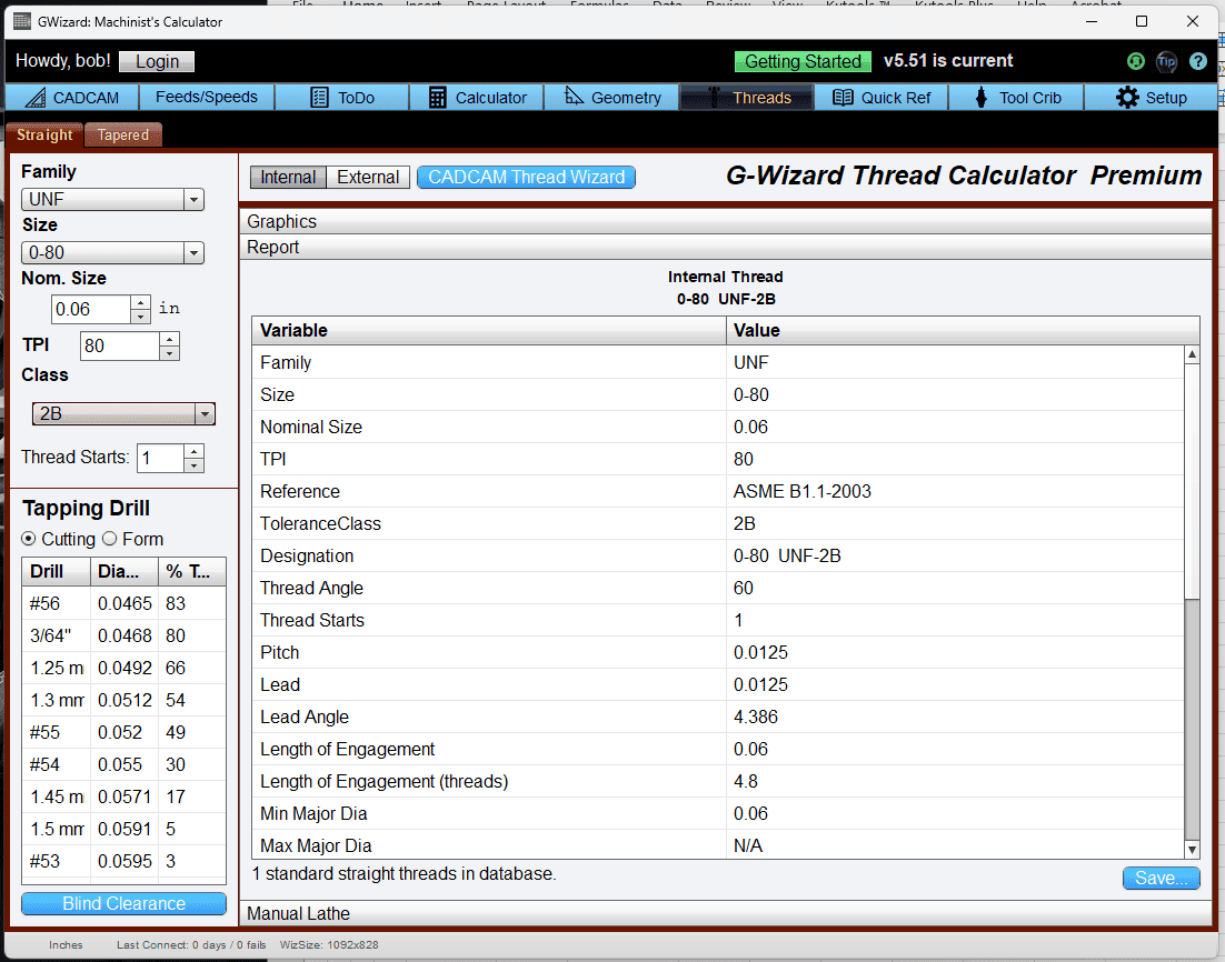

How do you calculate a bolt thread from scratch?
To calculate from scratch, you refer to the appropriate Thread Standard Document. These documents completely specify a thread and describe how to calculate every characteristic.
Our G-Wizard Thread Calculator gives you the appropriate standard for any thread it handles. For example, here’s a UNF 1/4-28 thread:
As you can see, the appropriate standard is ASME B1.1-2003. G-Wizard Thread Calculator uses the exact bolt thread formulas from that standard to calculate all of the values it shows.

Let’s take a closer look at one of the most popular and economical bolt thread calculators in the market: G-Wizard Thread Calculator.
There are two versions of the G-Wizard Thread Calculator. First, is a free version that offers calculations for UNC, UNF, and ISO (metric) threads. It’s extremely powerful for being a free calculator.
You can get your copy here:
The second is our premium G-Wizard Thread Calculator, which adds a host of additional thread families and more powerful features than its free cousin. Use the same button to acquire the Premium G-Wizard Thread Calculator.

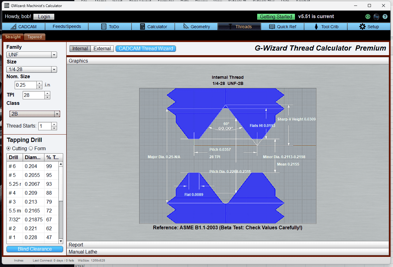

More Key features
Clearance Classes
Clearance classes determine the tolerances on threads.
Tapping Drill Charts w/ Thread %
Tapping Drill Charts let you evaluate the trade offs between available drill sizes and % Threads. This is a key factor to use in order to avoid breaking taps.
Measurement Over Wires
This is the goto method for measuring threads, and it sure makes it easy when there is a calculator available.

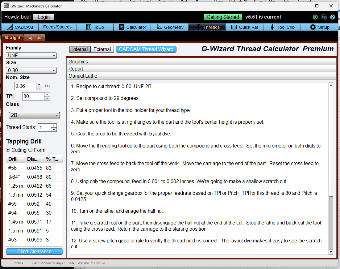

Manual Lathe Instructions
What could be easier than step-by-step directions on how to cut the thread on a manual lathe?
