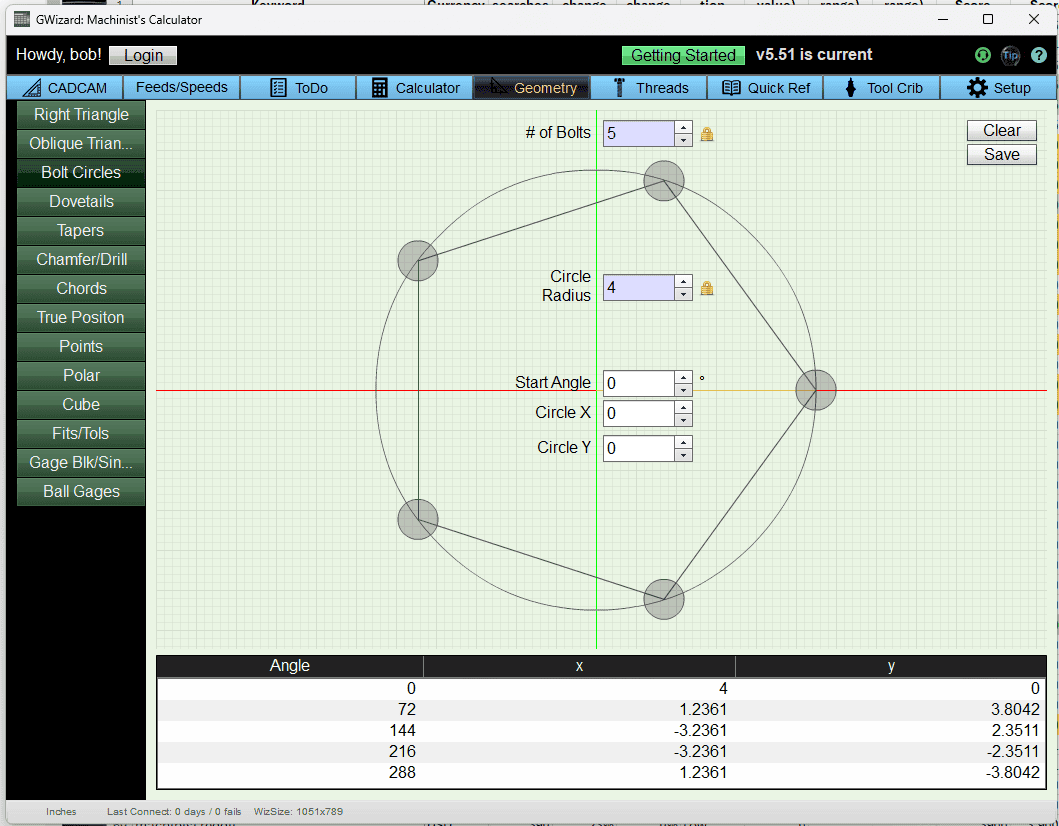

It’s pretty cool too. We’ve had a Bolt Circle Calculator for quite a while, and it does some way cool stuff:
- You can set the start angle of the first hole, number of holes, and circle center coordinates.
- From that, it’ll give you a scaled drawing of the bolt circle like this:
G-Wizard’s Free Bolt Circle Calculator…
Clicking the “Save” button is a new feature–it saves the coordinate table in csv format so you can load it into Excel. Using Excel string formulas it’s easy to convert that into gcode or whatever other format you might find handy. You could even just print it so you can take it over to your machine and dial in the bolt circle via DRO.

Doing a little reverse engineering and wondering how to find the diameter of an existing bolt circle? You can figure it out by using Chord Math:
BoltCircleDiameter = HoleCenterDistance / sin( 180 / NumberOfHoles )
You can see from the screen shot above that the hole to hole centers form a circle chord. We can set that calculation up in G-Wizard’s Chord Calculator something like this:
Figuring Bolt Circle Diameter from Hole Distance…
I entered a distance between hole centers of 2″ at the top. For the Angle, I used a trick. I typed “360/8″ and hit <Enter>. G-Wizard can do math in the fields and popped back with 45 degrees. That’s all I needed to discover the radius was 2.6131”, so the diameter is twice that.
