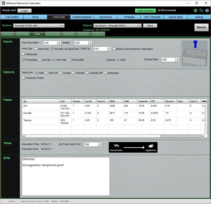

Here's the CADCAM Hole Wizard:
For most things, you need only tell it the values in the "Inputs" row and the Wizard will do the rest.
Holes are some of the most complex single features we create with CNC. Note all the options for what you can do to holes:
- Diameter and Depth: Of course, these are the most basic things.
- Hope Ops: There's a whole raft of addition ops you can add to a basic hole.
- Spot Drill: Spot Drill the hole before drilling
- chamfer: Use the Spot Drill to chamfer the hole at the end
- Ream: Ream after drilling. The CADCAM Wizard assumes the hole diameter is the reamer diameter and tells you what size Twist Drill to start with in the recipe.
- Interpolate: If you wish to interpolate the hole with an endmill, check this option.
- Threading: To thread the hole, turn this option on and then choose whether you want to use a cut tap, form tap, or thread mill.
With that information, the CADCAM Wizard will give you a complete recipe in the Feeds box. Here's a typical example of a hole for a 1/4-20 fastener that we wanted to spot and chamfer and then tap in aluminum with a form tap:
I just entered the inputs and clicked "Recalc" to get this result. I'm now ready to pass the information along to my CAM software and move on to the next feature.
