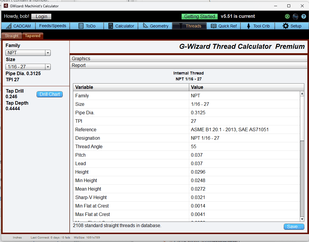

NPT, short for National Pipe Taper, is the standard tapered pipe thread used in the US and Canada. Pick a pipe size and this free NPT thread calculator gives you the threads per inch, tap drill, and the key thread dimensions from the ANSI/ASME B1.20.1 standard: enough to cut NPT threads by thread milling, single point threading, or tapping.
NPT Thread Calculator
Per ANSI/ASME B1.20.1: E0 = D − (0.05D + 1.1) × pitch; L2 = (0.80D + 6.8) × pitch; pitch diameters grow on a 1:16 taper on diameter (1°47′ half angle), so E1 = E0 + L1/16 and E2 = E0 + L2/16. Tap drills are the usual sizes for taper pipe taps without reaming.

What the NPT Thread Dimensions Mean
- Pipe OD (D): the outside diameter of the pipe. Note that the nominal size (1/2", 3/4"...) is not the actual diameter of anything.
- TPI: threads per inch. The pitch is 1 / TPI.
- E0: the pitch diameter of the thread at the small end of the pipe.
- E1: the pitch diameter at the hand-tight plane, where an external thread stops when you screw it into an internal thread by hand. It's also the pitch diameter at the opening of the internal thread.
- L1, hand-tight engagement: how far the parts thread together by hand, before you tighten them with a wrench.
- E2 and L2, effective thread length: L2 is the length of fully formed thread on the pipe, and E2 is the pitch diameter at that point.
- Taper: NPT threads taper 1 in 16 on diameter (3/4" per foot), which is a half angle of 1 degree 47 minutes. The pitch diameter grows by 1/16 of every length you move along the thread.
- Thread height: 0.8 x pitch, with a 60 degree thread angle and flattened crests and roots.
Tap Drills for NPT Threads
The tap drill sizes above are the usual sizes for taper pipe taps when you don't ream the hole first. If you ream the hole with a taper pipe reamer first, you can drill a little smaller. For tapping speeds, see our Tap Speed and Feed Calculator.
