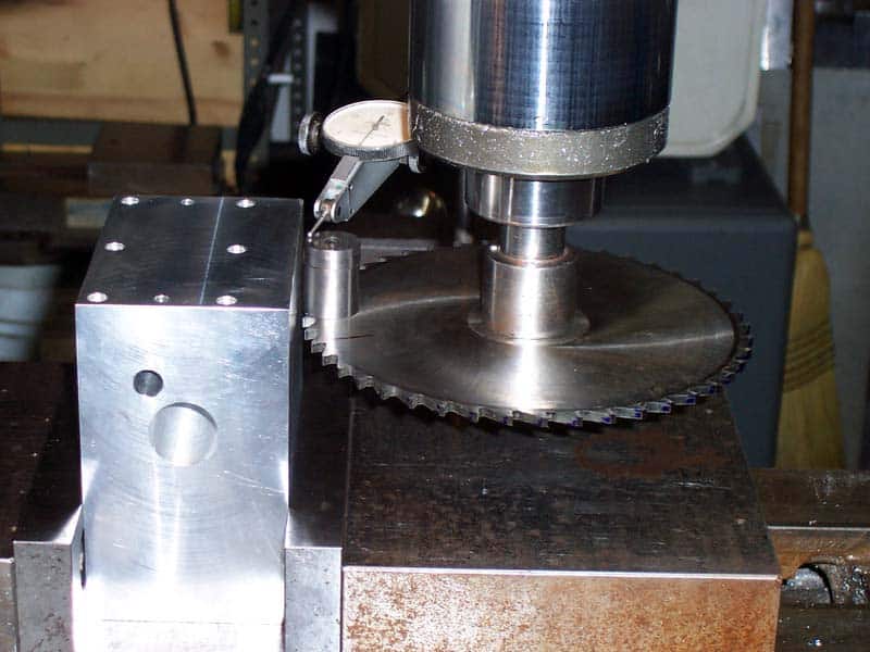

Indicating the Cut Properly
Indicating the slitting saw in with some space blocks so the middle of the saw cut is just where it needs to be relative to the top of workpiece. Widgetmaster (an old mentor of mine) suggests plunging the saw straight in rather than starting from the side when cutting because the hole will keep the saw centered instead of pulling it off axis.

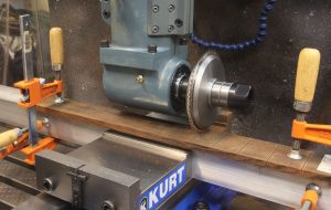

Right Angle Heads and Slitting Saws for Lathes
Right angle head slitting saw setup from Frets.com. Lots good to say about this. Love the big stabilizer collars that expose as little of the blade as possible to increase rigidity.
They’re custom made for the job. Click through to the Frets site for all kinds of great tips, tricks, and tooling…
It’s often convenient to re-orient the slitting saw using a right-angle head on a mill or placing the saw on its arbor into the lathe chuck and then clamping the workpiece where the lathe tool would normally go.  A rig like this can be pretty easily used to automate cutting bar stock to shorter lengths if you don’t have a lathe or automatic band saw for the task.
