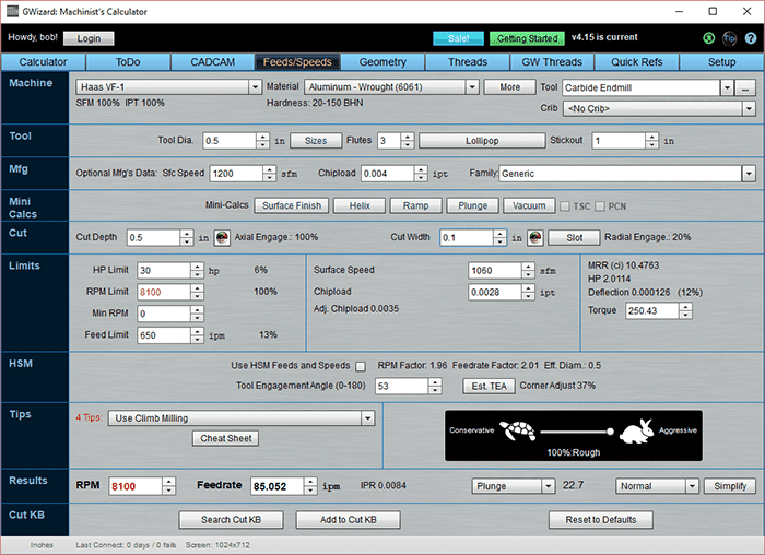

G-Wizard Calculator makes it easy to get Feeds and Speeds for Lollipop Cutters.  First, realize that Lollipops are a special tip type for End Mills.  So, proceed as if selecting an End Mill:
Machining process calculator screenshot with input fields, dropdown menus, and buttons.
The screen shot has us set up to cut 6061 Aluminum with a 1/2" 3 flute carbide end mill.  Click the "Geometry" button and switch to a Lollipop.  While you're at it, enter the Lollipop's dimensions, and be sure you get the shank diameter in there:
Machining tool menu screenshot showing Endmill, Drills, Mills, and other options.

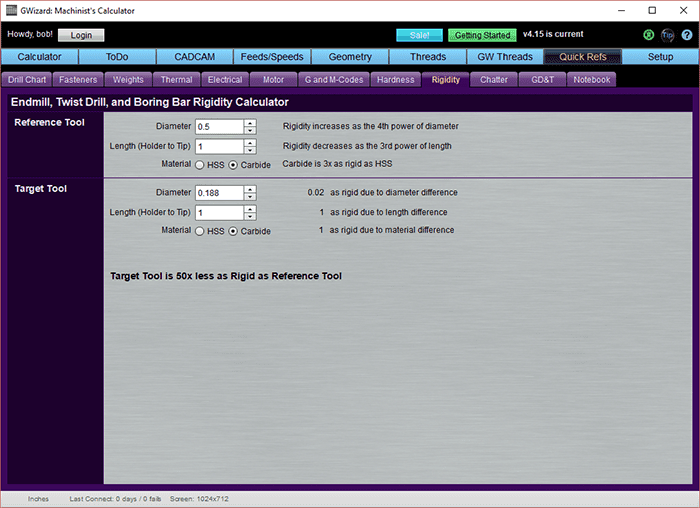

This Harvey Tool Undercutting End Mill is a 1/2" diameter, but the shank is only 3/16".  As soon as we hit "OK" on that geometry window, we can see there are Tool Deflection issues.  Let's refer to G-Wizard's Rigidity Calculator to understand what's going on:
Calculator tool for determining endmill diameter by material type.
All other things being equal, a 3/16" shank is 50x LESS rigid than a 1/2" shank.  50 times has a HUGE impact on tool deflection, and that's why if you're going to use Lollipop cutters, you want to make sure you're using G-Wizard Calculator or something similar with support for these cutters.
Instead of a Cut Width (Stepover) of 0.5", which is a full slot, if we click on the "Cut Width" title, G-Wizard will tell us the maximum Cut Width we can run without a Tool Deflection warning.  It turns out we need to dial back to 0.066".
Lollipop cutters are best used gently and under watchful eyes lest deflection severely limit their Tool Life.
