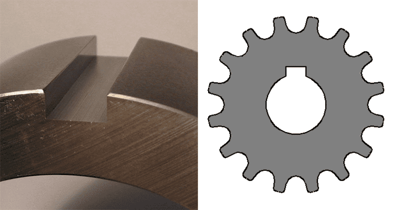

Whenever we need to affix a part to a shaft, such as a gear or pulley, keyways, keys, and keyseat work or woodruff work comes into play. So, let’s begin by getting our terminology straight.
A Keyway is a slot of some kind that is used to align the part on a shaft and prevent the part slipping as the shaft rotates. A Key goes into the Keyway to lock things up. Another name for a Keyway is a Keyseat, since the Key is seated in the Keyseat. When a specialized cutter is used to cut the Keyseat, it’s a Keyseat Cutter. A Woodruff Cutter is a Keyseat Cutter.
There are several kinds of Keys in common use.
Parallel Keyways & Keys
Parallel keys are the simplest, and involve a slot that goes all the way through at least the part with the shortest axial mating length (i.e. the gear or the pulley. Cutting a parallel key is straightforward–just use an endmill and treat it as cutting any other slot. Alternatively, you could use a Keyseat Cutter such as a Woodruff Cutter.

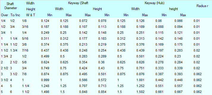

Parallel Inch Key Sizes
Shaft Diameter | Width | Keyway (Shaft | Keyway (Hub) | Radius r | |||||||
Height | Width | Height | Width | height | |||||||
Over | To/Inc | W & T | Min | Max | Max | Min | Min | Max | Min | Max | |
1/4 | 1/2 | 1/8 | 0.124 | 0.125 | 0.072 | 0.078 | 0.125 | 0.126 | 0.06 | 0.066 | 0.01 |

Per BS 46 Part 1 : 1958 Keys and keyways and taper pins. Specification. Keys and keyways.

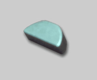

Woodruff Keyways & Keys
Woodruff Keys are an alternative to Parallel Keys. They are semi-circular, and fit into a Keyway shaped as a circular-segment in the shaft and a rectangular slot in the mating part. The semi-circular slot is cut by plunging a Woodruff Cutter (the correct Keyseat Cutter for this style Keyway) into the workpiece.

Woodruff keys may be full radius or flat bottom, but the keyseat will always be radiused by the Keyseat Cutter / Woodruff Cutter. A flat bottom Woodruff Key has part of the radius shaved right at the bottom:

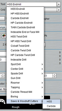

Our G-Wizard Feeds and Speeds Calculator has special support for Woodruff Cutters & Keyseat Cutters. To set up the Woodruff Cutter cut in the Calculator, we go left to right, top to bottom:
1. Select the Machine
2. Select the Material
3. Select the Woodruff Cutter from the tool menu (Note: Keyseat cutters are referred to as Woodruff cutters for feeds and speeds):
4. Select what material the tool is made from, either HSS or Solid Carbide, and what coating it has (if any). A good coating can provide some added lubricity to make the material cut more easily.
