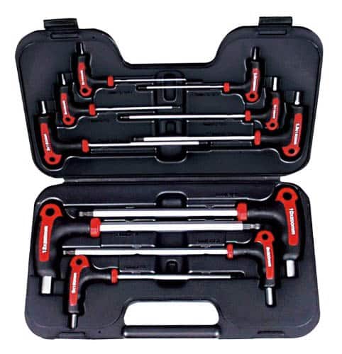

Ampro SAE 10-Piece and Metric 10-Piece Set
Metric Set | SAE Set | Metric + SAE | Torx Set | |
Sizes | 10 Pcs: 2 mm – 10 mm | 10 Pcs: 5/64″ – 1/2″ | 10 Pieces | |
Through Key | yes | yes | yes | |
Ball End | yes | yes | ||
Reviews | 2 | 3 | 5 | 3 |
Stars | 5 | 5 | 5 | 5 |
$/Star | $29.17/Star | |||
Price | $72.92 | $72.92 | $145.84 | $66.91 |
Amazon Price | $72.92 | $72.92 | $145.84 | $66.91 |
Discount | 0% | 0% | 0% | 0% |
Amazon Link | Ampro 10 Pc Metric Set | Ampro 10 Pc SAE Set | Ampro 10 Pc Torx Set |
Nice ergonomic handles–I like the offset style better than the centered style. Just seems like I can get a little more torque on them, plus they seem like they work better when you’re using the Through-Handle side key.
I like the flat cases too. They keep the tools secure, they’re easy to carry around the shop to where they’re needed, and they fit in a tool cabinet drawer. You can’t say as much for most of the stamped-metal organizers.
The attention to detail on storage and the high price with no discount available are the tip-offs that Ampro tools are largely intended for industrial customers rather than individuals. They’re nice tools, but you will pay for the privilege of owning them.

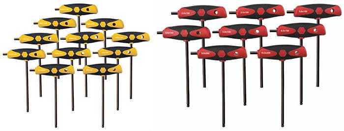

Wiha SAE 11-Piece and Metric 8-Piece Set
Sizes | 8 Pcs: 2 mm – 10 mm | 11 Pcs: 5/64″ – 3/8″ | 7 Pcs | |
Reviews | 5 | 4 | 9 | 4 |
Stars | 3 | 5 | 5 | 4.8 |
$/Star | $20.10/Star | |||
Price | $54.30 | $66.62 | $119.92 | $61.60 |
Amazon Price | $46.98 | $53.54 | $100.52 | $54.98 |
Discount | 16% | 23% | 19% | 12% |
Amazon Link | Wiha 8 Piece Metric Set | Wiha 11 Piece SAE Set | Wiha 7 Piece Torx Set |
These German-made T-Handles are not cheap, but they did get a perfect score of 5 stars. For the full Metric + SAE lineup, you’ll be paying a cool hundred bucks at the current Amazon discount rate. For comparison, the El Cheapo Harbor Freight version is $27 for both sets. Of course, if you’re using these babies to tune up your vintage Porsche racing car, cost is no object and its worth something not to touch your baby with anything but authentic German-made tools.
On the other hand, if we look at them using our value score, things look a little less crazy as they score $20.10 / Star–not the most expensive for their quality and certainly not the least either. On the other hand, there are very few reviews there to go on–looks like only the die-hard Wiha fans are buying these things.
They are good-looking tools, with a comfortable soft grip handle and both the long reach ball end and the handle through key. I’ve got a small set of Wiha Torx drivers for changing inserts (hate losing those tiny screws!), and they’re very nicely made. Sizes are clearly marked and the handles are color-coded by system too.
My biggest bone to pick is you don’t even get an organizer stand with them for this price–to get the set with the stand costs even more. My #2 issue is with sizes. The World’s Best should have more sizes than any others, but the set doesn’t include a 1/2″ size, although we do get a 7/64 and a 9/64 size, which are not in many of the other sets. On the metric side, Wiha doesn’t provide a 5.5 mm or a 12 mm.

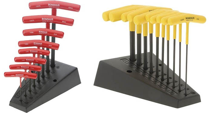

Bondhus SAE 10-Piece and Metric 8-Piece Set
Sizes | 8 Pcs: 2 mm – 10 mm | 10 Pcs: 3/32″ – 3/8″ | 8 Pcs | |
Through Key | no | no | no | |
Ball End | no | no | ||
Reviews | 156 | 178 | 334 | 88 |
Stars | 4.9 | 4.8 | 4.85 | 4.8 |
$/Star | $12.50/Star | |||
Price | $33.50 | $52.42 | $85.92 | $26.88 |
Amazon Price | $33.50 | $27.11 | $60.61 | $26.88 |
Discount | 0% | 48% | 29% | 0% |
Amazon Link | Bondhus 8 Pc Metric Set | Bondhus 10 Pc SAE Set | Bondhus 8 Pc Torx Set |
First thing I want to say about these Bondhus tools is they’re made in the good old U, S, of A–Yay! I like that a lot.
Second thing is that whether you’re looking at Amazon or at reviews all over the Internet, the Bondhus T-Handles are probably the most popular high quality T-Handles on the market. That doesn’t mean they’re the best ones for you, but it means a whole lot of people thought they were best for them.
Their warranty is just what we love to see:
All Bondhus® products are guaranteed for life. If you are not happy with a Bondhus® tool – for any reason – simply return it. A replacement will be shipped right out at no cost – no hassles, no questions asked!
Good stuff!
And the $/Star scores make these guys look like a good value.
So, what’s not to like?
Well this set has no Through Key and no Ball Ends. To get the Through Key, you need to buy a set OEM’d by Bondhus to Park Tools (they cater to bicycle mechanics). We go over the Ball End version below–it’s more money and not as well-loved by the reviewers. Go figure. My conclusion after seeing what the reviewers disliked was that if I wanted the Bondhus T-Handles, I’d pay the little extra for the Ball End models.

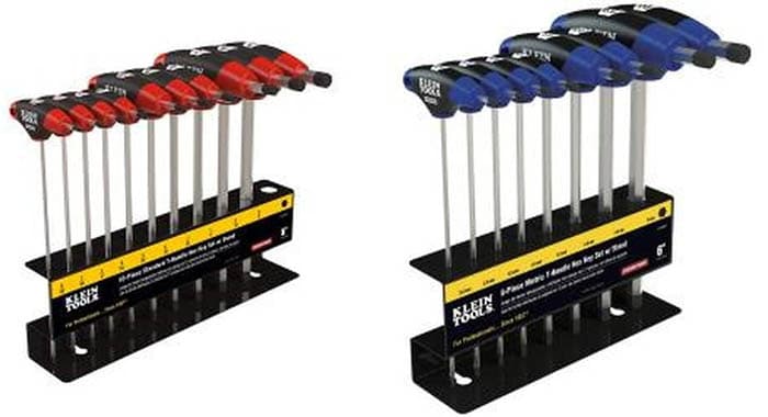

Klein SAE 10-Piece and Metric 8-Piece Set
Sizes | 8 Pcs: 2 mm – 10 mm | 10 Pcs: 3/32″ – 3/8″ | 7 Pcs | |
Through Key | yes | yes | no | |
Reviews | 23 | 19 | 42 | 88 |
Stars | 4.7 | 4.4 | 4.55 | 4.8 |
$/Star | $9.11 | $12.08 | $21.09 | $10.87 |
Price | $52.08 | $53.14 | $105.22 | $71.24 |
Amazon Price | $42.83 | $53.14 | $95.97 | $52.18 |
Discount | 22% | 0% | 9% | 37% |
Amazon Link | Klein 8 Pc Metric T-handle Set | Klein 10 Pc SAE T-Handle Set | Klein 7 Pc Torx T-Handle Set |
This is a good-looking set to my eye: ergonomic grips and through keys on the handles. While they have a through key, they are, like the Bondhus, not ball-end. You can pay more for the ball-ends, but I don’t review them here because there were no reviews at all on Amazon of them. It’ll cost you another roughly $20-$30 to have that upgrade.
They’re also one size short compared to most of the other Torx sets reviewed here.
Klein has a great name and did well in our World’s Best Screwdriver round up, but the high prices and somewhat lower star ratings make me think they’re not the best choice for a T-Handle. You can get the German-made Wiha’s for not that much more and they’re much more highly rated.
Problems mentioned by reviewers:
- Ends twisted round too easily on small sizes.
- Accidentally got a mixed set with a few ball ends.
- Tools rusted too easily.
Bondhus SAE 10-Piece and Metric 8-Piece Ball End Sets
Reviews | 86 | 84 | 334 | 88 |
Stars | 4.4 | 4.6 | 4.5 | 4.8 |
$/Star | $7.92 | $8.12 | $16.05/Star | $5.60 |
Price | $34.85 | $37.36 | $72.21 | $26.88 |
Amazon Price | $34.85 | $37.36 | $72.21 | $26.88 |
Discount | 0% | 0% | 29% | 0% |
Amazon Link | Bondhus 8 Pc Ball End Metric Set | Bondhus 10 Pc Ball End SAE Set | Bondhus 8 Pc Torx Set |
See the section above for regular Bundus hex keys–these are the same except they have Ball Ends, cost more, and are not as well reviewed by users. They don’t cost a lot more, about $12.
What the folks driving down the star ratings had to say was that the smaller 3 sizes were not ball ends, which annoyed them. This is actually pretty common for hex keys though, so I tend to want to ignore them. If I wanted a Bondjus set, this is the one I’d go for in order to get the Ball Ends.
